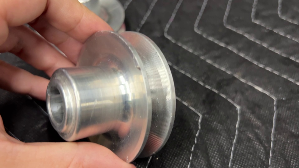

- The pulley geometry or belt tension isn’t allowing the belts to slip enough. When we were still back home we realized the belt tension was too tight and we sent the pulleys out to get remachined. Maybe they’re STILL too tight?
Both of these are difficult to prove AND difficult to remedy in the pits between matches. If this continues to be a recurring issue, it could cost us our whole season. But Mike takes another look at the pulleys and notices something interesting. When they were re-machined, it looks like they were milled instead of turned. This resulted in a different finish than we’re used to, with distinct tiny steps. What if that surface texture is destroying the belts at such a high speed? Before taking more drastic action, we sanded down the pulleys to make sure the surface is nice and smooth. We’ll try out our theory in our next battle versus Gruff. What better test than one of the most rugged bots in the sport? Watch BattleBots tomorrow night (Thursday 3/2) to see if we lose any belts!
