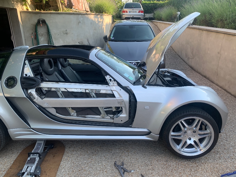

To access the mechanism, the outer plastic panel needs to be removed. 🙄

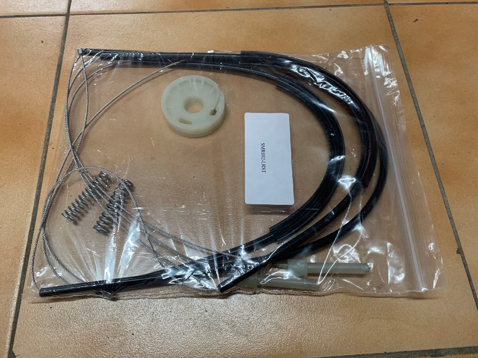

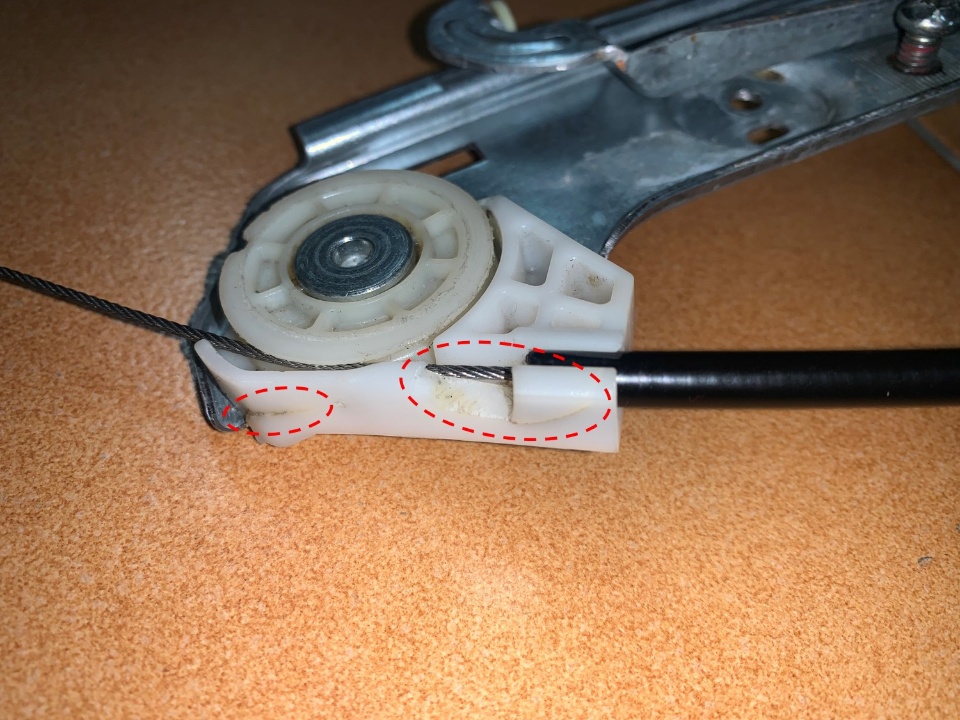

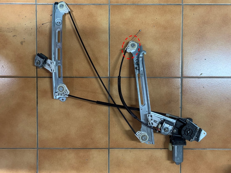

The motor pulley and cables were damaged because of the pulley support broke at the cable steath. These spare parts are available but NOT the metal sliders with plastic pulley supports.
Broken part:

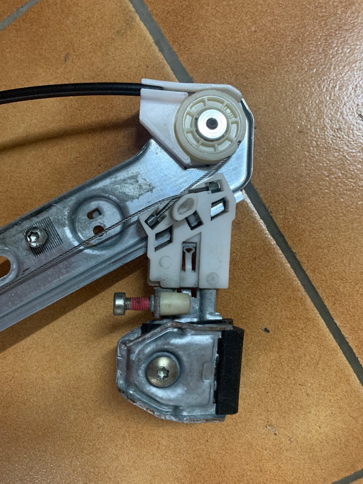

3DPrinted part:

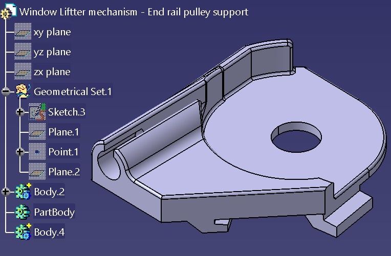

Designed with CV5:
