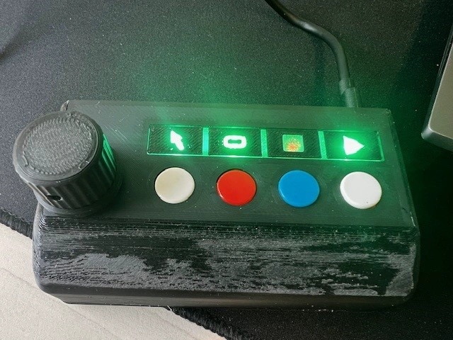

Hi Makers,
I am please to share with you my latest project... a "console" to simplify my life when I need to create and edit a video. Actually I configured all the buttons for the software Davinci Resolve, as the Arduino Pro micro (Arduino Leonardo is mandatory ) is emulated a Keyboard, you can adapt yours for any software or needs...
4 buttons for:
Select
Cut
STOP
Play
BOM

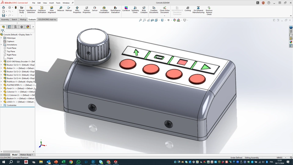

3D Files
All the 3D SOLIDWORKS (2025x) projet is available here, feel free to enhance it!
