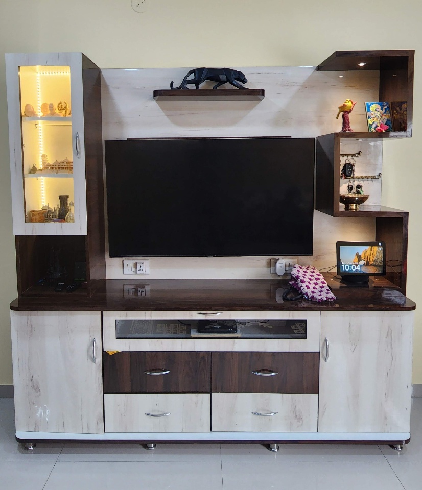

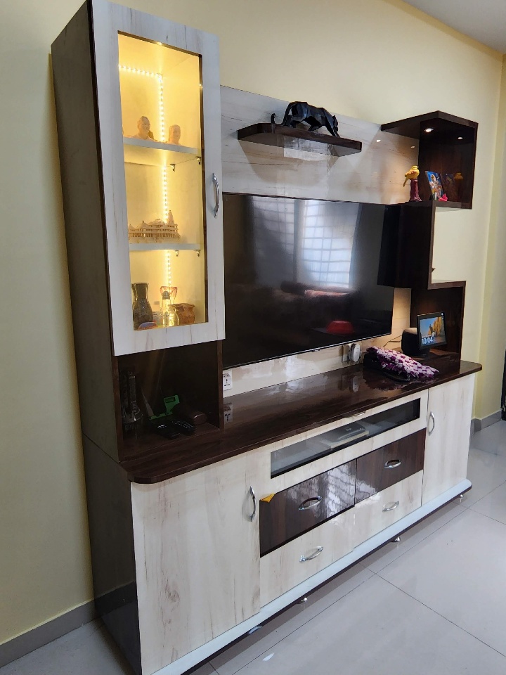

We wanted to switch to Standalone TV Unit from Wall mounted open TV Unit we had earlier.
As a family, we collaborated on design for the same.
Following were the requirements.
1) We have 55" TV so that has to be centered correctly.
2) All the wiring has to be hidden plus remote friendly compartment for TV set Top Box
3) I wanted dedicated space for 'Alexa show' device.
4) Glass door Showcase to keep my 3D Printed Parts.
5) My dad said just keep some space for 'Hanuman ji' (Indian God who is protector of the house) at the top
6) My wife and Mother both had only one requirement.. More storage.. :D
(Sometimes they do forget that space can neither be created nor be destroyed)
7) Open compartment to keep all the keys.

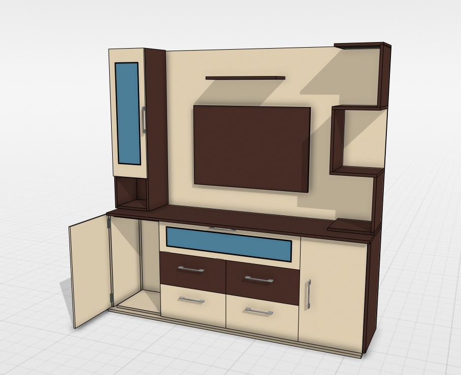

With all this data I created few variations using makebyMe
and finalized this one with majority vote (I get Veto anyway)

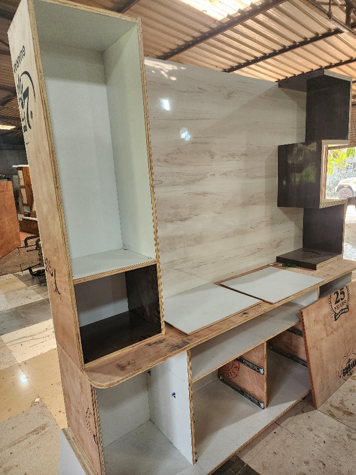

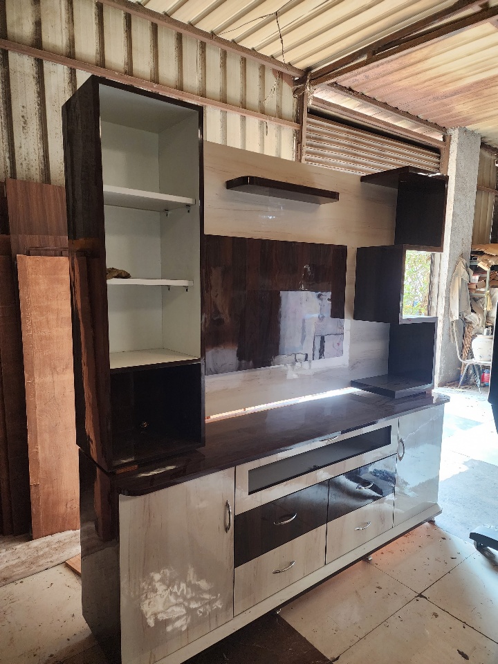

In India, getting custom furniture manufactured from carpenter workshops is much cheaper and practical
so I approached one and gave him my designs.
He was very amazed with that and said 'you made my job very easy, you are first customer with such clear idea about your requirements.'
I made him login on homebyme and gave him little makebyme demo.
He delivered it within a week
