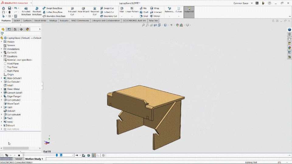

We used SOLIDWORKS for Makers to layout the initial design requirements...
...and then SOLIDWORKS Sheet Metal functionality to design the origami-like elements.

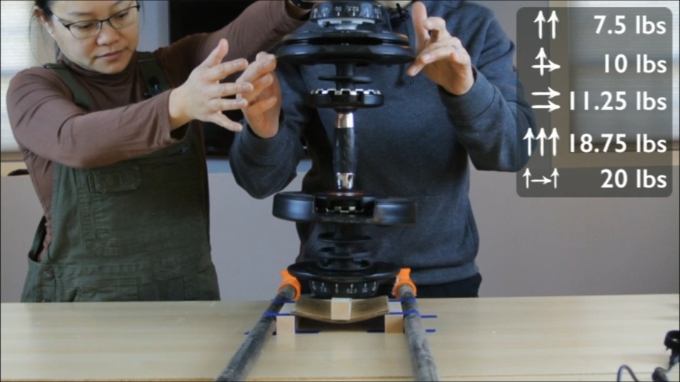

We used simple Elmer's glue to laminate together scraps of corrugated cardboard from old boxes to create large 3-ply sheets. We even did some strength tests to learn more about this remarkable material!

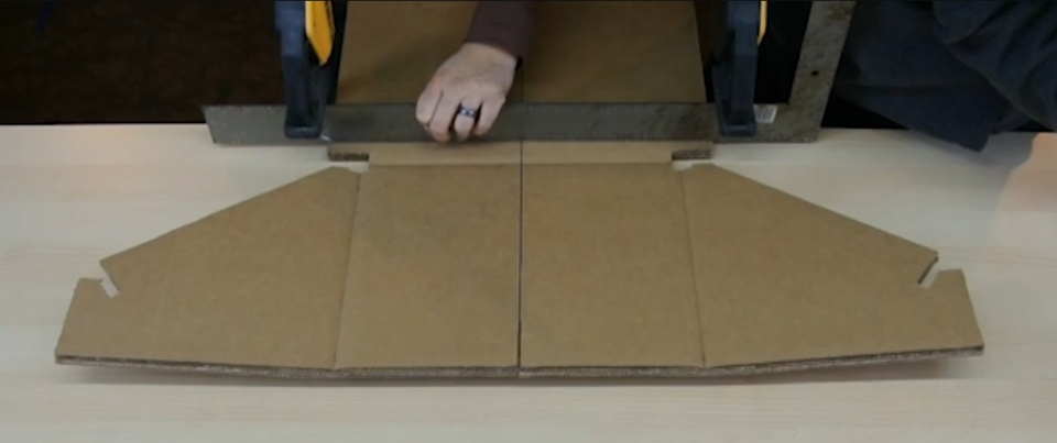

We used a sharp utility knife to cut out our designs, and then a metal straight edge and a few clamps to create the bends. Man, this stuff is tough! 3 layers of corrugated came to about a half an inch, and bending it, especially across the corrugation, was no small feat!

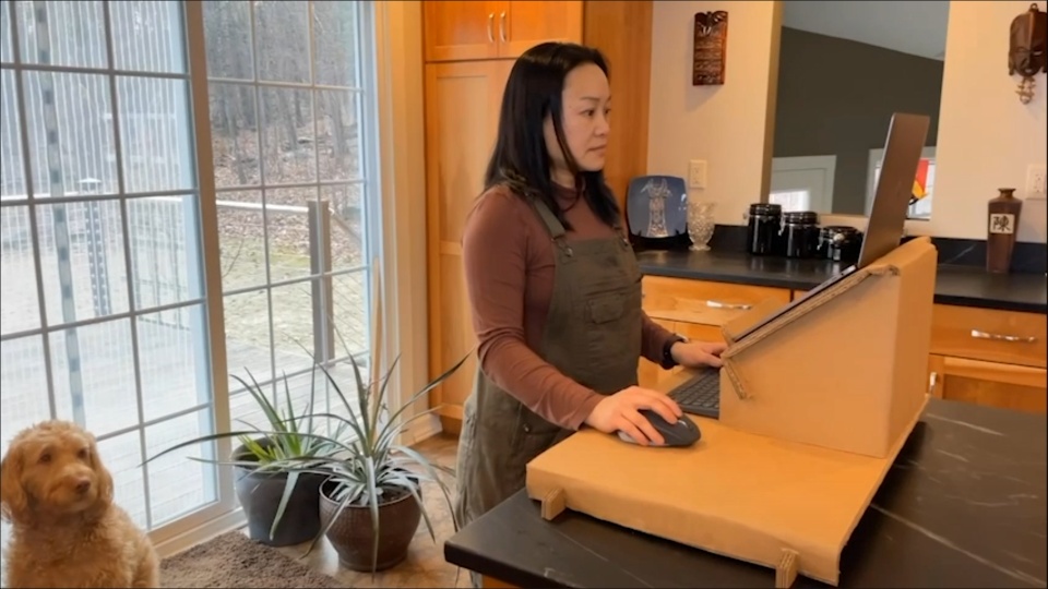

When everything was finished, we put the product to the test ...and everyone approved!

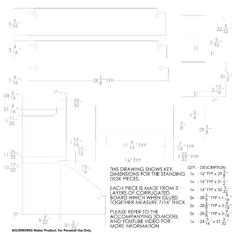

Here's a dimensioned drawing to give you a sense of how much corrugated board you'll need:
Download the 3D models (SOLIDWORKS and STEP formats) as well as a PDF with key dimensions to build a standing desk of your own!
