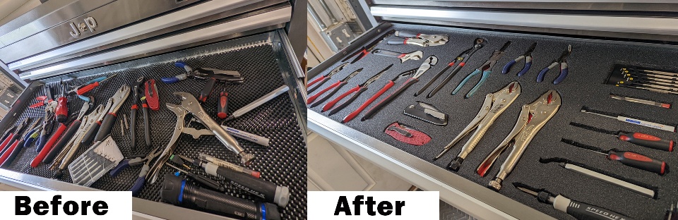

I finally gave it a shot. DRAWER 1 down. Only 26 more drawers to GO!
Sometimes it is nice to take a step away from the glow of the computer screen and do something simple. Its great to solve a problem by slowing down and using basic hand tools, whenever I make something this way the end result is super rewarding. Now I will be able to quickly see if my kids "borrowed" any of my tools and keep a clean working environment.

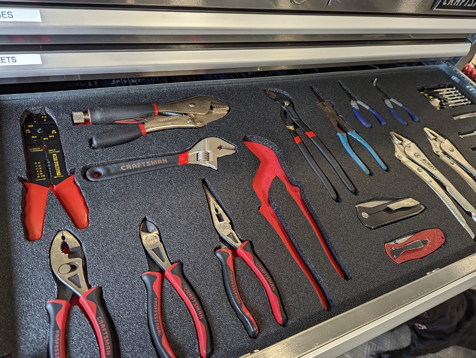

Step 2: I carefully organized all the tools to accommodate my work flow for this drawer.

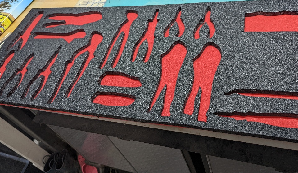

Step 3: I traced out all the tools using the Long Nose Marker Funny name but this marker made this whole job possible! It turns out that I really needed the long nose in order to stay tight on the part I was tracing, using this allowed for greater accuracy around the tools. The marker was also easy to remove once I was finished cutting.
Step 4: I cut away the tool silhouettes using my new Hot Knife This knife is amazing! I started this process with an old school razor knife, not the best choice. Then I got smart and ordered this electric hot knife. It cut right through the foam! I was like a Ninja with a hot knife slicing through butter. LOL
Step 5: I used the Kaizen Knife to cut away and remove the rest of the parts. This was extremely helpful when cutting tight corners. However, the strongest feature of this tool is the small hook on the back of the handle. I used this with ease to extract the foam parts.

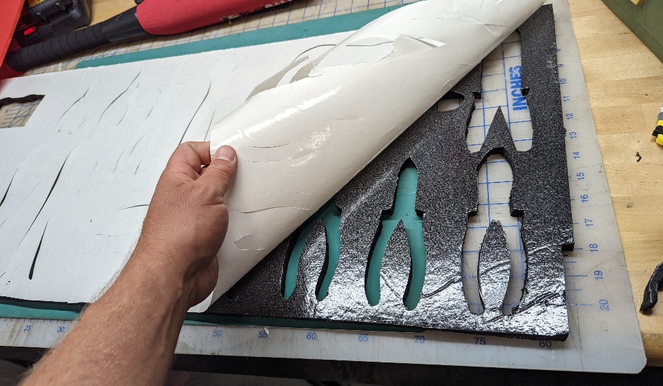

Step 6: I peeled off the backing material on the cut foam board and place it on top of the colored foam board.
Step 7: I installed the foam boards inside my drawer and loaded it up with my tools.
Step 8: I am now enjoying the peacefulness of an organized drawer!
