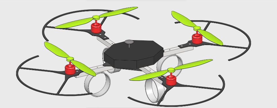

Our Team ‘STEALTH’ has designed this drone. Each components and Assembly of the drone is done using xDesign app.
Manufacturing details are mentioned below:
Parts details required for manufacturing:
1. Laser cut: (Quantity is mentioned in bracket)
1) Center 1 [1]
2) Center 2 [1]
3) Motor Support [4]
2. Arms: [4]
Square pipe of Aluminium (13mm X 13mm).
3. Cover:
Cover is provided for protection over electric parts.
4. Landing gears:
Made of plastic pipe. Attached to four arms of the drone.
5. Bolts & Nuts:
1) M3 Bolts: Length=20-25mm: Qty 25
M3 Nuts: Qty 25
2) Motor Screws: Qty 20
Note: No 3D printed parts used.
Team STEALTH - Phase 2 Design:
