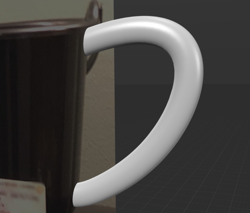

So a handle was required and I decided xDesign was the tool to model it up.

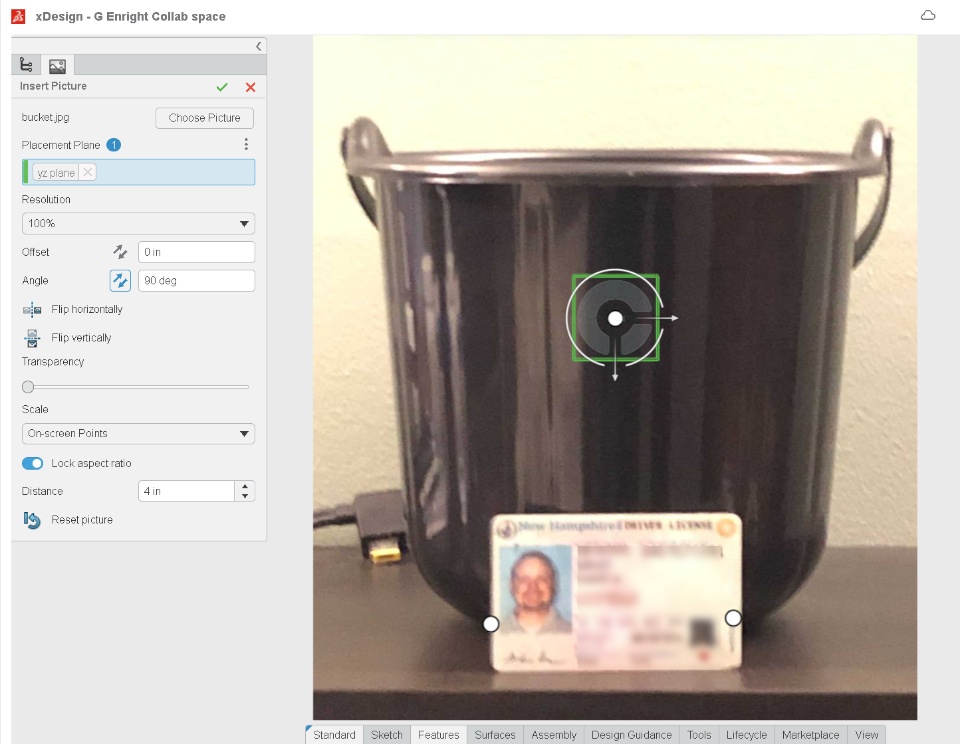

I took a picture with my cell phone and used my drivers license for scale. The On-screen Points option makes it easy to scale the photo.
Modeling the bucket would have been easy, but NOT modelling the bucket was even easier. I just used the 2D image as a guide and modeled the handle with a 2D Spline and simple sweep.

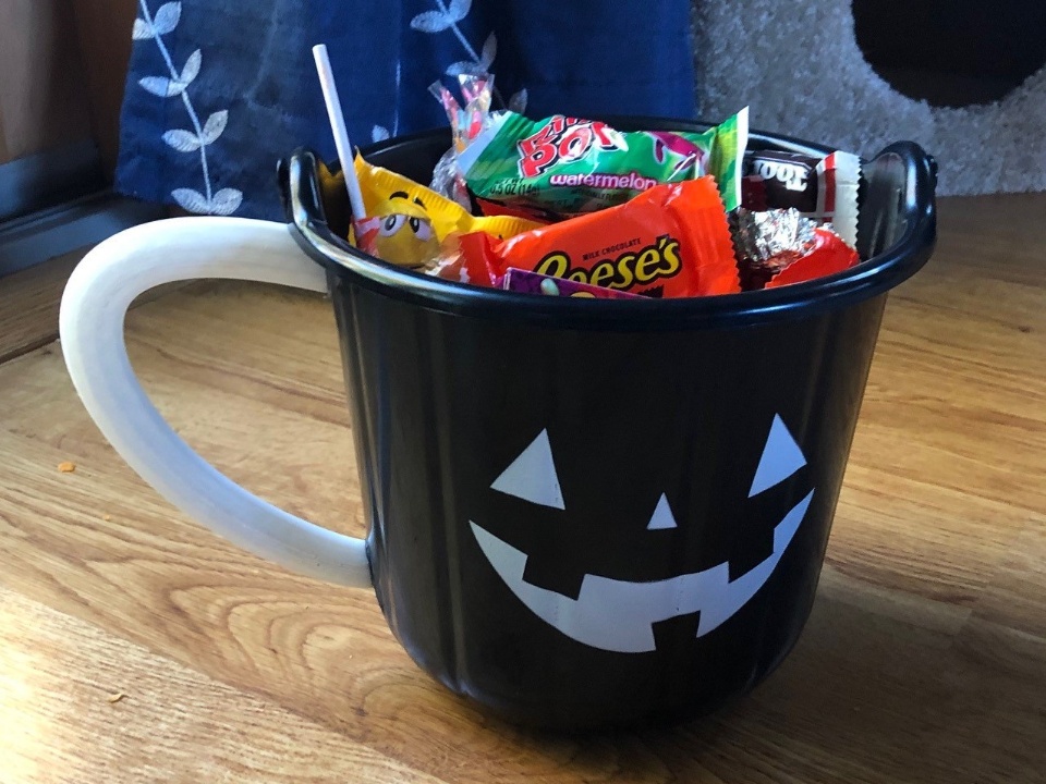

From there it was off to my 3D printer and two hours later I had a handle. I used this Silicone Adhesive to attach it to the bucket. Its super sticky, and works great for attaching things to smooth plastic.
