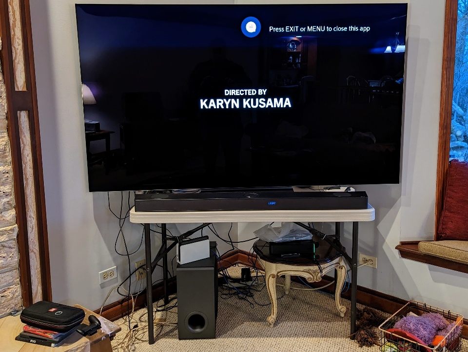

The initial state - very elegant

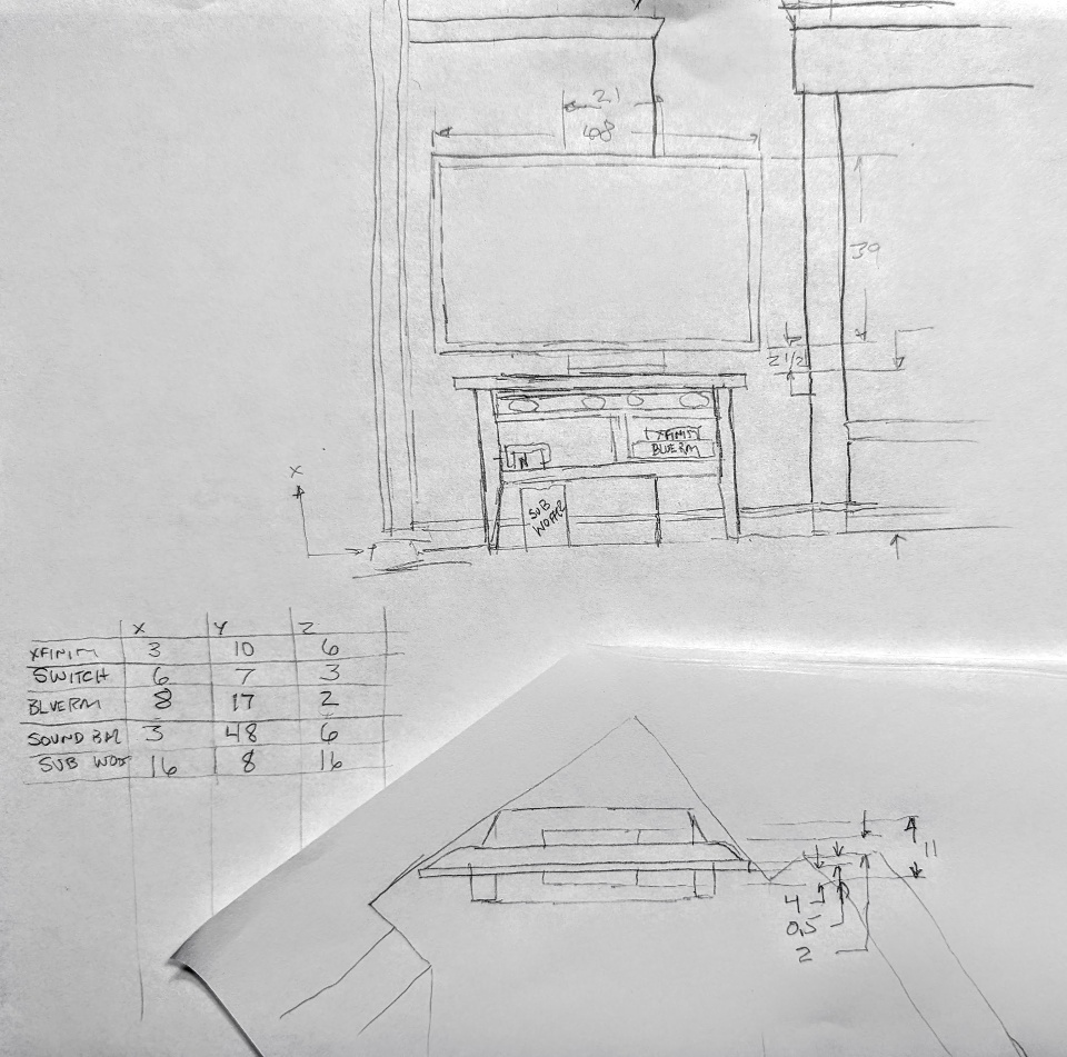

It starts with a sketch. This is how I captured the concept and the rough dimensions. Old school but effective.

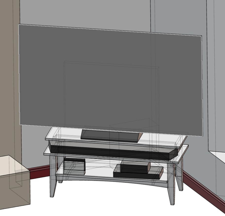

I built a rough model of the room to see how it would fit in space. Getting the proportions right is critical to getting the look right.

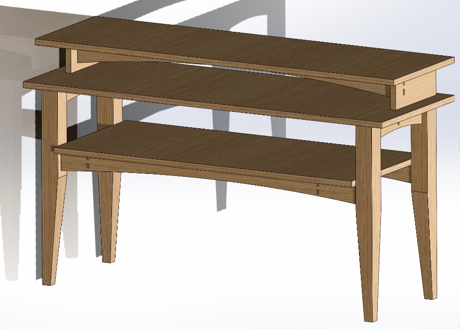

Final design
I added a lot of detail to plan out the joinery. This took some time, but reduced mistakes as the build progressed.
Detail Drawings
It is convenient to work off paper in the shop. Drawings are essential.

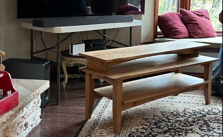

I did not take many photos of the build, but you can see that getting the joinery right in the planning helped a lot.
Ready for installation

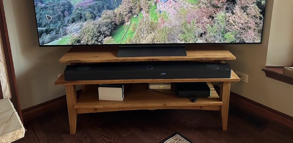

The Final Result
