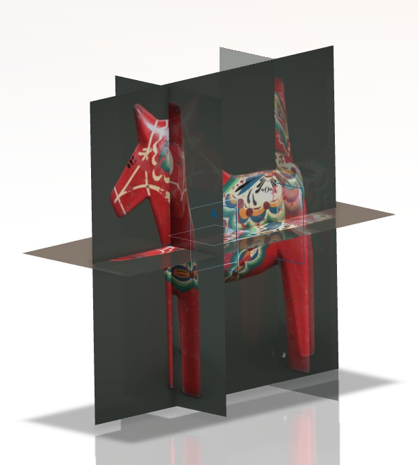

I started by brining in some photos of a dala horse from various orthographic views.

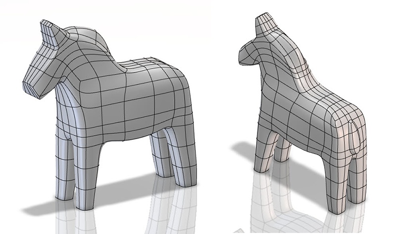

I inserted a cube primitive in xShape and then, using the various subdivision commands, was able to push and pull the shape.

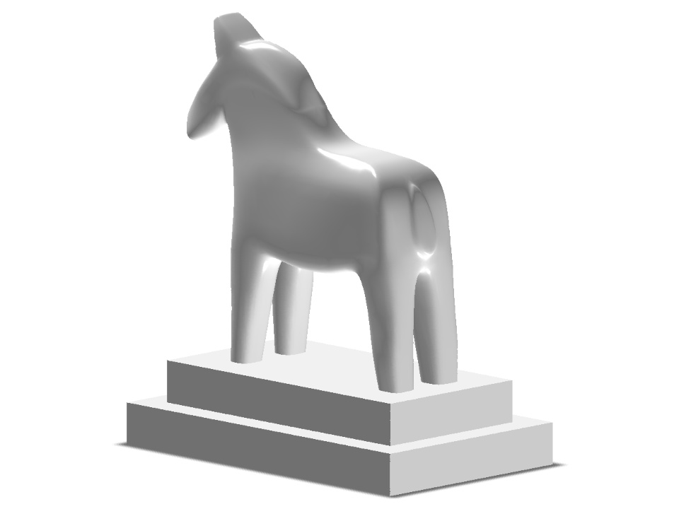

Here is an image showing the final shape / subdivision model:

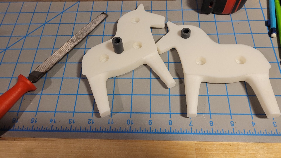

I split the horse in half and added some registration holes to line up the 2 halves when gluing.

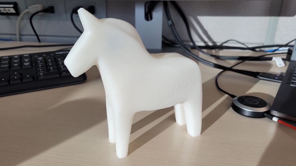

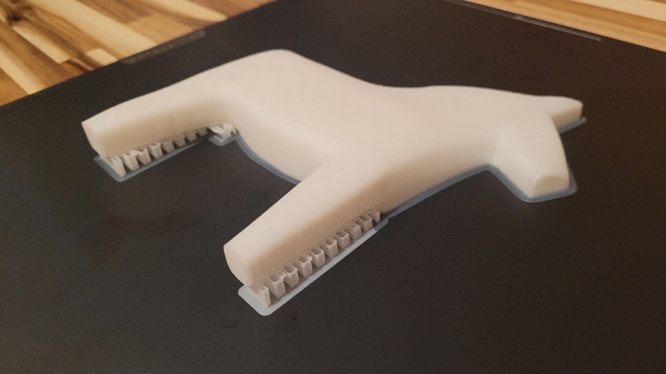

Here are some photos of the 3D Print:
