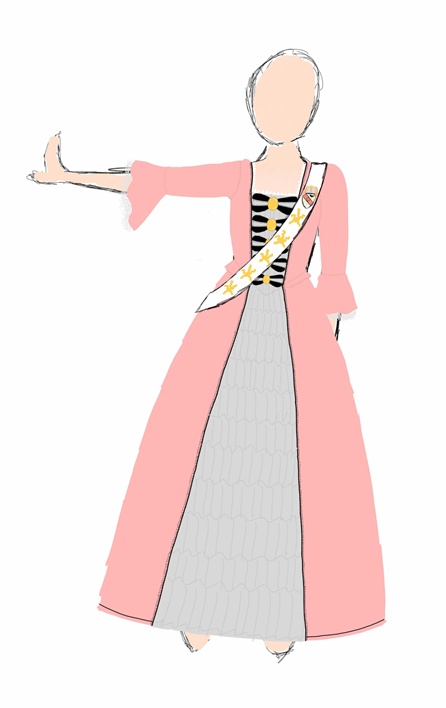

They're a charity organization. They connect build teams with kiddos and wheelchairs and their families. And we talk with them, we work with them, and we design and build this epic costume for the kiddo because a lot of times they're feeling self-conscious.. "Oh, people are looking at me weird because whatever, I'm in a wheelchair." And so our job is to make them feel like superstars. Everyone's looking at them because they're AWESOME.
So there is a SOLIDWORKS build team. We've done four builds, I joined the team for the third and fourth build. The first two, I was still in school so even though I knew about it, I didn't join the team because I just said I had too much going on with school and homework and stuff. So that you kiddo we had her name was Friday and she wanted to be a princess. But not just any princess like she didn't want to be a Disney princess or something. Nope...she wanted to be Princess Fejya. So we're like, alright, a purely custom Princess outfit. So we're like, OK...well, what does the princess need?  A princess needs a castle, a princess needs a crown, a princess needs a princess dress. So all sorts of things. We built her a castle that was on a floating island being pulled by cats on like a chariot floating in the clouds that went over her wheelchair. And my job was to make her the princess dress. Because this was totally custom. I didn't have any patterns I was working with. I was asking her - I pulled up collections of features of a dress and had her pick which one she liked the best. I specifically remember, I had a diagram with 30 different types of sleeves. And I said, "Which one do you like the best? What shape skirt do you like the best?"  And she picked all of them. And I drew up a couple of different designs until settling on the one that she liked the best.

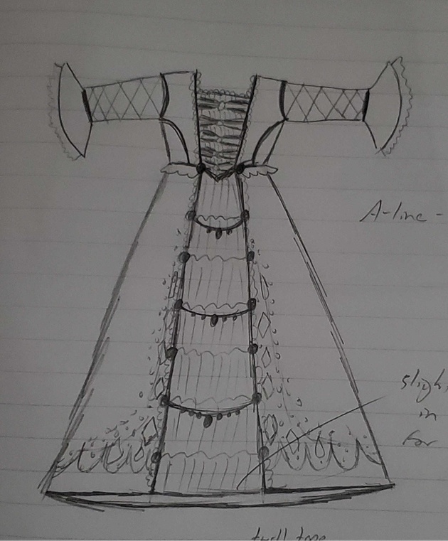

Rachael Naoum  8:28

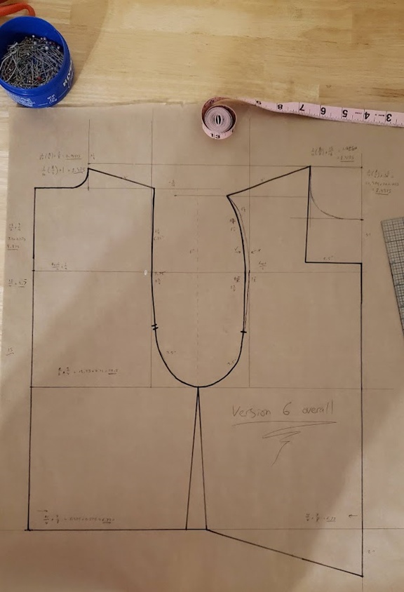

So through that I learned how to draft things by hand. And let me tell you, that takes a long time. So there was a learning curve of just how to draft, how to take a flat thing and use the right proportions and the curves and the lines and the spacings to make it fit on a person - and a person is not a flat piece of paper, a person's a person! And so after, I don't know, 15 iterations, every time I messed up, I would have to throw it out and start over because it's just a really big pain to erase all of those lines. And because they would affect everything else, if one line is out of place, then you're just the whole thing is shifted over. And so after all of that, and really getting the process down to a place that I think I know what I'm doing now, finally, I realized: "Hey, you know all this drawing on paper looks an awful lot like a sketch. And you know where else I can do sketches? SOLIDWORKS!"
And so I call that my "a ha!" moment.
Matthew Hall  9:32
So you had this "a ha!" moment and you started integrate - you brought your passions for art sewing everything and it converged along with SOLIDWORKS. How did that make things different? easier? or the going forward in your designs what changed?
Rachael Naoum  9:52

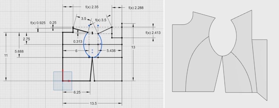

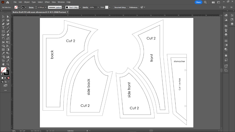

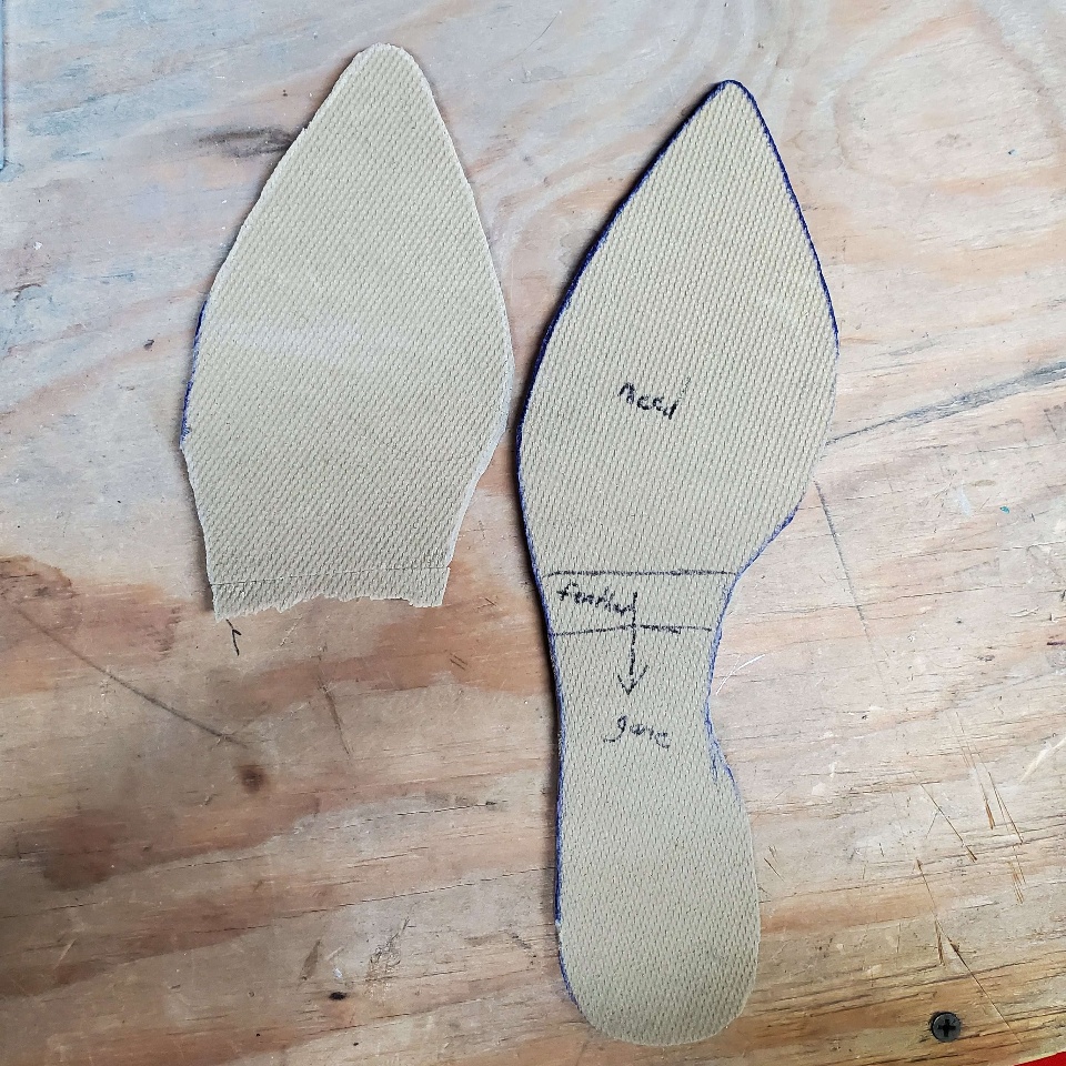

Once I was able to get the sketch into xDesign - I was using xDesign and SOLIDWORKS interchangeably depending on if If I was on my work computer, or if I was on my home computer.  So that was able to speed up my process; I didn't have to start over anymore if I messed up. All of my dimensions - I mean, I would just type it in. If I had something that was a proportion, I didn't have to bust out a calculator to get that equation, I could just type it in and say, "Oh, well, if I have to make a change, because the measurements updated, because we measured it the wrong time, I can just update that" and the whole thing will adjust.

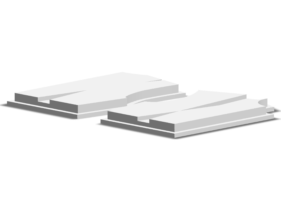

And so using that sketch, I was able to extrude it just a little bit. I added my seam allowances, so I just didn't like offset by a half inch around the entire thing. And then I threw it into a drawing file in 1:1 scale and then exported that as an Adobe Illustrator file, so that I could send it to my printer as a title to print. I just had like the normal paper printer at home not like a big one that normally patterns are printed on.
CAD model of pattern
And I taped the whole thing together and that was my pattern. If I had to make any changes, like okay...we'll do the fitting and we'll say, "Oh, well, it's a little bit loose over here," I can just snip that part out, and then move the bodies and combine it back together again with that volume missing. And that just made everything a lot easier and faster.

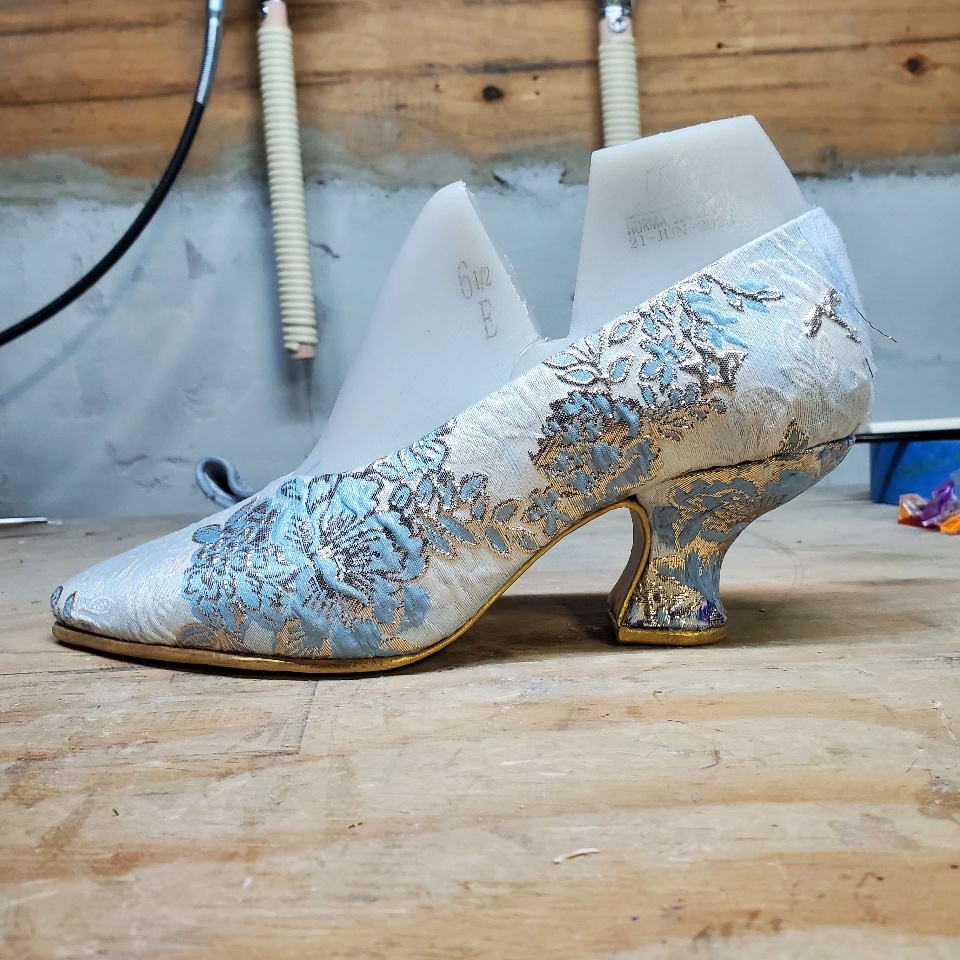

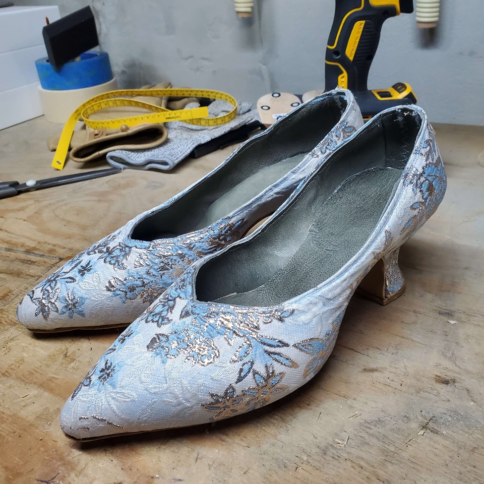

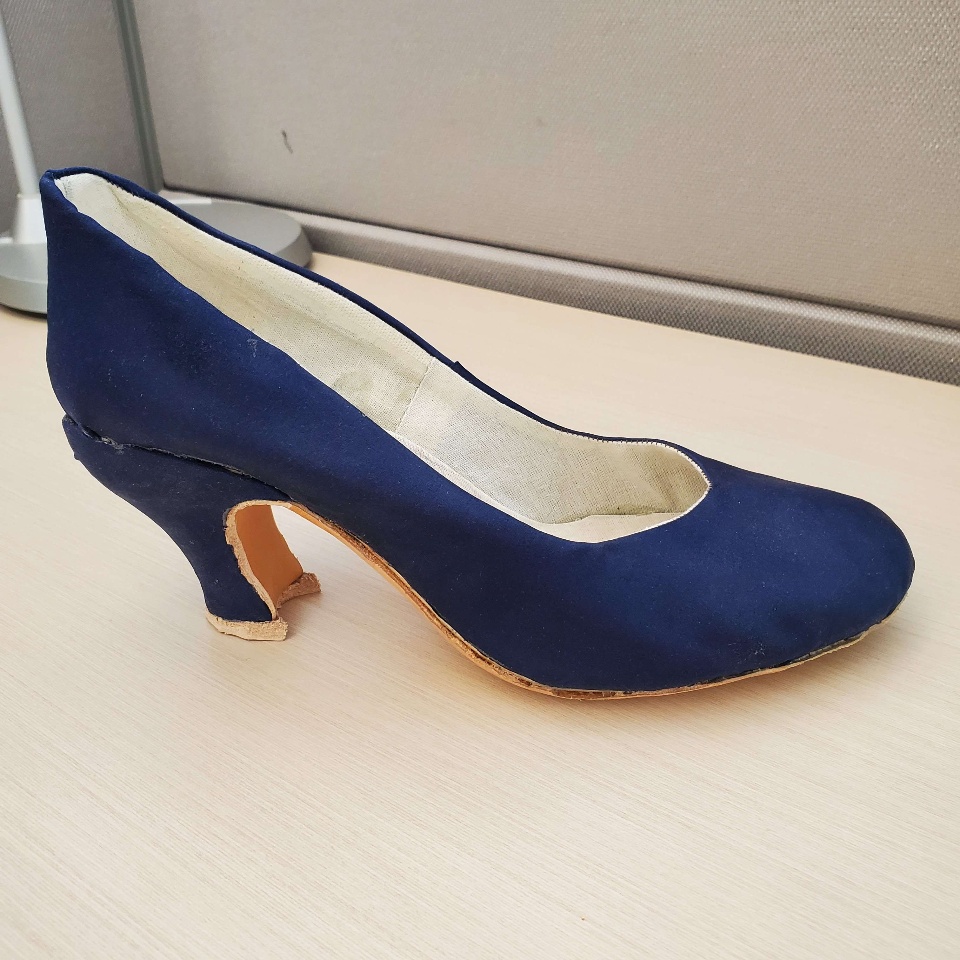

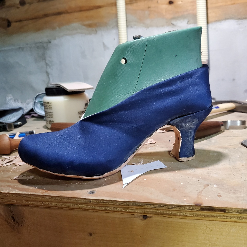

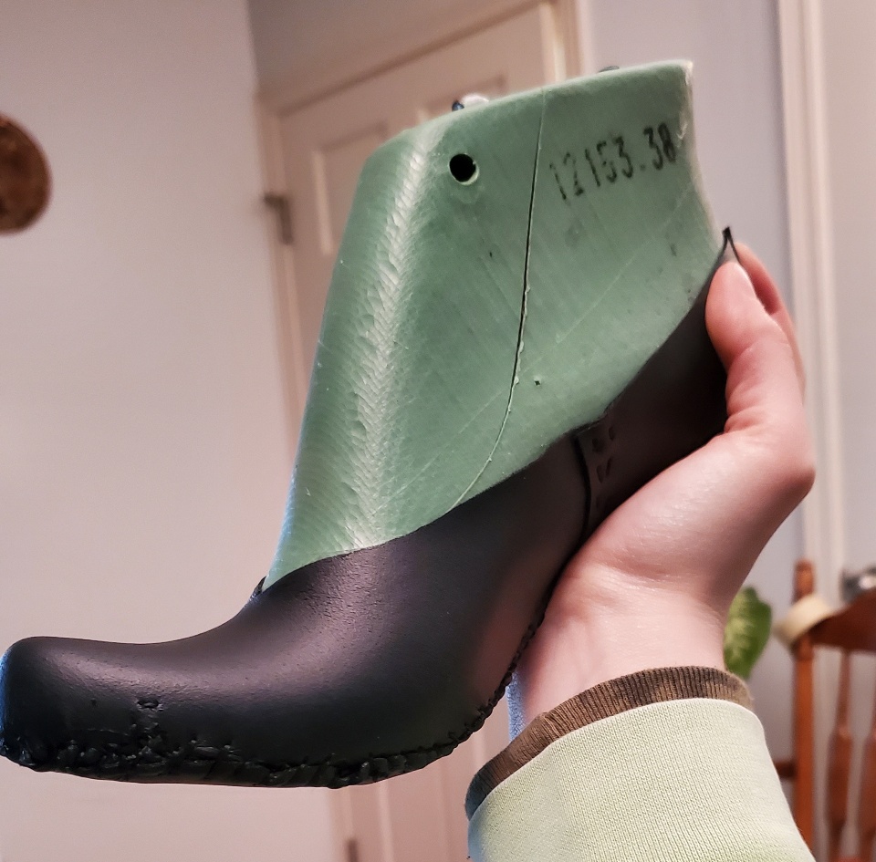

And yep, so since March, I've been teaching myself how to make shoes. And that's been quite the process I've done four individual practice shoes, I haven't made a pair yet. Because why make a pair when I know it's no good and I won't use it? So I've just been making different individual shoes and improving on my technique and my process and materials every time she asked. Now, I'm starting to bring in the CAD element. So I saw to make shoes, you need something called a "last." And that is the form of your shoe in the size of your foot. And so I wanted a shoe that has like maybe a 2, 2 1/2" heel with a nice pointed toe. And I have this it was based off of an older design from like a 1916 last. And I made my practice shoe and it looked perfect. But when I put it on, it was too big. And so this is actually the fourth last I purchased because every single one of them has been too big for different reasons.
Because it turns out that your shoe size when you buy a shoe, it's just the length; it doesn't account for the width. So if you have a wide foot you need to get a longer shoe size unless you can find it in a wide. And so the shoe size I've been wearing my whole life is actually wrong and that was a whole like thing I had to accept because your shoe size doesn't change when you're an adult like, "What do you mean this is wrong?"
So it took me many attempts to get down to the proper size and this is where I said "Okay, I don't want to buy anymore shoe last, this is getting expensive, and I don't want to buy more." And the place I bought this one from the woman selling it, she only opens her store twice a year because she doesn't have a warehouse (side note - she's actually closed her supply store for good as of December 2023). It's just her and her house. So she takes pre-orders and then ships them out to everybody. So I knew, "Okay, well, I can just wait until the next time she opens it in like February. Or I could try to fix this...maybe?" So I ran through a bunch of different ideas. I'm like, "Well, what if I shaved down the toe? But then I might lose the toe shape and I don't, I don't want to. Well, what if I shave it down from the heel, then I can keep the toe shape....but then the arch is going to be in the wrong spot for like the length of my foot" and like, "Oh, these are all weird. What if I make a mold of it? And then I fill it was something...?" But that I couldn't figure out okay, well, if I make a mold of it, what plastic do I use? Can I even get that in a format that I can melt down? And so finally, I heard from @SF in the lab in the Waltham office. He goes, "Hey, you know, we got a new 3D scanner."  A scanner??? Hang on now.

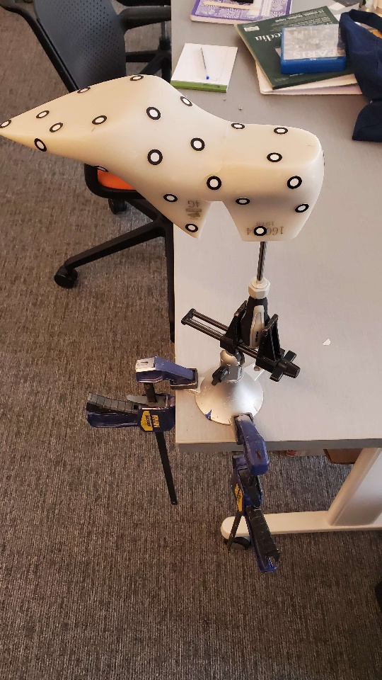

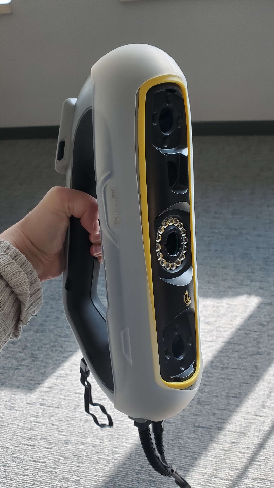

I just did this, like two weeks ago. I brought my last in, covered it with a bunch of the scanning targets, the little black and white stickers. And I took a 3D scan of my last. And the software we're using, we're able to generate a watertight mesh. So if I just send it into SOLIDWORKS, or to a printer, I wouldn't have to do any post processing, it's already solid. It's not gonna be a bunch of separate surfaces that I have to worry about getting together. So that saved me so much time.
So I got the STL dumped into SOLIDWORKS. I said, "Alright, well, how am I going to work with this?" The width is fine. I don't want to mess with the height of the heel, I just need to be shorter. So I opened up the Scale feature and realized I can do a non-uniform scale and just the length of the last. So I'm like, "fantastic. Let's cut that down about a half inch." So what's that in percentage? All right, let's call that 94% scale and I resized the last. And right now I just have VCarve installed on my computer. So that's the software we use with the ShopBot in the lab. I'm currently figuring out how to use those tools so that very soon I will be able to machine myself a wooden last.

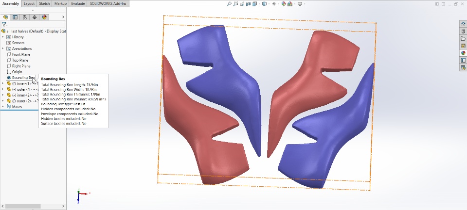

I think so. I'm working on my first pair right now actually. I'm going to an event in a week and I want to make shoes that match the dress that I made that I'm also going to wear to the event. So I am using the last that's too big. But if I put a 3mm cushion in the ball, it will probably fit fine.
Matthew Hall  18:15
To balance it out - 3mm is not too much. That's pretty small.
Rachael Naoum  18:20
Yeah, but you'd be surprised how much volume that takes up.​​​​​​​
