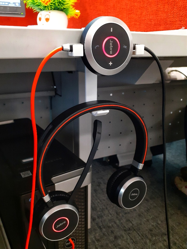

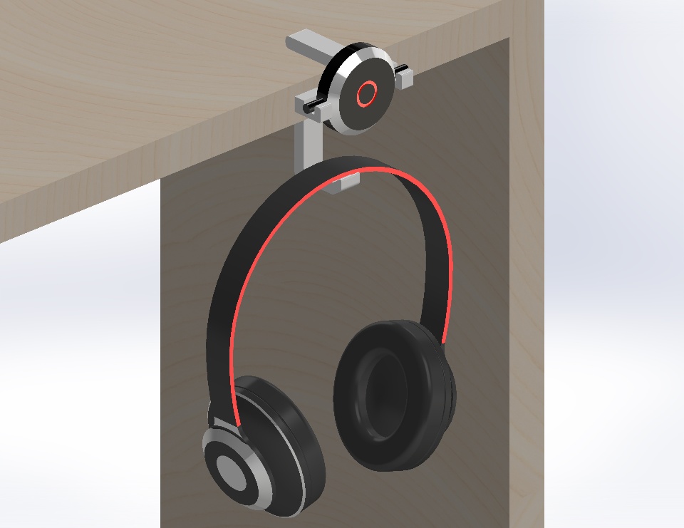

This Idea came after facing a lot of struggles with my Headphone, where to keep it without strangling the cable and managing the Evolve Link (Button control).
Key Features:

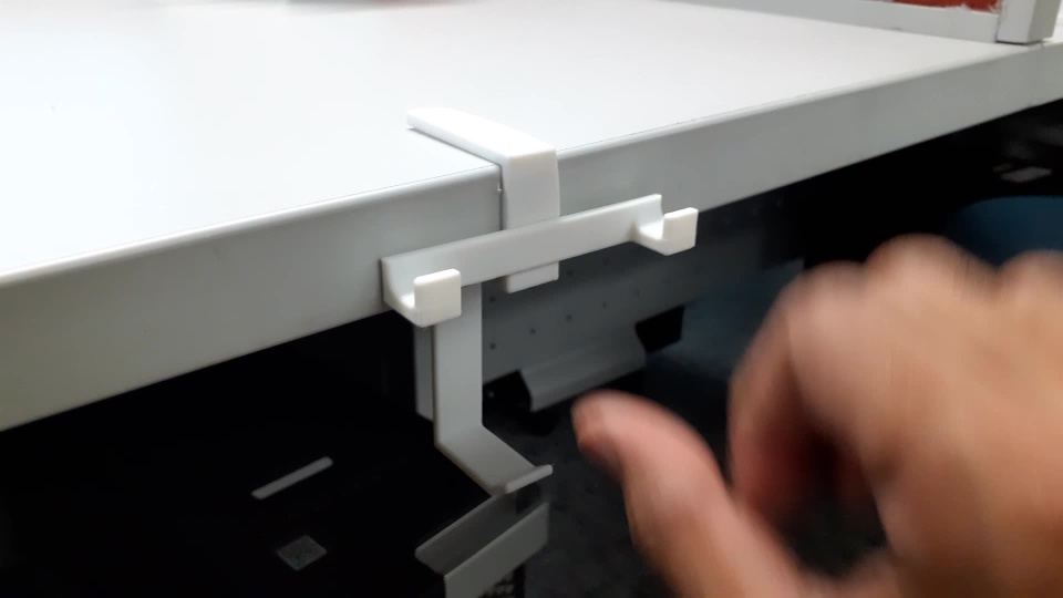

- Easily snaps to the desk
- The clamp is tapered at the end go get a natural clamping force.
- Holds the headphone as well as the controller Evolve Link, so you have the controls right next to you.
- Lightweight (Few grams) and easy to 3D print.
Snap on the Desk - Video

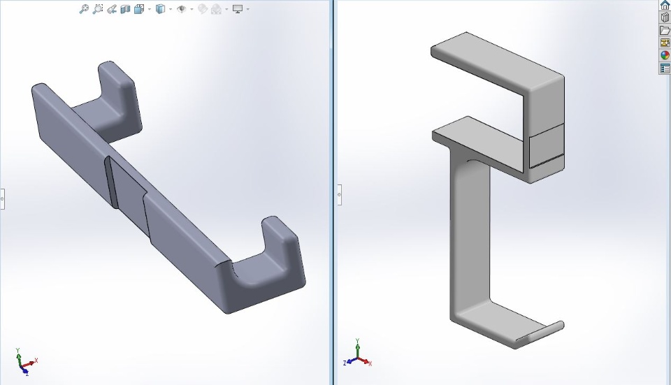

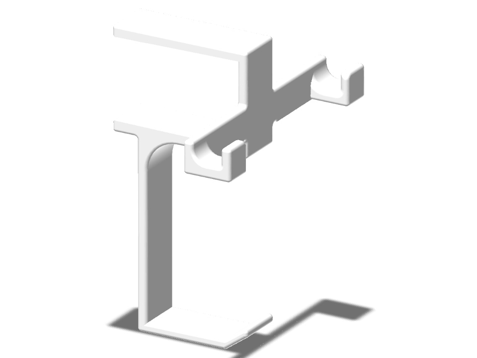

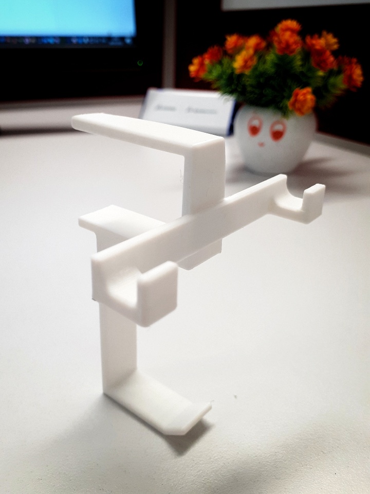

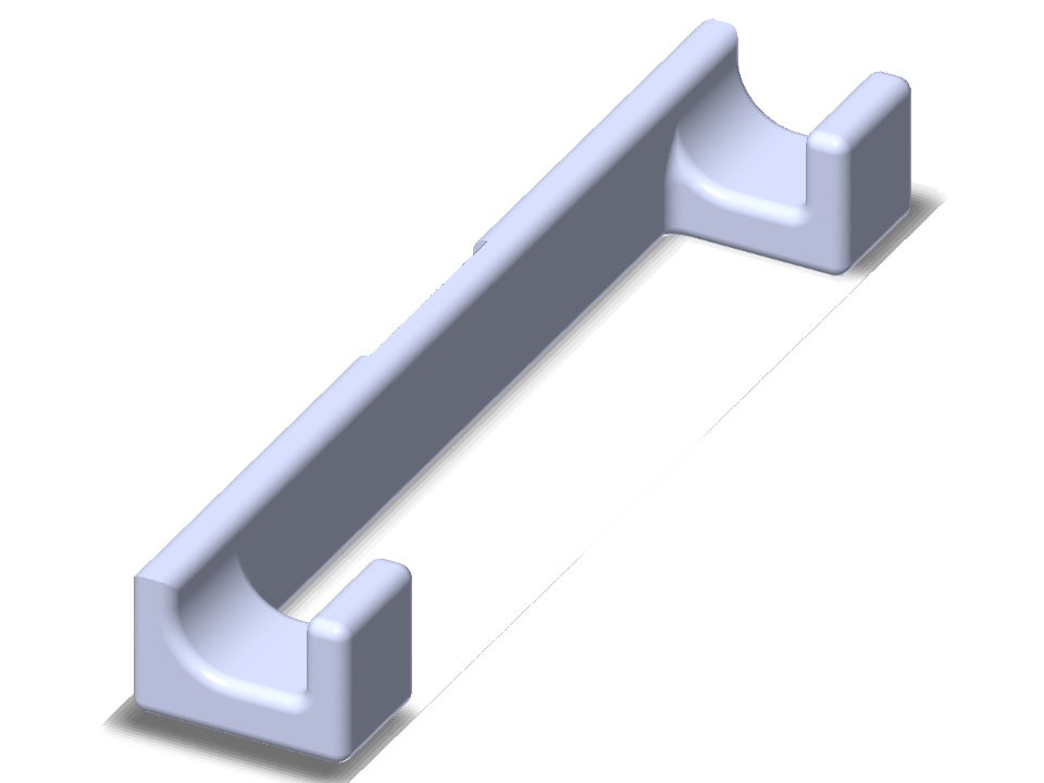

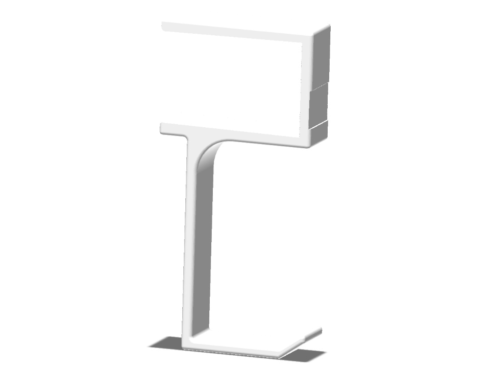

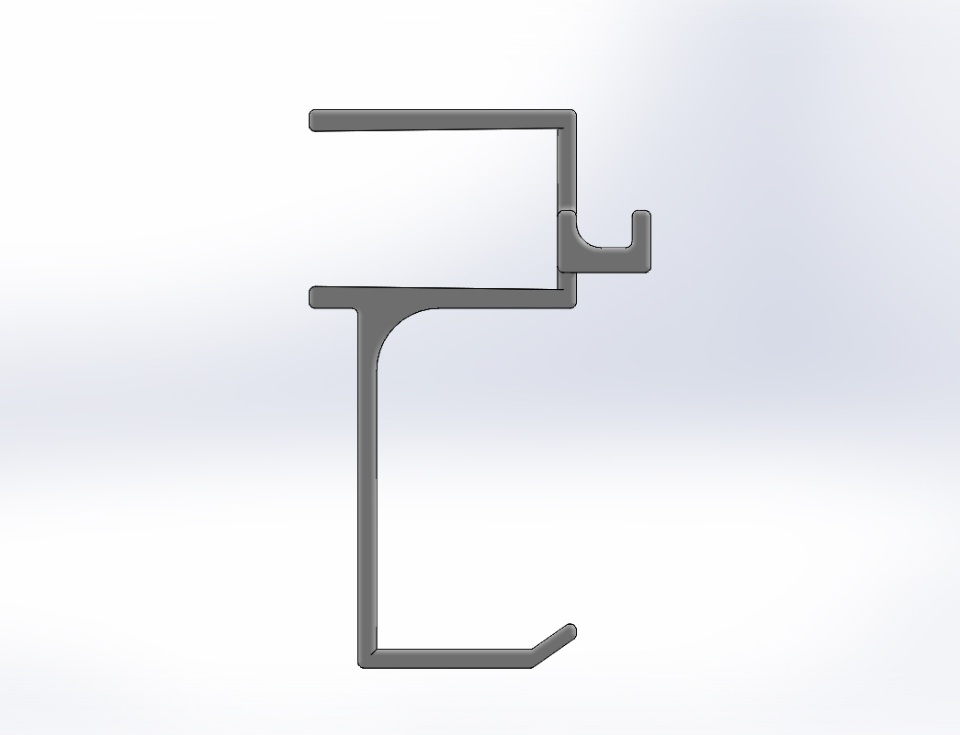

3D Printing:
To make the 3D Printing easy and avoid additional material wastage in supports, I split the design in two parts and then glued to obtain the final design.
