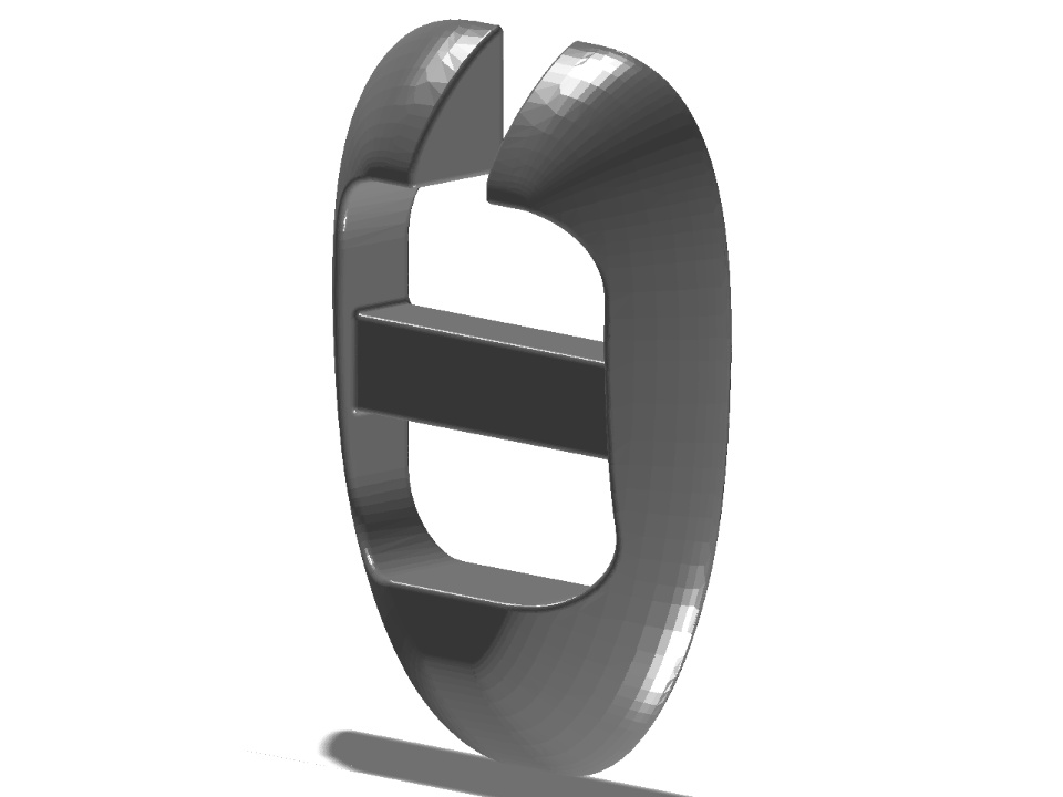

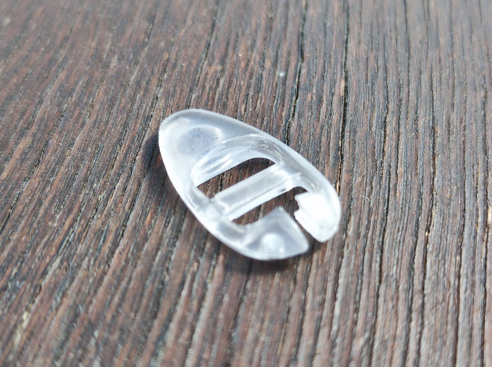

Old plastic original piece

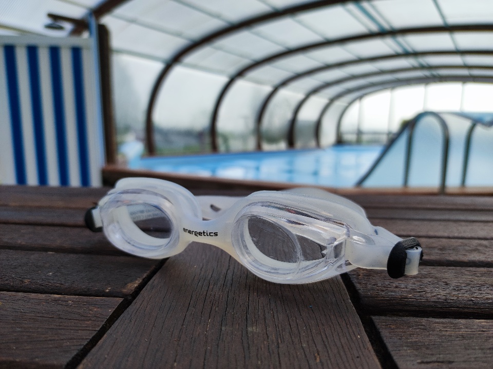

The original design of the swimming goggles part was unfortunately not meeting my expectations in terms of fit and durability, as it suddenly broke into pieces while adjusting the fit.

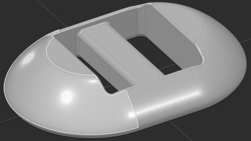

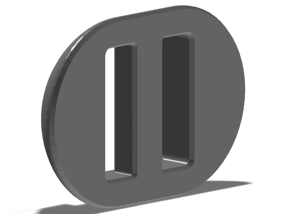

Therefore, I decided to use basic CAD skills to redesign and create a more suitable part.

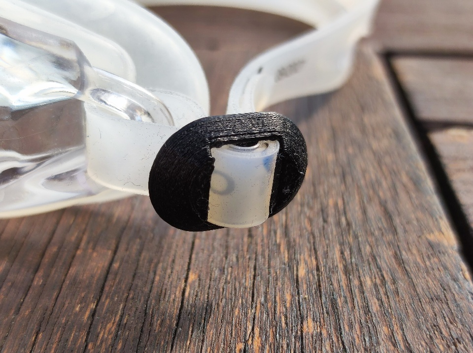

The digital model of the part was then 3D printed using an Ultimaker 3D printer @3L.
The new design is produced of a strong and durable material (Nylon) that fits securely the elastic band around the temple area. The material is also waterproof, which means it is resistant to water damage and can withstand prolonged exposure to chlorine and other chemicals used in swimming pools.
One of the most significant advantages of using the additive manufacturing technology for this project is that it quickly allowed iterating and improving the material choice. @CC was able to make several prototypes and test them in real-world scenarios before settling on the final material. For instance, a more flexible material was in fact not appropriate, as it did not keep the elastic band as tight as necessary. This approach has helped to ensure that the new part is of the highest quality and fully meets the requirements 🎯.
Overall, I'm thrilled with the results of this little project, and I believe that this new design will be a game-changer for these swimming goggles in the run. I look forward to continuing to innovate and improve daily life products through the tinkering journey.
Feel free to reach out to me if you have any questions. Both CAD models can be found below ⏬
