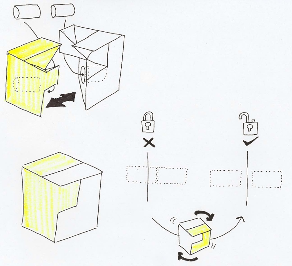

"Spoilers" for those who like puzzles :
There are two similar blocs which assemble perfectly into a cube. There is a hole in each blocs, hiding two small tubes. When the assembled cube is slightly tilted, the gravity pulls the tubes in the middle, preventing the cube to open (see image below). The cube can only open if the tubes are in their respective blocs. The only way to do so, is to use the centrifuge force by rotating the cube fast enough.
m
This is my first design on CATIA. I imagine it lacks the tolerance rules allowing the blocs to properly assemble.

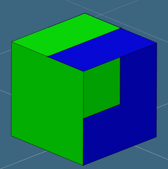

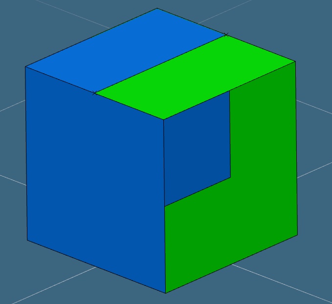

Here is what it looks like assembled (images). The FD shows on each side :
m  m

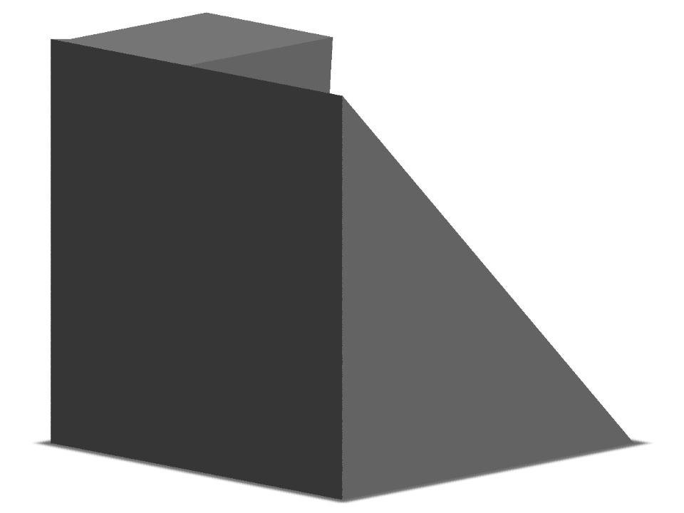

Here is the bloc (3D). I'd love to have one Green and the other Blue :
xl_thumb

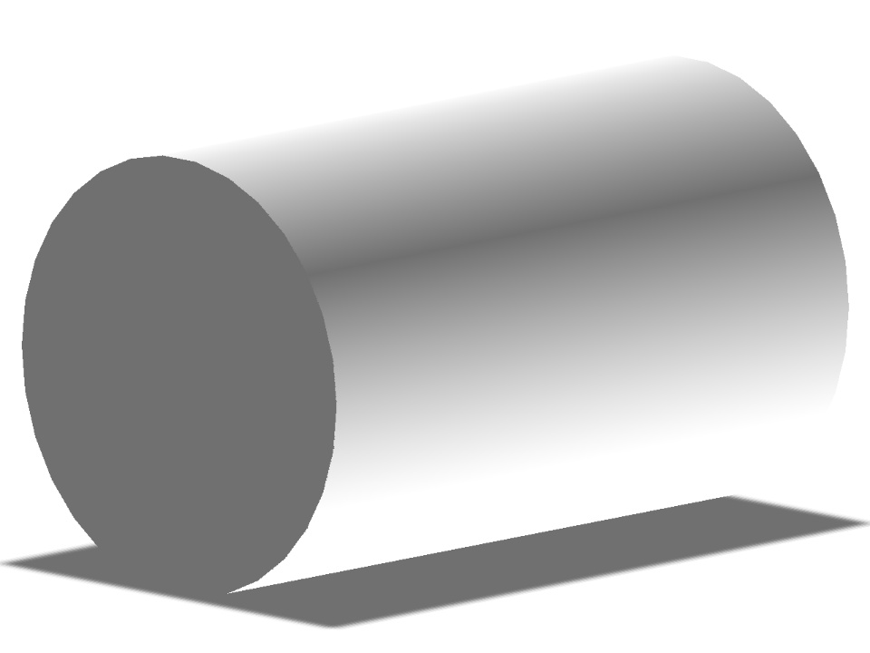

Here is the Tube (3D).
xl_thumb
