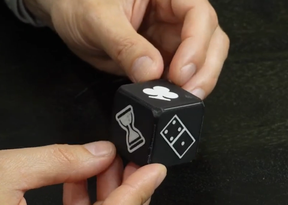

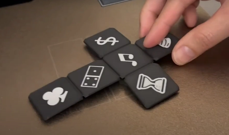

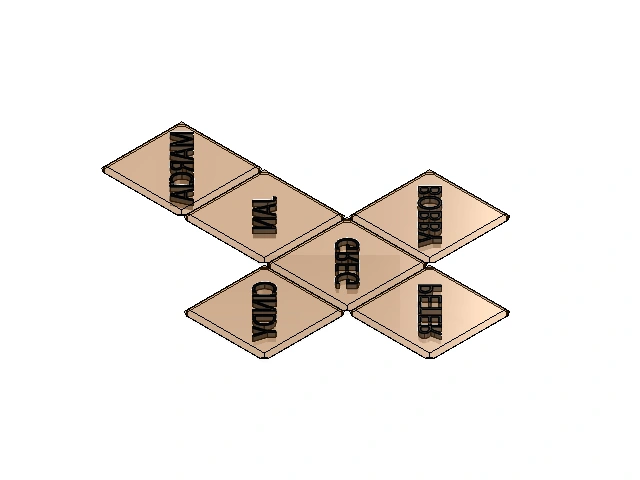

The die was designed in a flattened state so I could quickly print it in multi-color and then fold and glue it together. It comes in really handy when you need to determine who gets to go first.

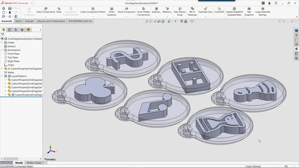

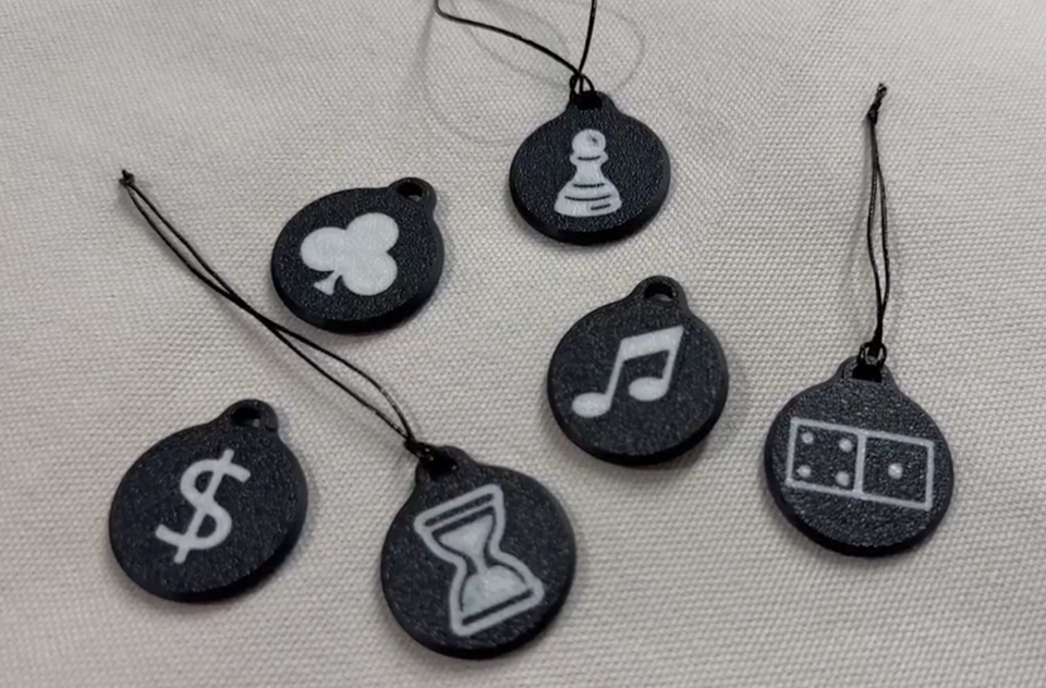

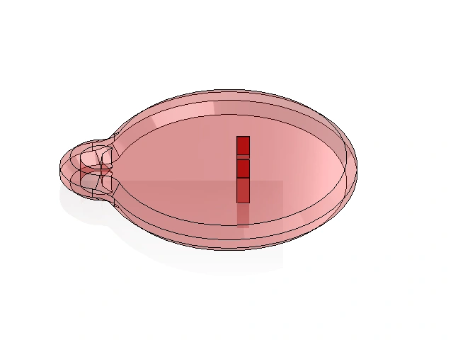

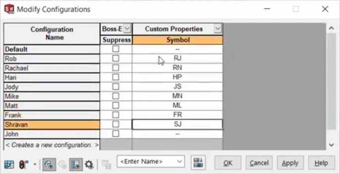

I designed one generic drink tag with the sketch text linked to a custom property, and then used the "Configure Feature" command to fill in a table of values to build as many tags as I want.
This text creates tags with people's initials
A symbol font was used to create these images
If you use a standard font, you can make tags with words or people's initials, but if you use a symbol font, you can populate your tags with cool images.

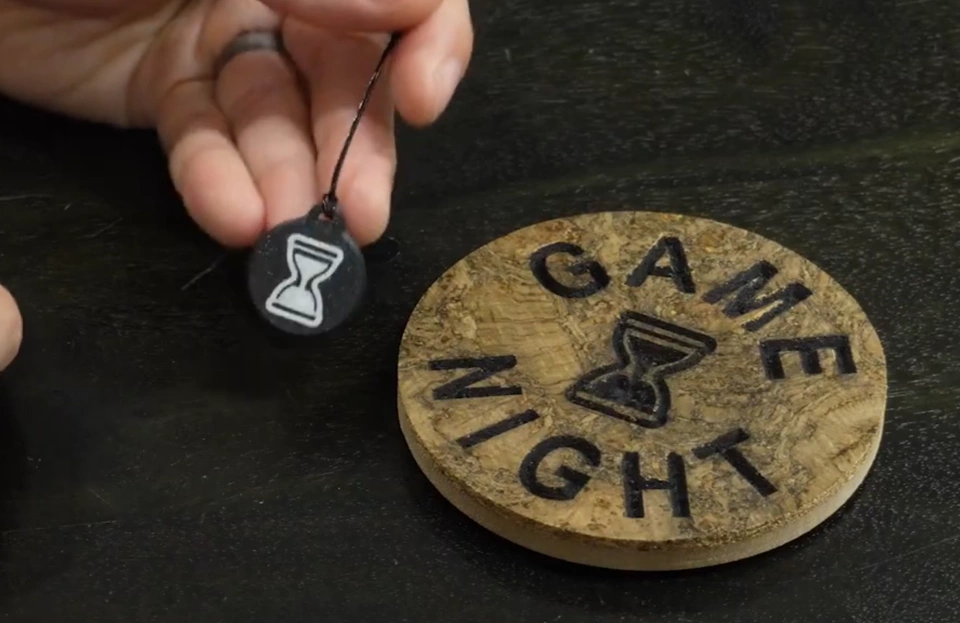

I used the same technique to make the matching coasters. These were cut on a CNC router with a 60 degree v-bit.

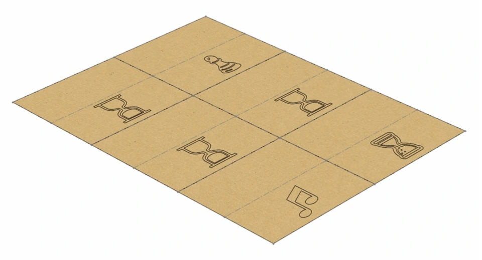

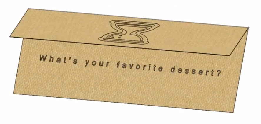

The table tents used the same technique to place symbols on the front and fun ice-breaker questions inside, but I combined this approach with sheet metal so I could see the tent in the folded and flattened state. To efficiently print things out, I made an assembly of all the flat patterns and then printed a 1:1 drawing.
