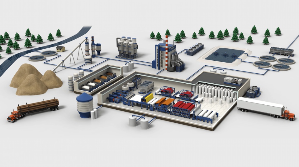

A paper mill is an industrial facility that is primarily involved in the production of paper and paper-related products. It is a complex operation that combines various processes to convert raw materials, such as wood pulp or recycled paper, into finished paper products.
Here is a general overview of the processes typically involved in a paper mill:
Raw Material Preparation: The paper mill starts by preparing the raw materials. Wood logs or recycled paper are collected and processed to obtain the necessary pulp. Wood logs are debarked, chipped, and then chemically or mechanically pulped. Recycled paper is sorted, cleaned, and processed to remove ink and other impurities.
Pulping: Pulping is the process of breaking down the raw materials into individual fibers. This is usually done by mixing the raw materials with water and chemicals, then subjecting them to heat and mechanical action. The resulting pulp is a watery mixture of fibers, water, and chemicals.
Cleaning and Screening: The pulp undergoes various cleaning stages to remove impurities such as dirt, sand, and other foreign materials. Screens and filters are used to separate the pulp from larger contaminants.
Refining and Bleaching: The pulp may go through refining processes to improve its quality and fiber properties. This involves further mechanical treatment to break down the fibers and improve their bonding characteristics. Additionally, if bright white paper is desired, the pulp may undergo a bleaching process to remove any remaining color or impurities.
Papermaking: The refined pulp is fed onto a paper machine, which is a large continuous conveyor belt-like structure. The pulp is spread evenly across the machine and undergoes a series of processes to remove excess water and form a continuous sheet of paper. These processes include pressing, drying, and calendering, where the paper is smoothed and compacted.
