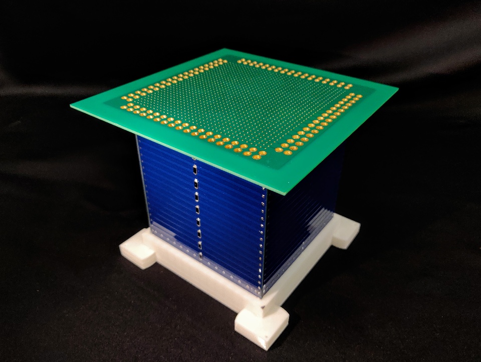

When I spoke with John Leyva, a Ph.D. student who is working on the GRAMS collaboration project at Northeastern, I was fascinated by their research on the "missing mass of the universe", Dark Matter. In this experiment, they seek to build a sensor to "indirectly search for particles corresponding" to a "particularly unexplored region of the energy spectrum from ~0.1-100 MeV". (To learn more about this experiment scroll down)

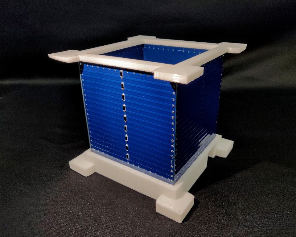

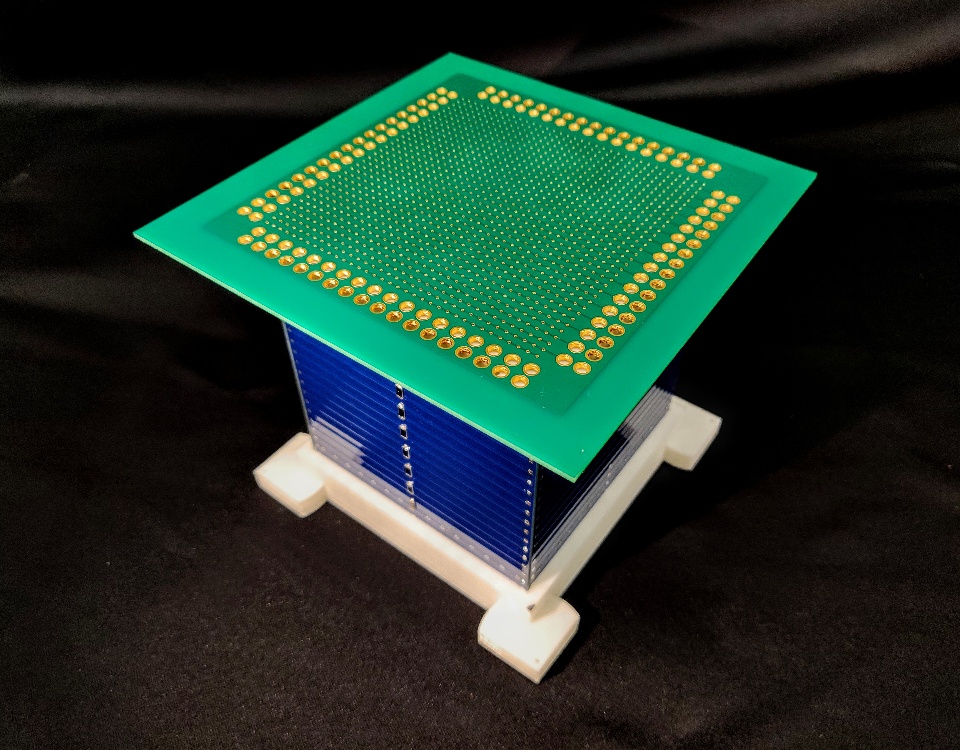

I knew I wanted to help, and I noticed they were having difficulties getting parts made and tested. I offered my assistance in the design and fabrication of some of their 3D-printed parts, some of which you can see below:
Stay tuned for updates on this project.

Time projection chambers or TPCs are a class of detectors designed to ‘catch’ high energy particles and perform a 3D reconstruction of their trajectories through space. In the case of GRAMS, the bulk of the detector consists of a volume of liquid Argon (LAr) that is placed in a strong electric field. Referring to the photos, the cubic volume that is bounded by the blue PCBs will contain the LAr, and the horizontal traces that can be seen on each face make up the field cage that produces a uniform electric field everywhere inside the vessel.
When a cosmic ray penetrates the detector and interacts with an Argon atom, a phenomenon called scintillation (quite similar to fluorescence) occurs in which an excited Argon atom releases a pulse of light (for Argon, the scintillation light is ultraviolet at ~128nm).  Mounted to the bottom 3D printed frame of the TPC (seen in white), a semiconductor-based detector called a Silicon Photomultiplier (SiPM) that is sensitive to single photons waits for this signal.
In addition to this flash of light, a shower of electrons are also produced as the cosmic ray is slowed down in the detector until all of its kinetic energy is dissipated. Because these electrons find themselves in a strong electric field, they are accelerated upwards towards the green PCB seen in the photo which contains a grid of charge-sensitive pixels.
