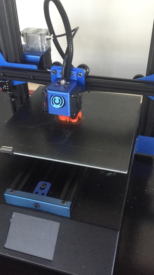

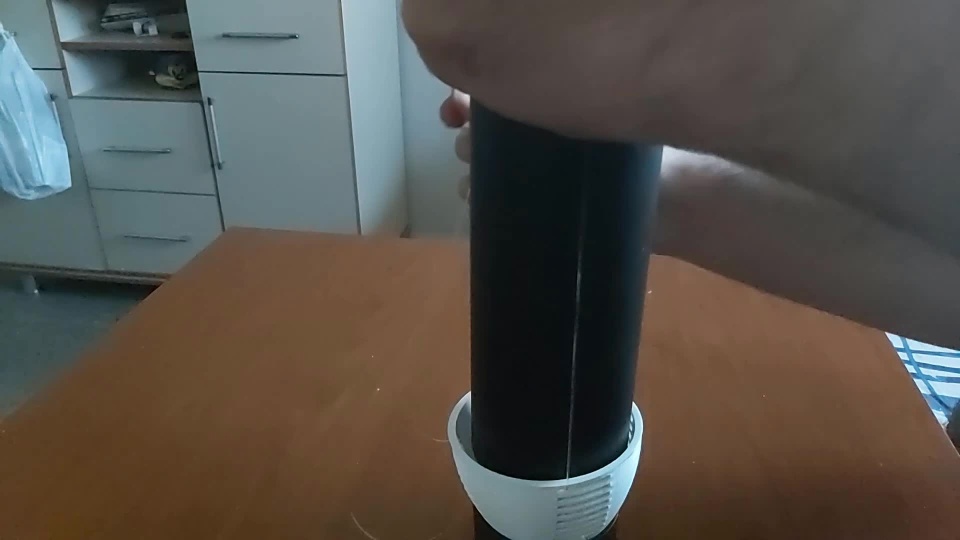

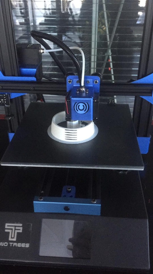

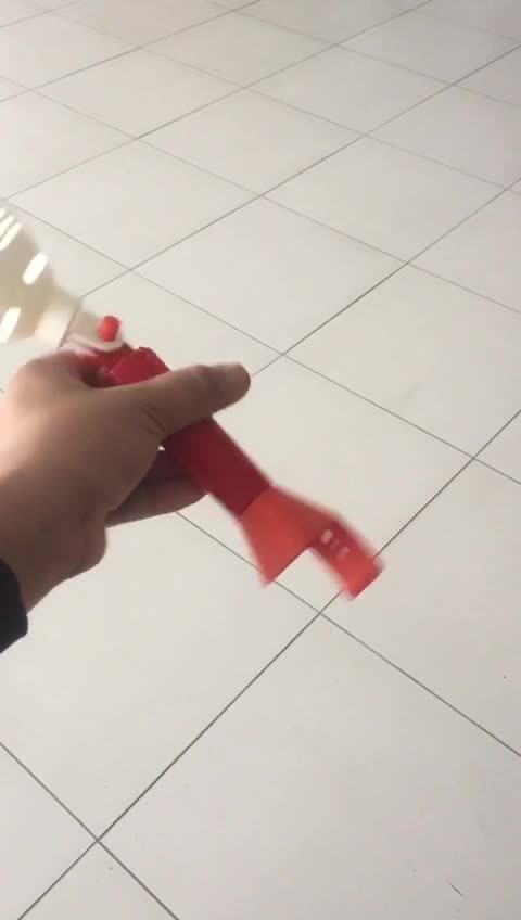

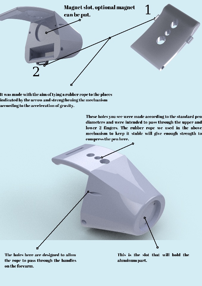

Since I don't have a fastening device, I showed it when tying it with fishing line, it is tied to the shoulder in this way, and the Velcro straps coming out from 4 sides are fixed with a wide band that wraps around them, as I did last time, thus offering both an aesthetic appearance and a comfortable usage experience. In addition, with the mechanism to be attached to the neck on the back of the forearm, it collects all the load on the spine and this provides a user experience without making us feel any weight. At the same time, since it is a smart design, if you wear this connection on your wrist, this process will be connected to the elbow and this time your biceps will take the load. I could have made bendable designs, but the reason why I can't do it is because the corners will stretch and break in long-term use. That's why I provided such a design and such a grip experience.
My #ARM4ALL Design and 3DEXPERIENCE Dashboard

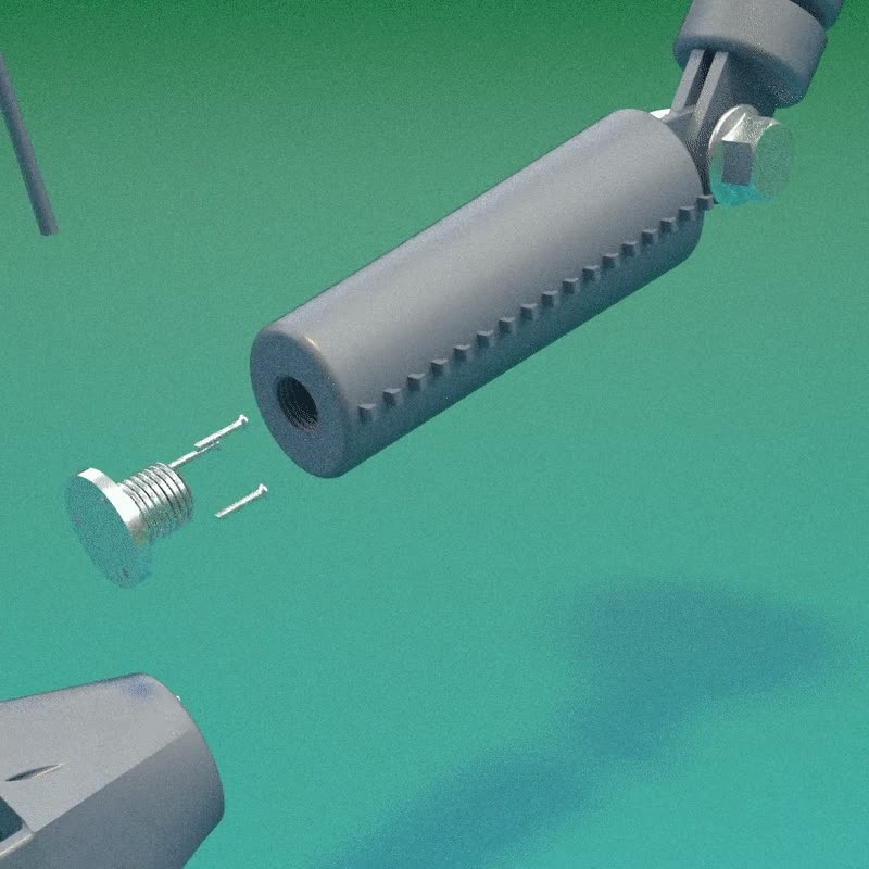

Creating Animation on SOLIDWORKS Connected

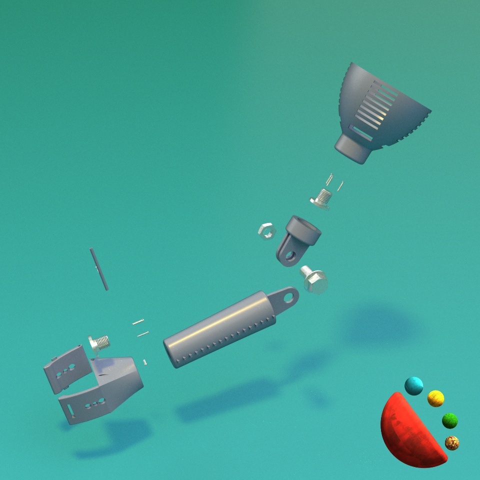

Creating Animation on Viısualize Connected
Information About the My Design
Before I started this design, I had many mechanisms in mind. I have sifted through these mechanisms. And as a result of these eliminations, I decided to use rope and rubber rope. I shared the details of my design with you in the first video. And it is clearly explained to you in a pdf document below.
In addition, I did not specify in the images, but it can be mounted without a front arm. You can also attach the mechanism that attaches to the upper arm directly to the wrist section.

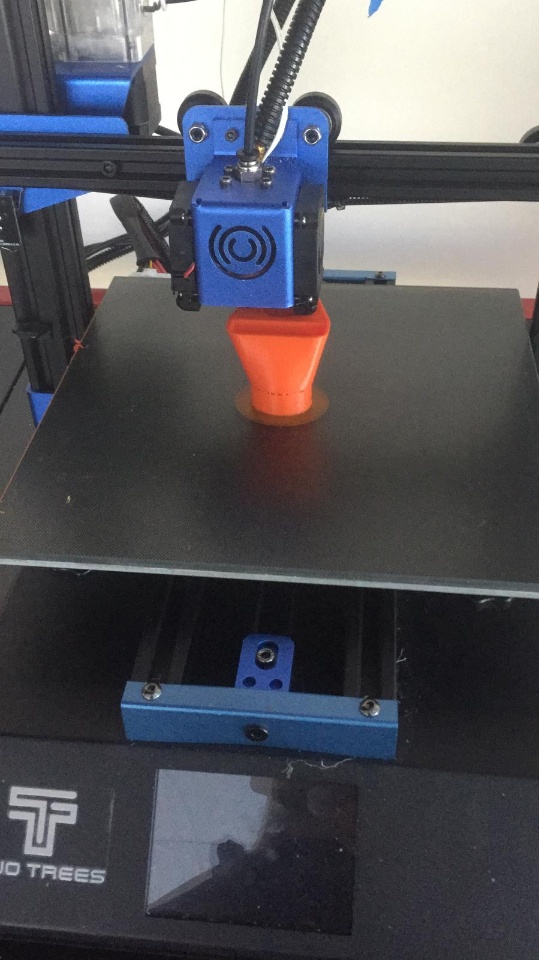

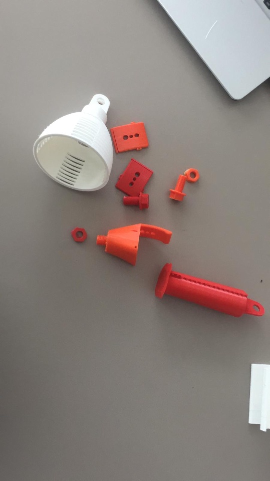

Real Picture

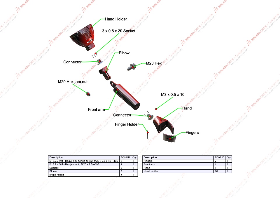

Composer
I used Composer for the first time here and it is a really nice application, I could do very good things, but my knowledge was insufficient. I will improve myself in that field as well.
