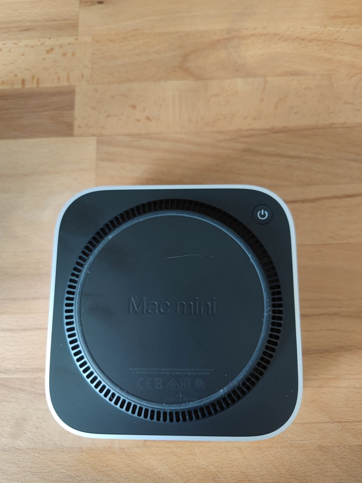

I got a new Mac Mini last year. It's a nice machine, but it has an odd flaw: the power button is in the back under the machine.
When you want to start the Mac Mini, you'll have to reach behind and under the case to press the power button.

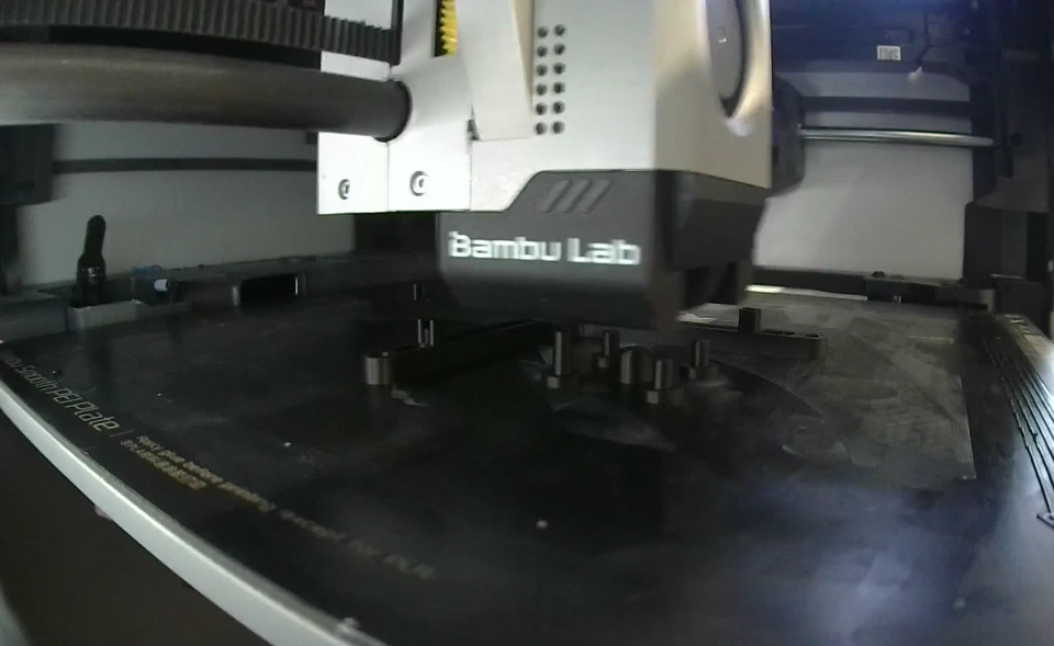

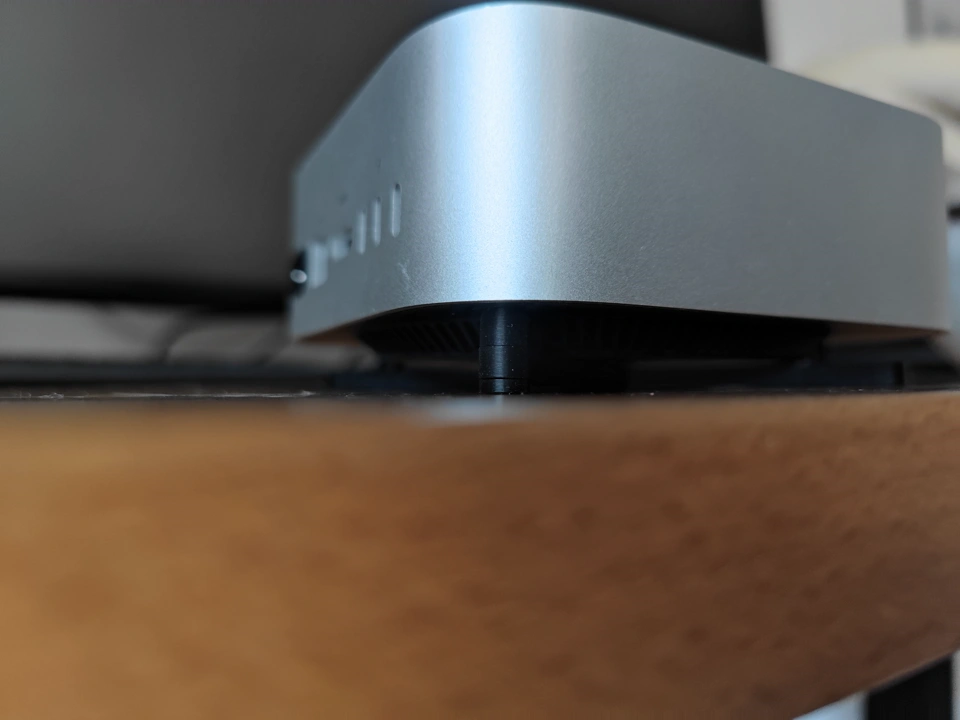

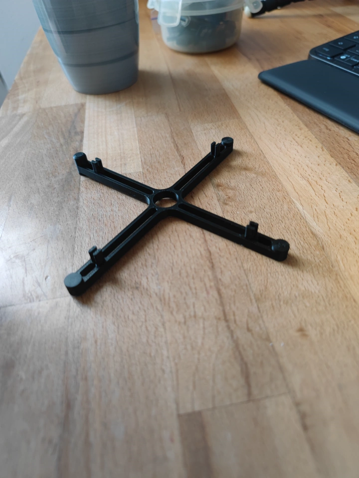

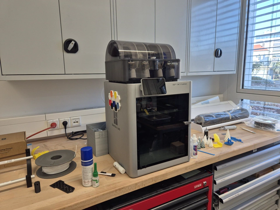

I printed this little stand in the 3DEXPERIENCE Lab Munich. With this socket, the Mac stands on 4 legs, and one leg has a bigger knob that fits to the power button.

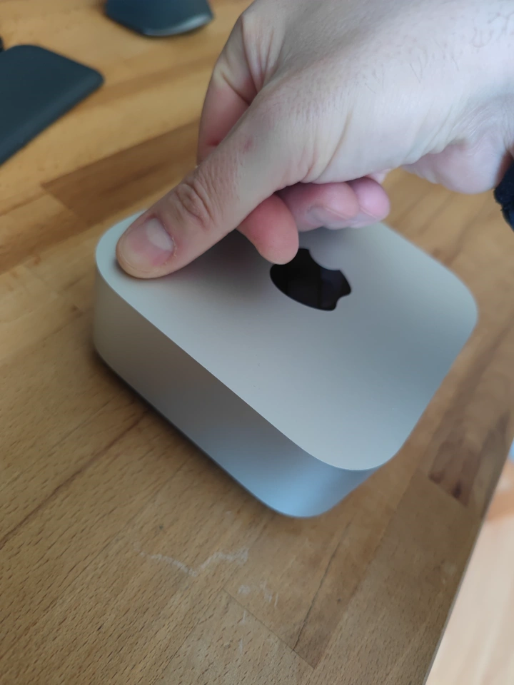

You can start the Mac Mini by gently pressing down the whole machine in the top left corner.
