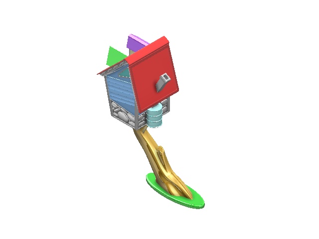

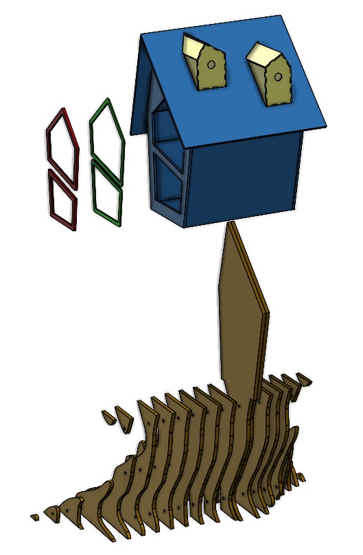

The design team made up of @JT, @AB, @JP, and @SV came up with a whimsical design that the build team (@LD, @KD, @CO, and me @.S ) could build.

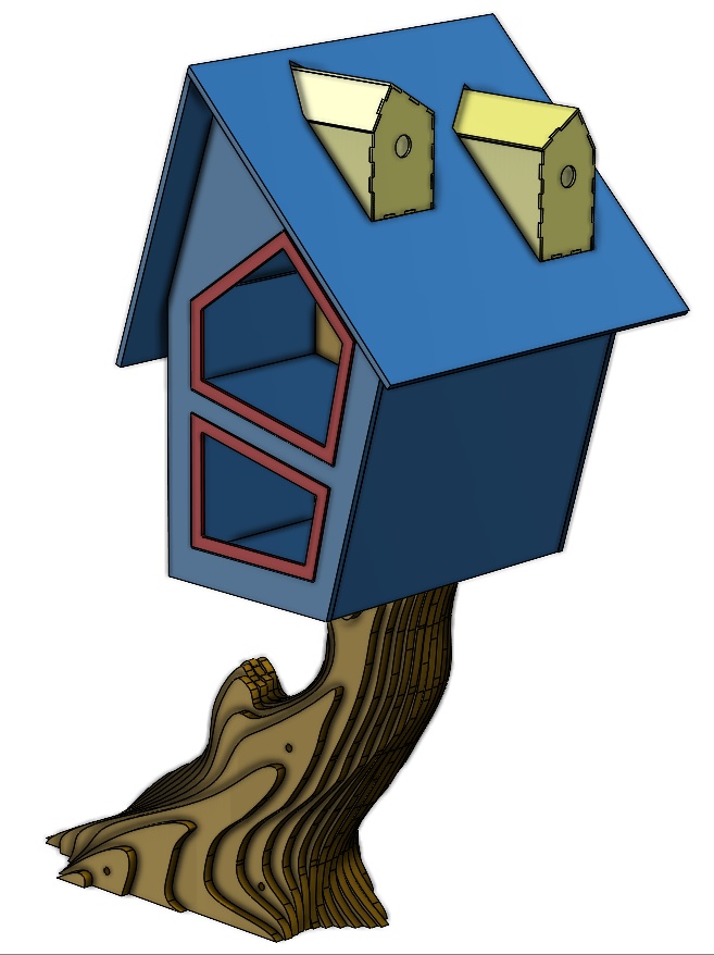

They used SOLIDWORKS and xShape to design a lending library that sits atop an old tree trunk.
Then they used some clever modeling techniques to generate the dozens of wooden pieces we'd need to produce.

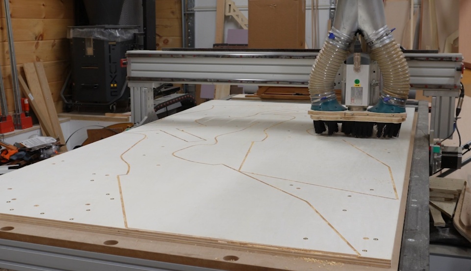

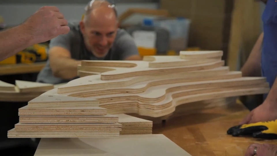

I cut out the layers of the tree trunk on a CNC machine, and then we glued and clamped them together with threaded rod.

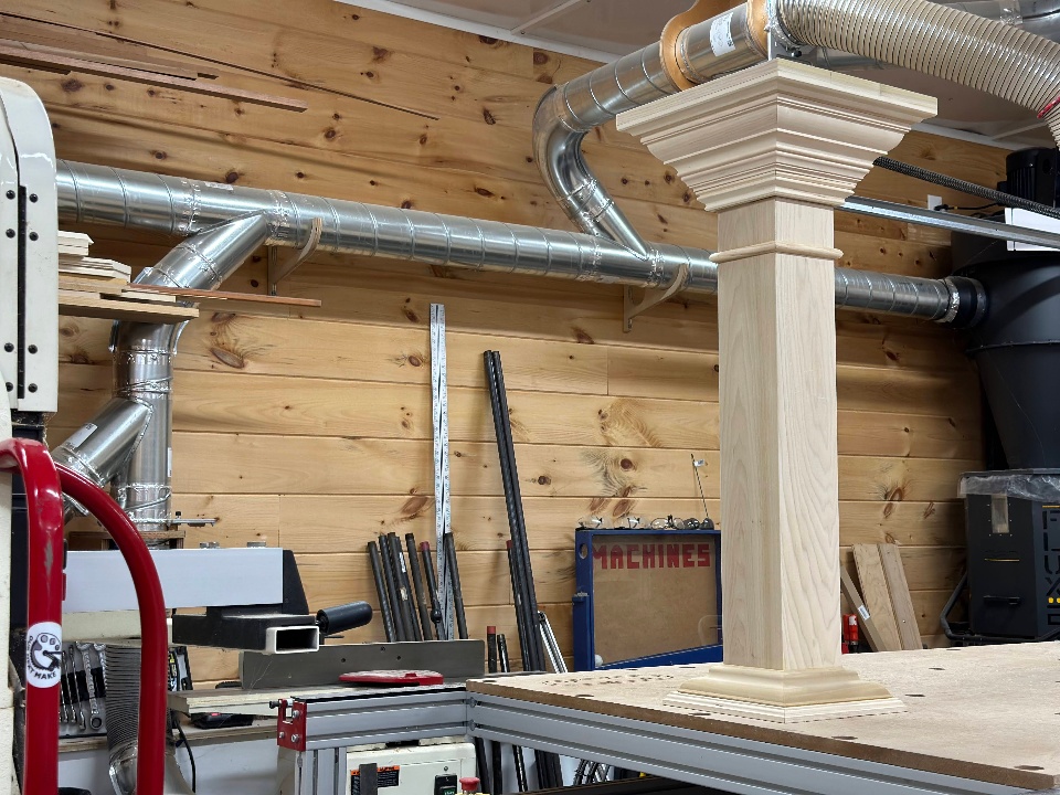

I also designed and built a pedestal to show an alternative way to support the lending library that could be made using more traditional woodworking tools.

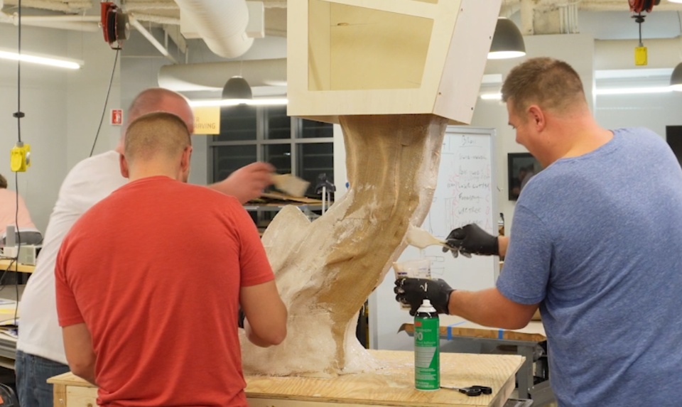

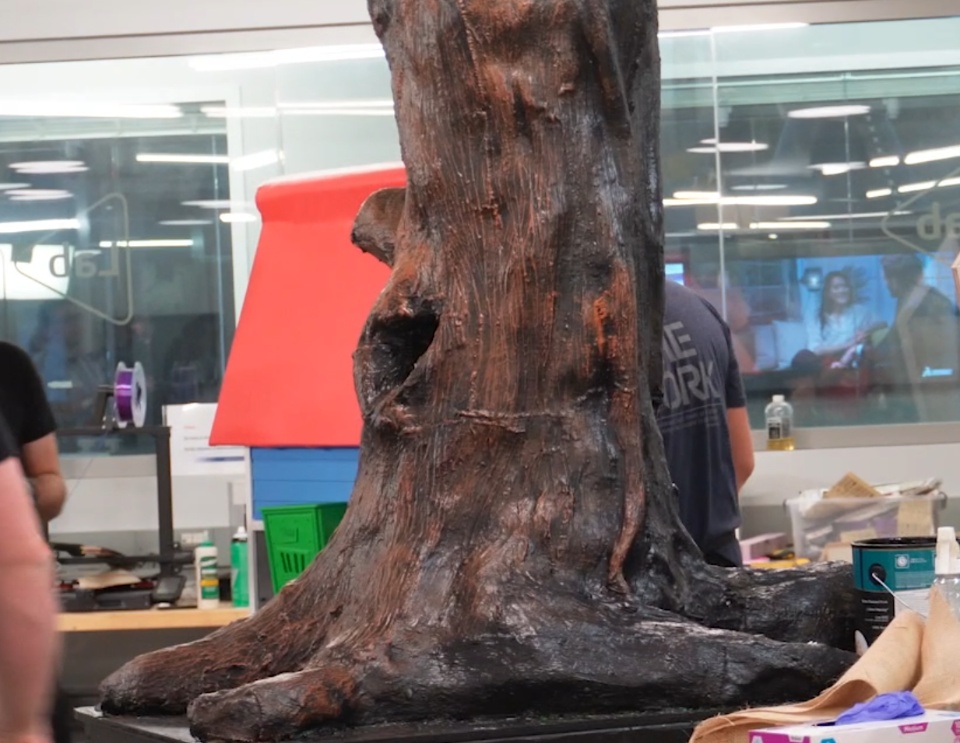

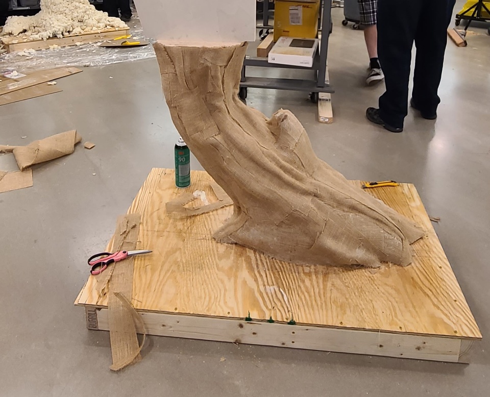

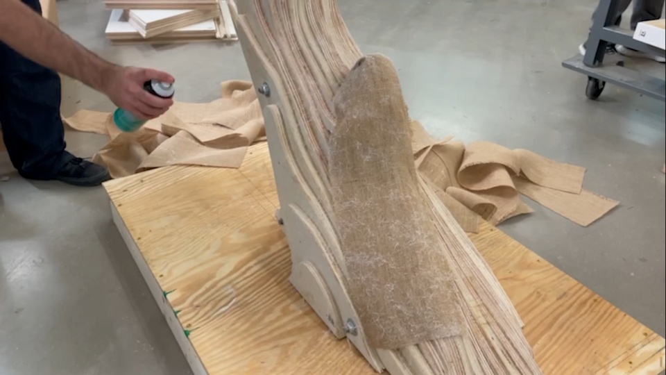

The layered plywood was transformed into a lifelike tree by Luke. He guided the team to wrap the wood in burlap (held in place by spray adhesive) and then painted on several layers of Jesmonite to build up the texture of the bark.
A dark base coat of paint, followed by a lighter, dry-brushed layer brought the tree to life!

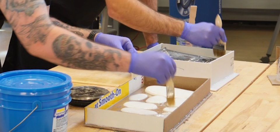

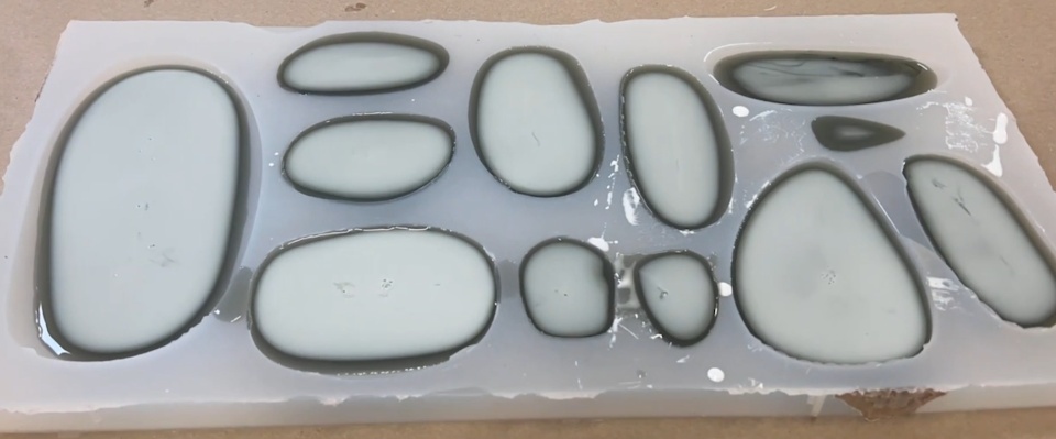

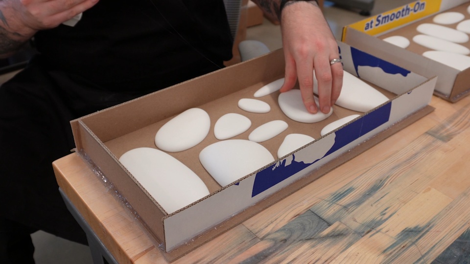

Kirby was in charge of molding all of the little details that add a ton of charm to the build. He made silicone molds around 3D prints of rocks, door knobs, and a furnace, and then used those molds to repeatedly cast sets for a total of three Little Lending Libraries.

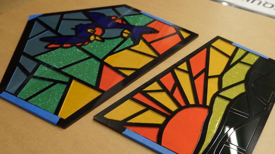

Chinloo focused on building the remarkable stained glass for the doors. She extracted DXF files of the artwork from SOLIDWORKS and used a laser cutter to make the pieces out of 1/8 inch (3mm) acrylic. Check out the full video links below to see an alternative way to make stained glass without a laser cutter.
