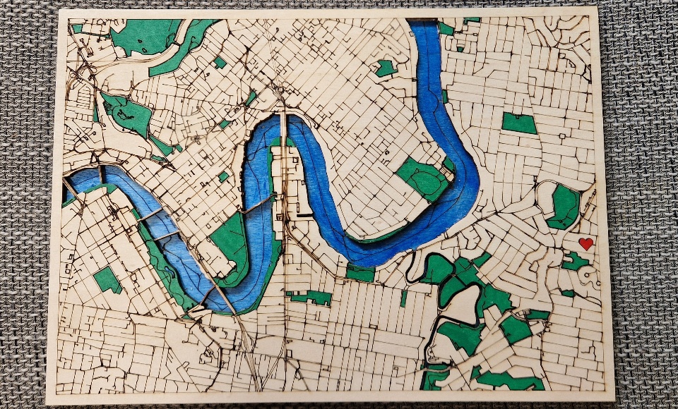

Finished product first

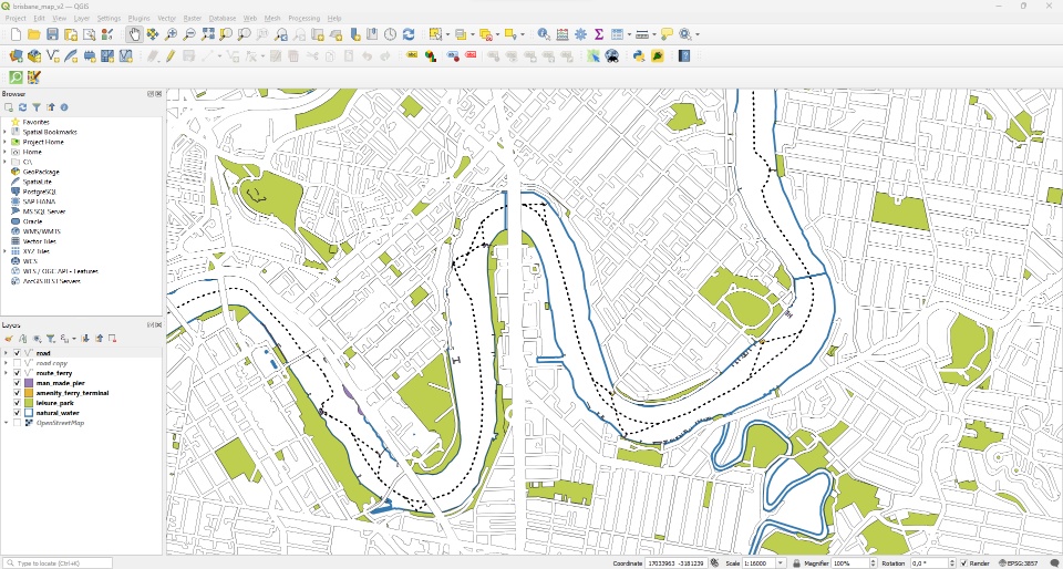

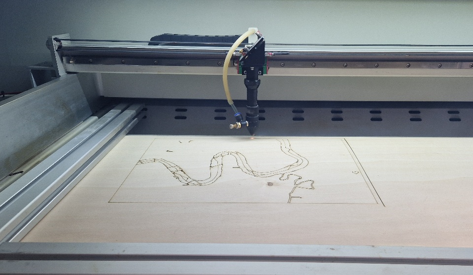

Data was sourced from qGIS. Splitting out what I needed into layers took some practice but made it easier to bring into the laser cutting software
The lower layer was just an outline of the river (so I know where to paint)
Upper layer was the street layout with the river and parks cut through

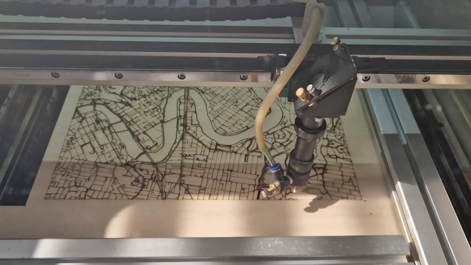

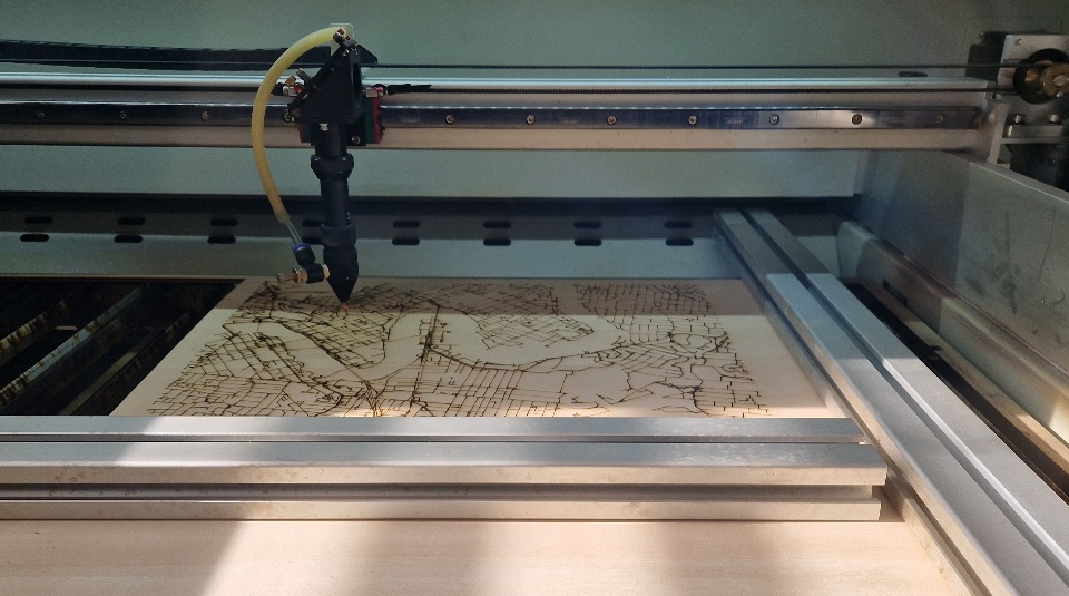

Machine hard at work

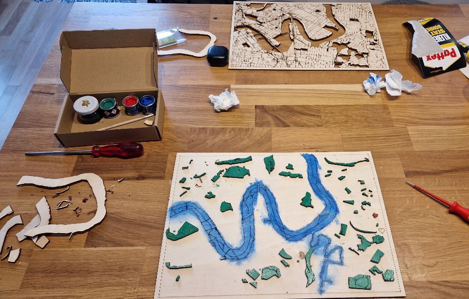

Koncking out the tiny parks and river took some time. Then some enamel paint was added

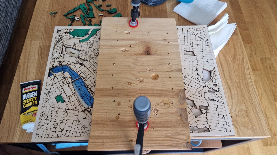

Final product glued together and was clamped over the weekend
