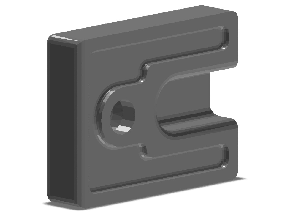

Removing the native adapter of the lamp and taking some measurements to create the adapter in Catia was rather easy

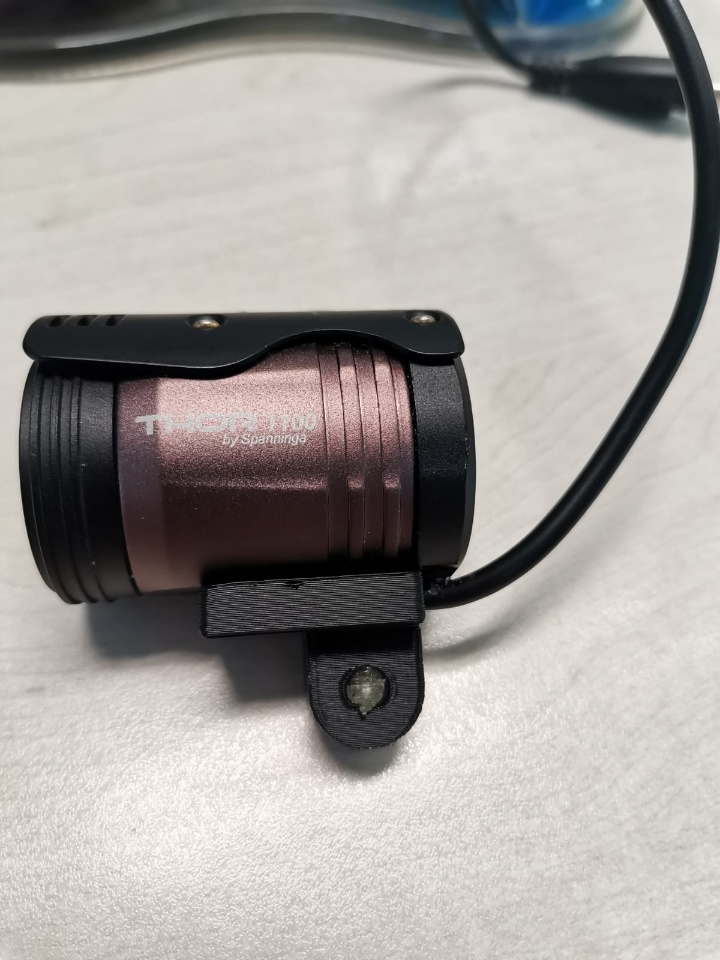

25 minutes of print later, it was time to confirm it was fitting perfectly on the lamp

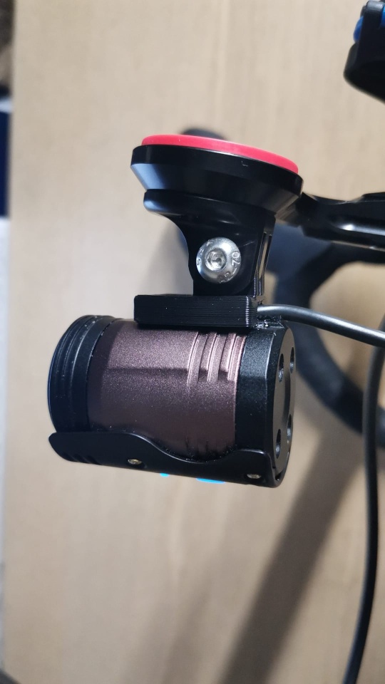

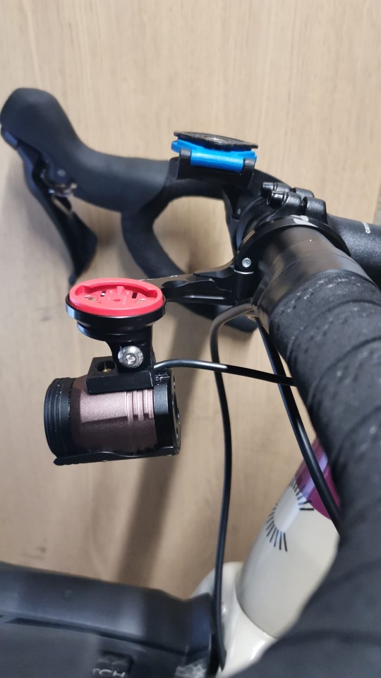

One night of bath to remove PVA, time to screw it on the KEdge:
That was a no brainer and demonstrates how having some CAD basics, and the opportunity to print something, can save time and money on such lack of standards across brands.
