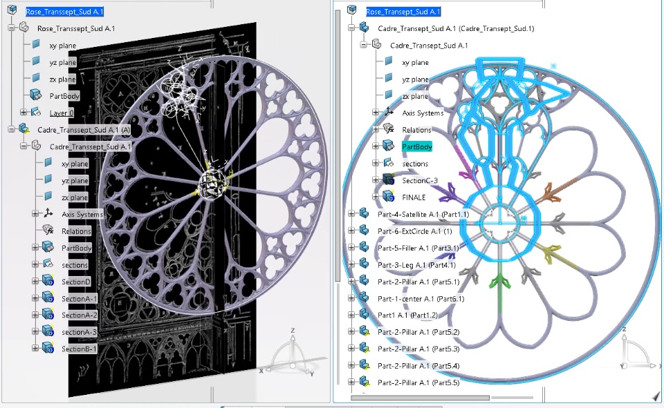

For love of ancient architecture I created a ciment model of the Cathedral's Rose, I hope you'll find it inspiring :) !

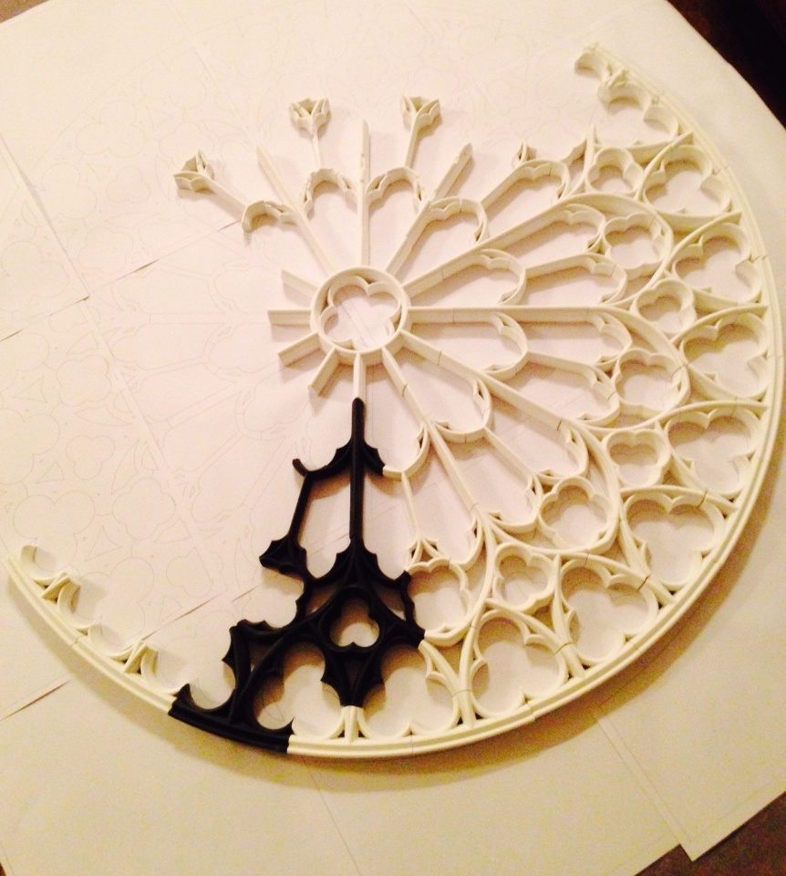

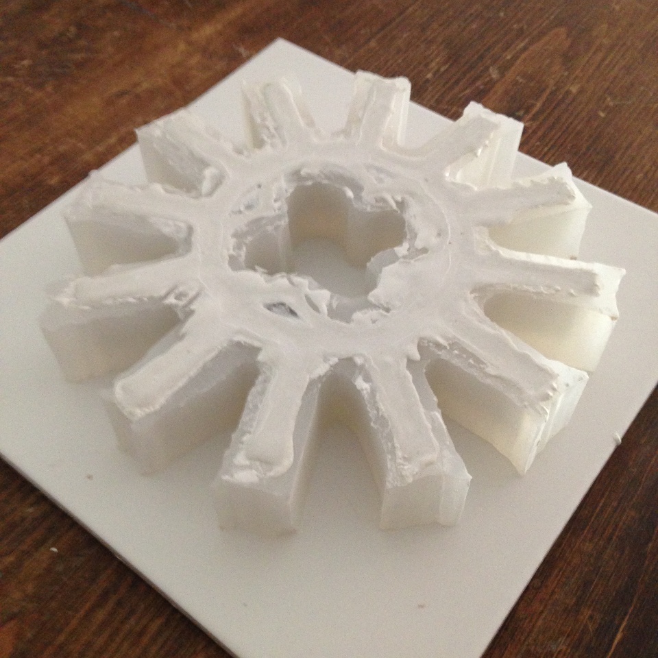

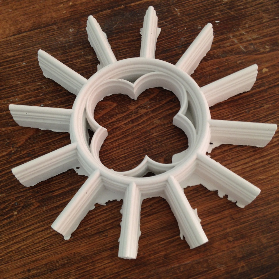

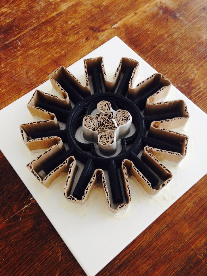

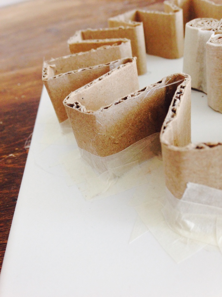

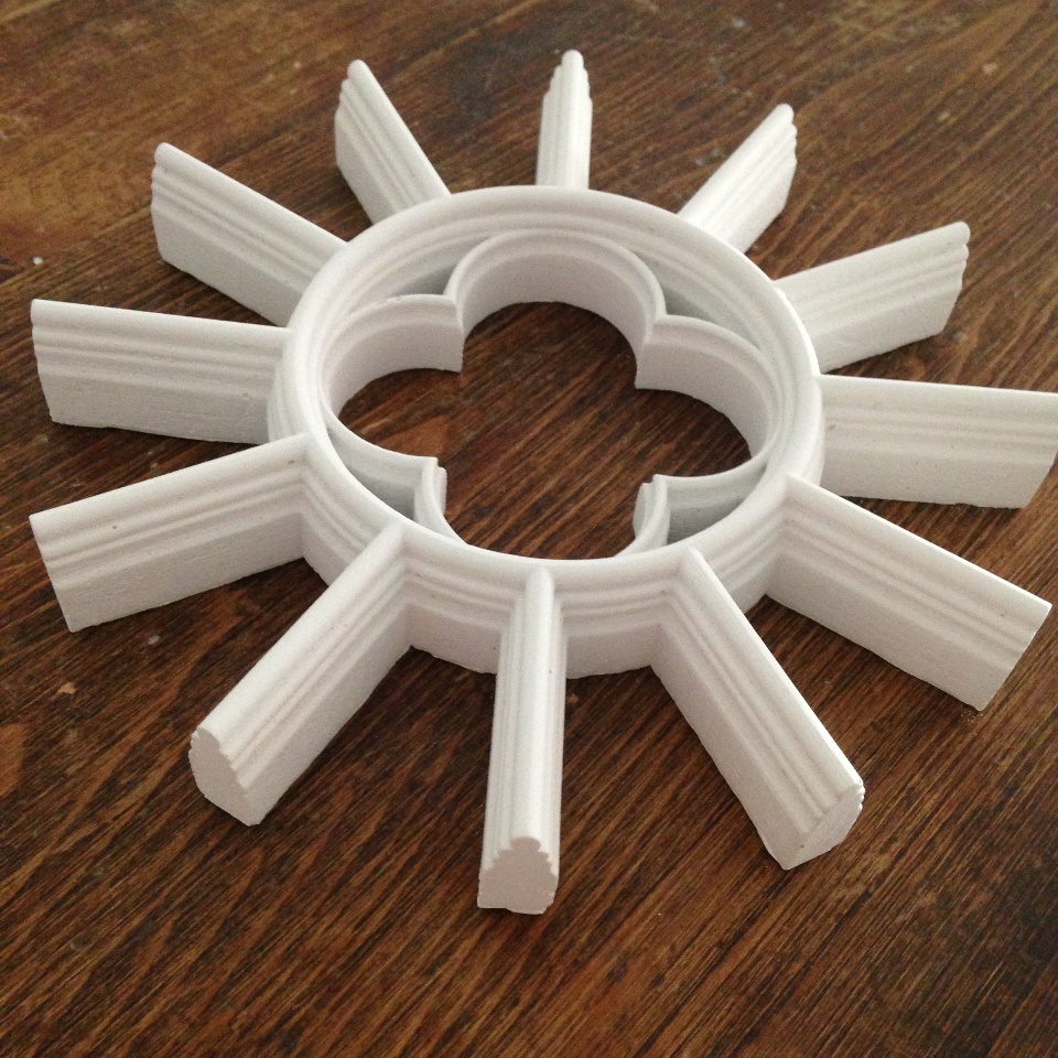

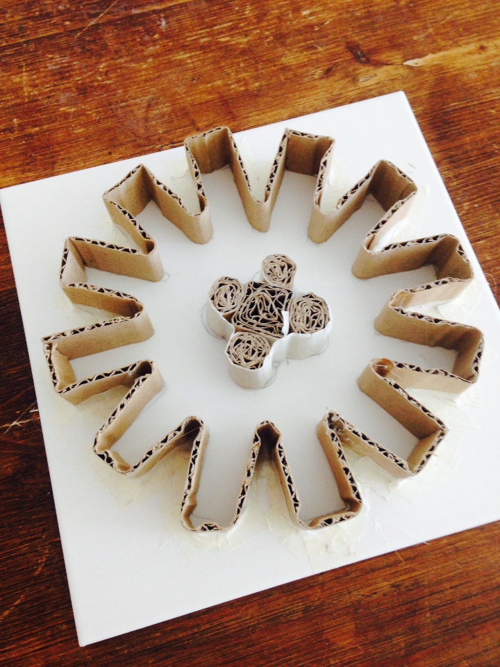

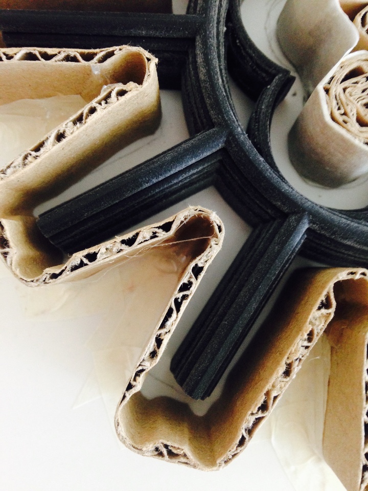

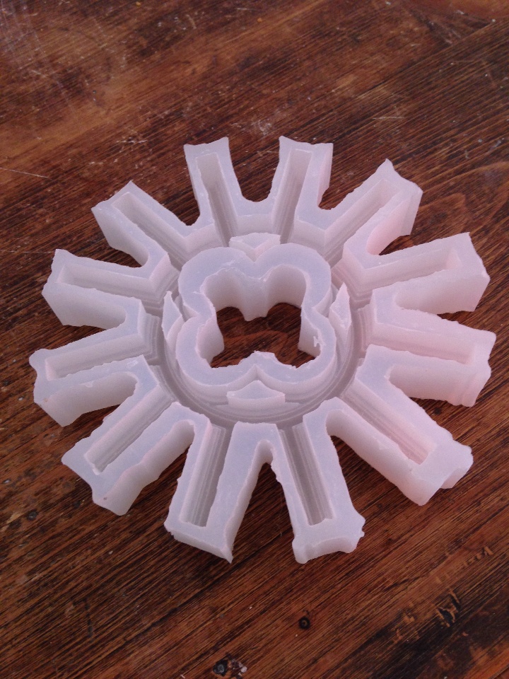

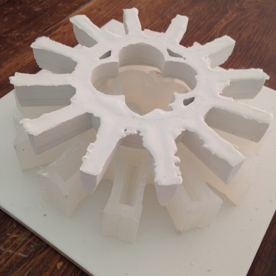

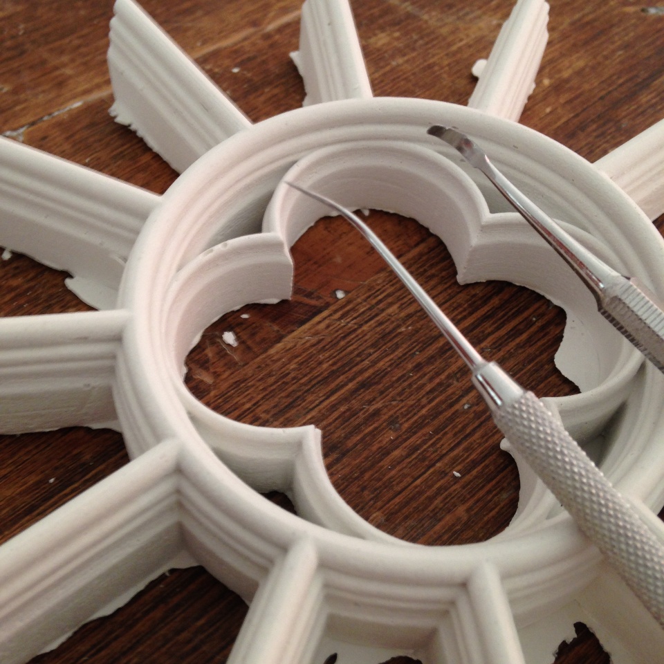

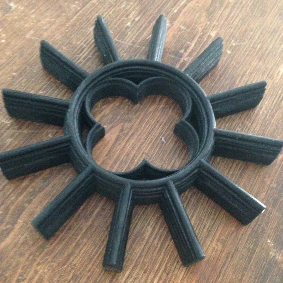

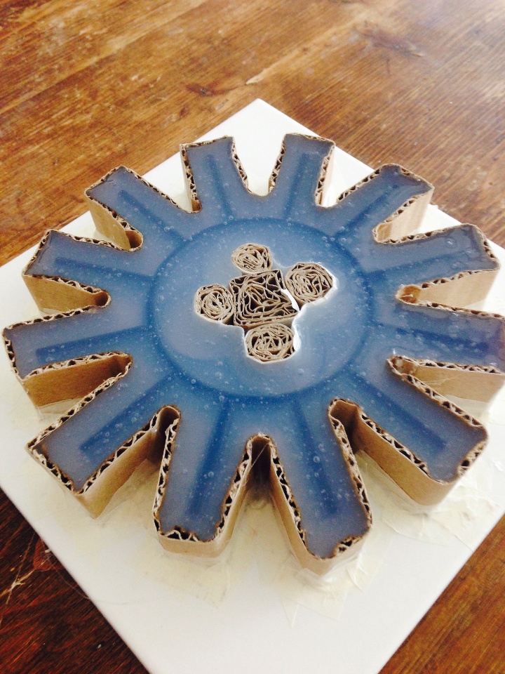

Original is made of limestone (CaCO3), so I used the 3DPrinted models to make silicon molds and I used white cement which has a good touching feeling, (and costs only 3 Euro/kg)
To reproduce the effect of stone assembly I cut the rose is different parts assembled in circular pattern.
And to make it stand vertically, I glued magnets on parts so they can be easily placed on a metal panel.
To improve the mechanical properties of ciment, I use plastifier (ref : "Superplastifiant béton et mortier DELTAPRO 300 ml(Code EAN : 3306940056358)

mold: few hours for each

To complete the overall assembly, I needed 12 sets of 6 parts, plus central one
I created one more set to have spare parts in case of accident...
