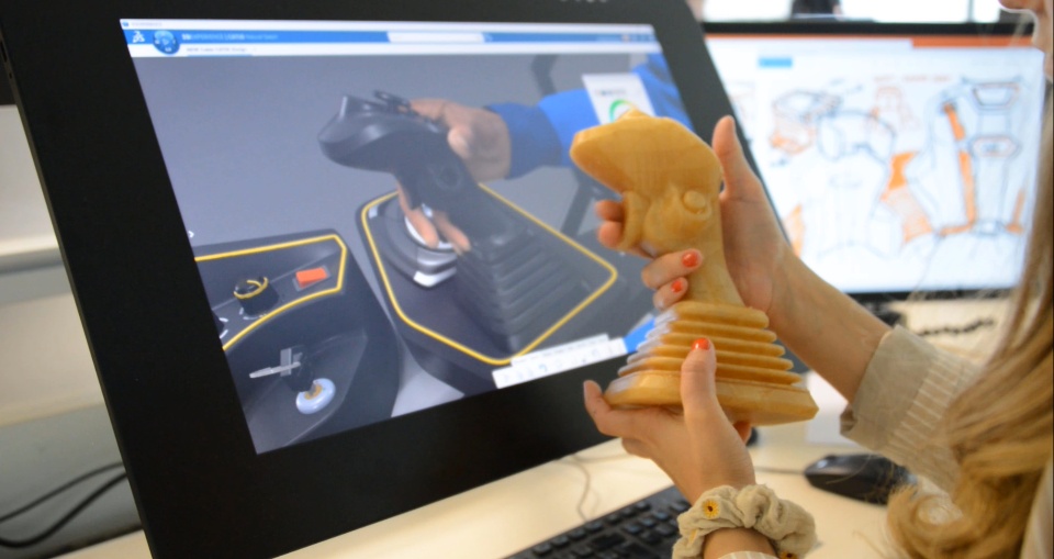

So I went to the FabLab @ Velizy Campus, and I received some help from @RS ​​​​​​​to identify the best 3Dprinter & 3DPrint material to create a first prototype : I only needed the external shape without any material appearance, to only concentrate on the shape itself and judge it.

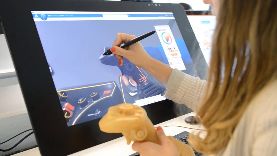

after the prototype were printed, I ran a couple of user test in my team to gather feedbacks on the comfort and usability of the actual joystick. Then I annotated the original 3D model for further shape edition with CATIA Natural Sketch.

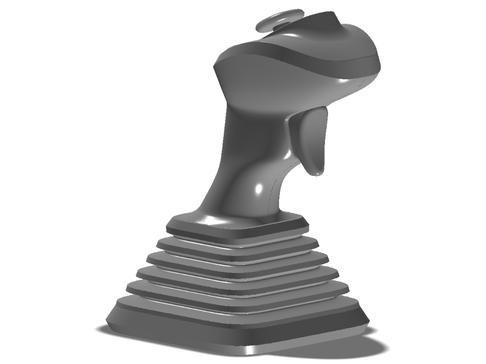

After that, I went back to clay modeling tools with CATIA Imagine&Shape to reshape the joystic, integrating all the feedbacks and issues I gathered. here the version 1 on the left, and the version 2 on the right.
