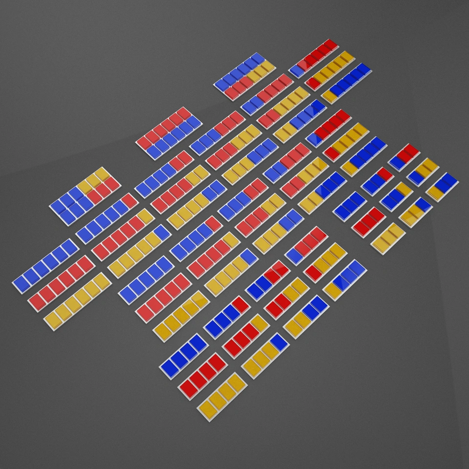

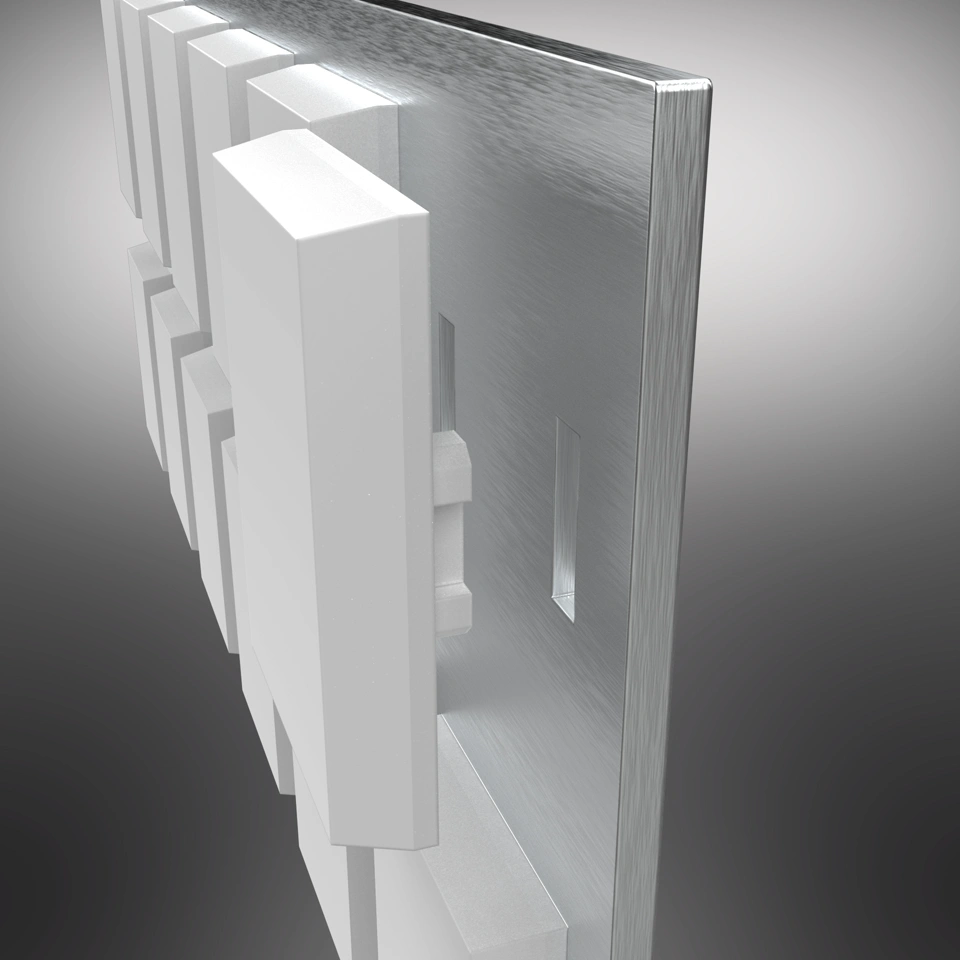

For these badges particularly the 6x2 badge there are 12 lenses, and each lense requires cutting on both sides before it can be bonded to the base plate, meaning thats 24 cut operations, which by hand with a stanley cutter alone would be incredibly time consuming but also we designed in 1.5mm of protrusion so it could locate into the base plate, meaning every single badge is repeatible & perfectly aligned, it also means we could build stock for all the variants and store the lenses to be added after and we can leaverage the power or batch production as somone making badge bases for 6 hours is more efficient than making them one by one.
Our Jig is 3D printed and running as we speak on our H2D to prototype before our kit of stock parts arrives.
