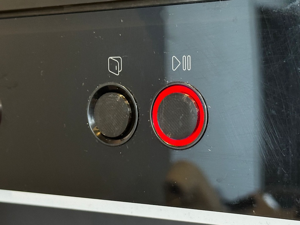

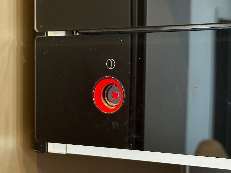

It’s the short story about a beautiful oven on which several control knobs broke.
Impossible to use this oven without the help of a very special tool: a hairpin! Not very practical...

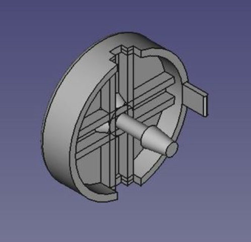

As the original part was no longer available, I wondered if our famous FabLab could scan the only copy I had left and print it in 3D?
Luckily, I even found the 3D model of this button on the web. It then became "ready to print" : https://www.mito3d.com/fr/3d-models/print-details/3165665/bosch-Mikrowelle-Taste-00617049-K%C3%BCche-E
And, after a quick trip to the FabLab, the result was perfect, ready to use and so much more practical than a hairpin ;-)
