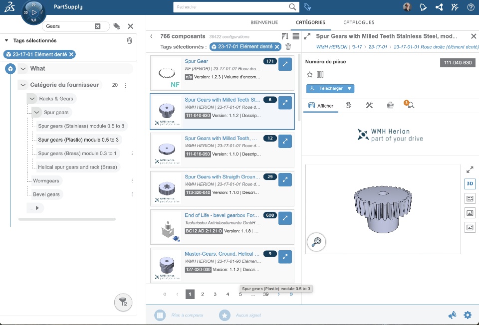

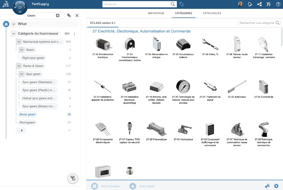

1 minute to Access Part catalog and search for "Gears"
Then choose the best shape, and the right diameter , in my case 40 mm.

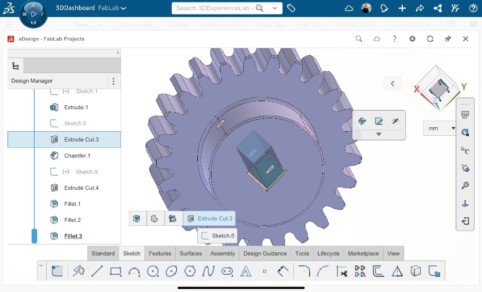

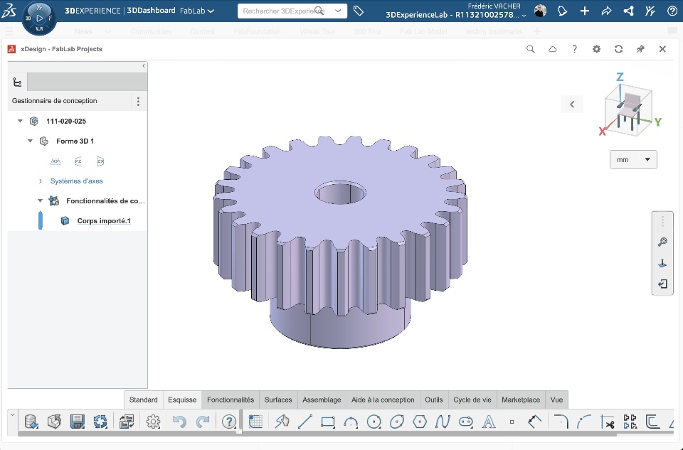

1 minute to open your favorite Solidworks XDesign, the easy web based app for designer and import the Gear part you selected :

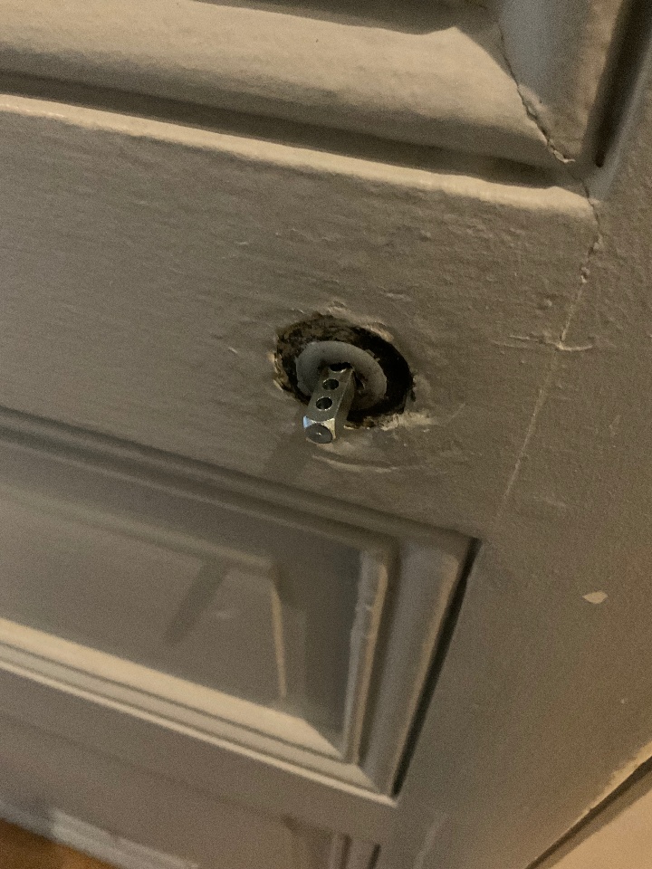

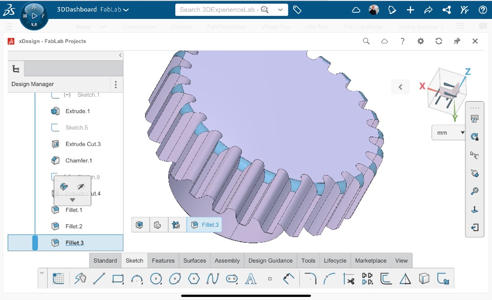

3 minutes to make your design according to your door specifications :
  • Here a square cut of 7 mm
  • a fillet to smooth the grip,
  • a very small hole to fix the handle...
on an iPad, its pretty strait forward, that's it !

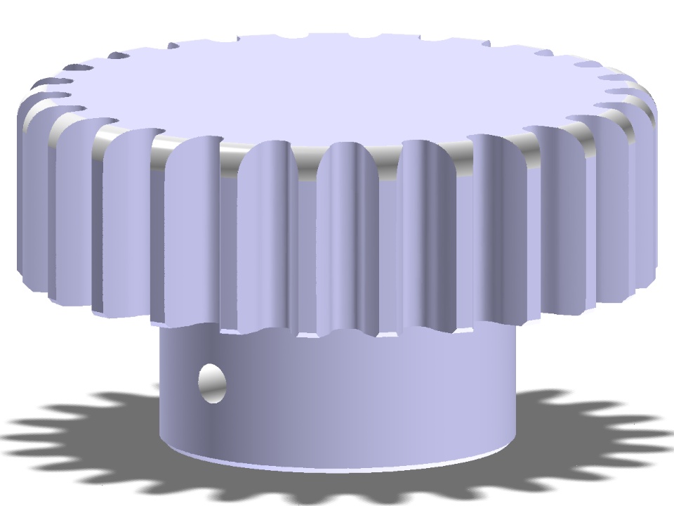

Et voila, in 3D !

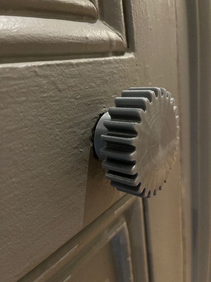

+ 2 hours after for Fab part, thanks @CC for 3Dprinting on a Ultimaker l 🤩
Here is the result ! This is really only for geeks 😉
