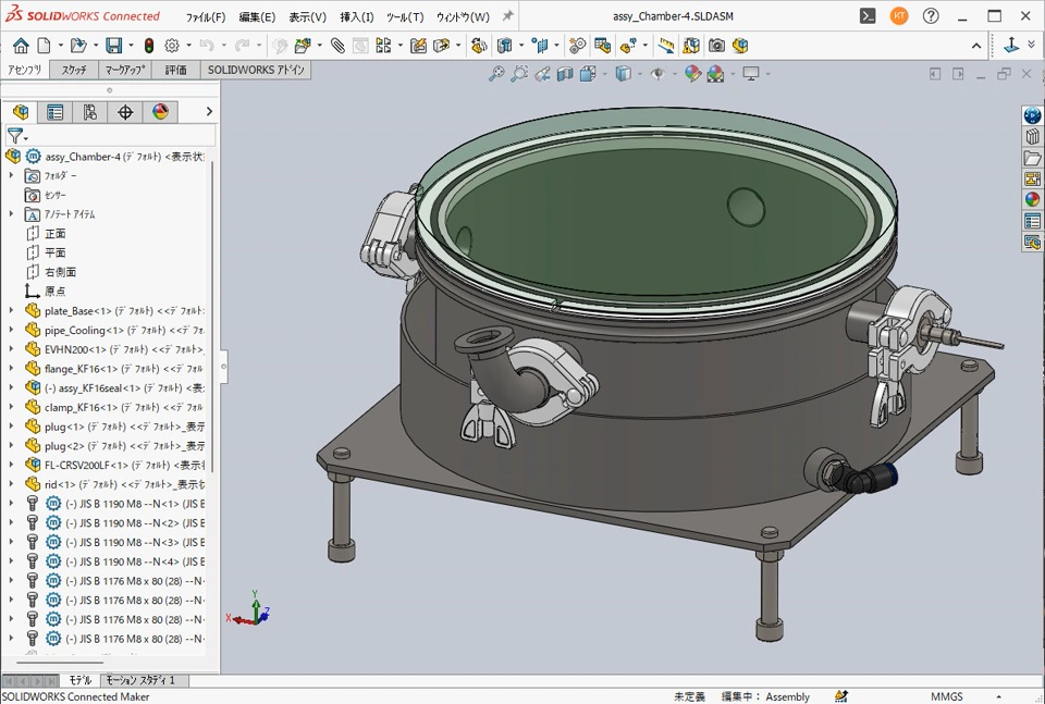

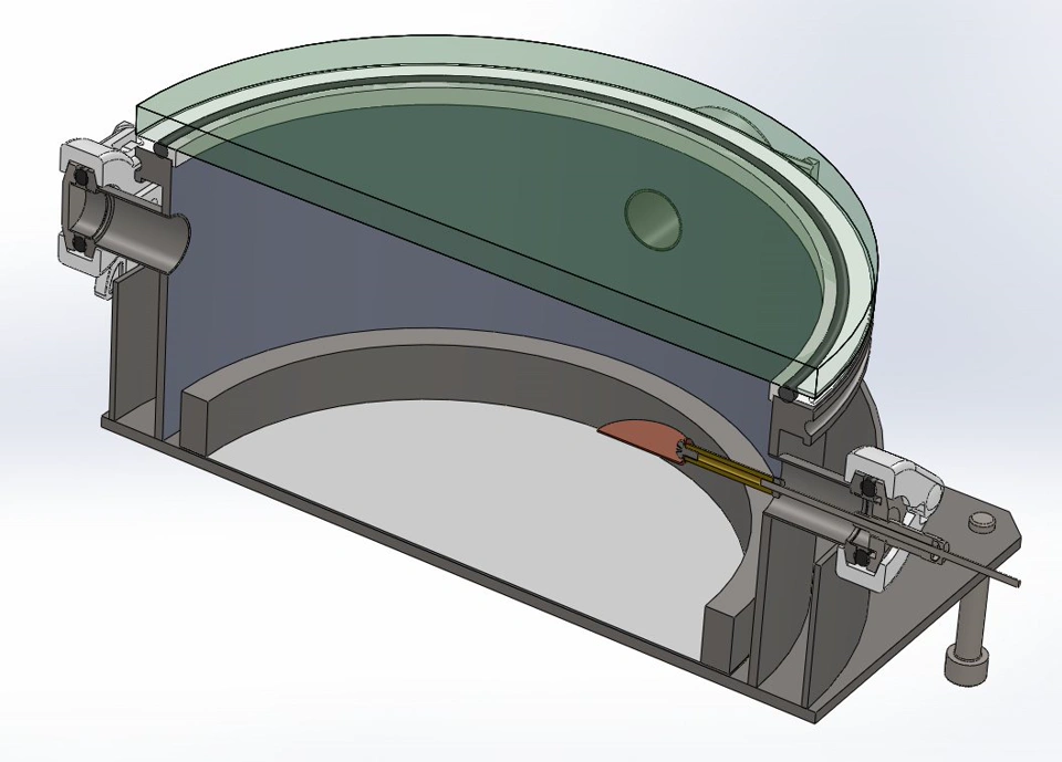

This led me to explore sputtering technology. I determined that high-quality sputtered silver requires a dedicated vacuum chamber capable of containing plasma under high vacuum.

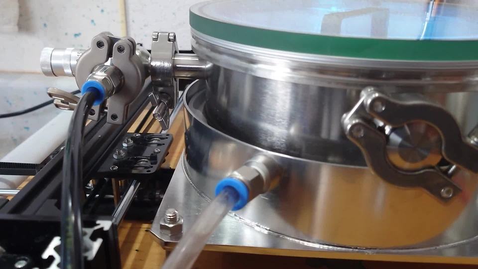

Consequently, I designed a chamber using SolidWorks Connected and collaborated with a Chinese vacuum equipment manufacturer to fabricate it. The video demonstrates the resulting apparatus.

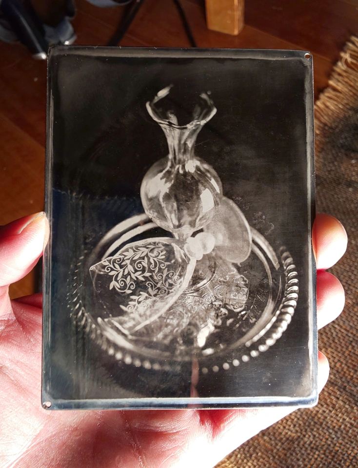

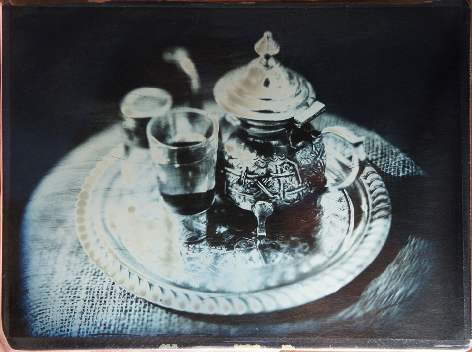

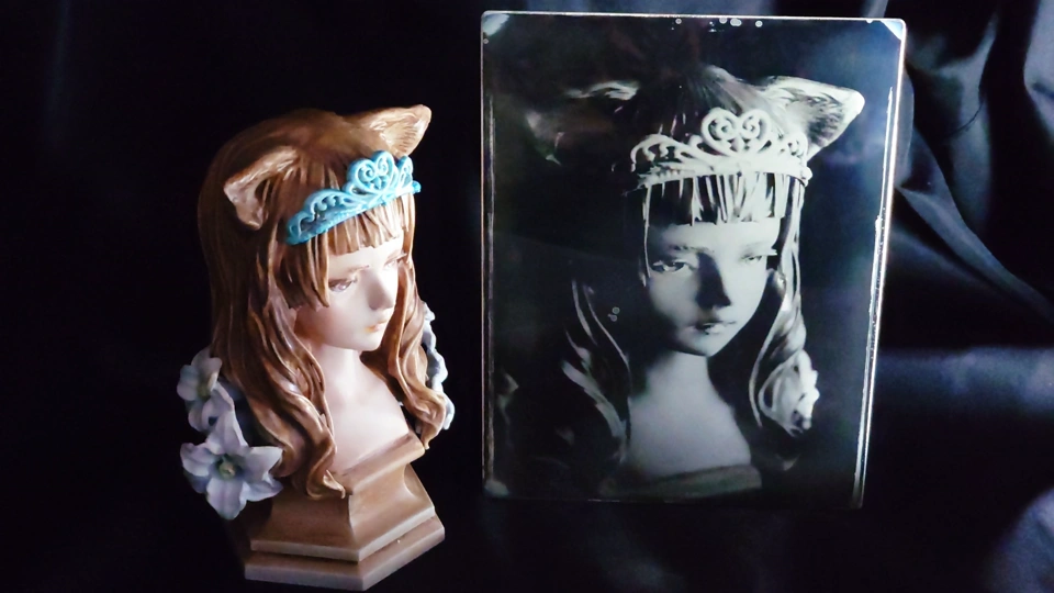

Presented also are some daguerreotypes created using the fabricated silver plates.
