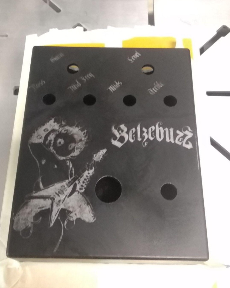

So I started to apply the process on an enclosure, in aluminum.
After covering the enclosure with a thin layer of paint, I have removed the part to be etched with the laser tool of the Zmorph.

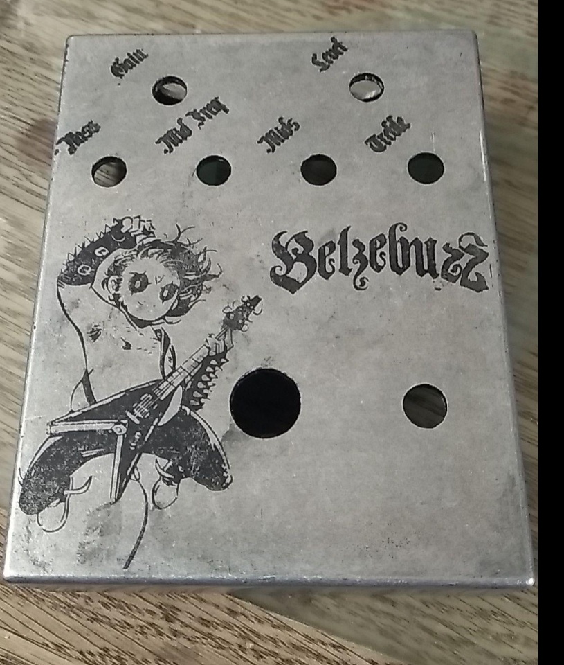

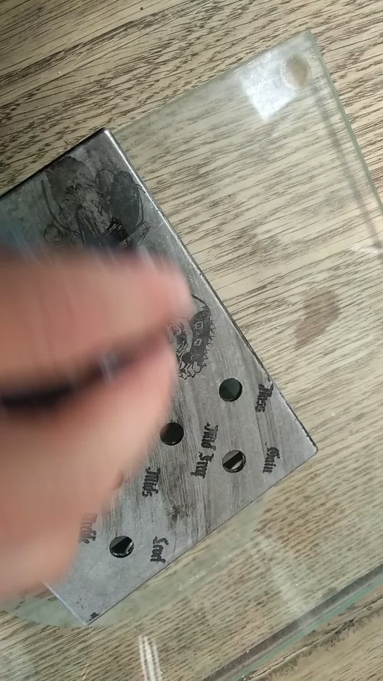

After the etching, it's time to reveal:
And the result

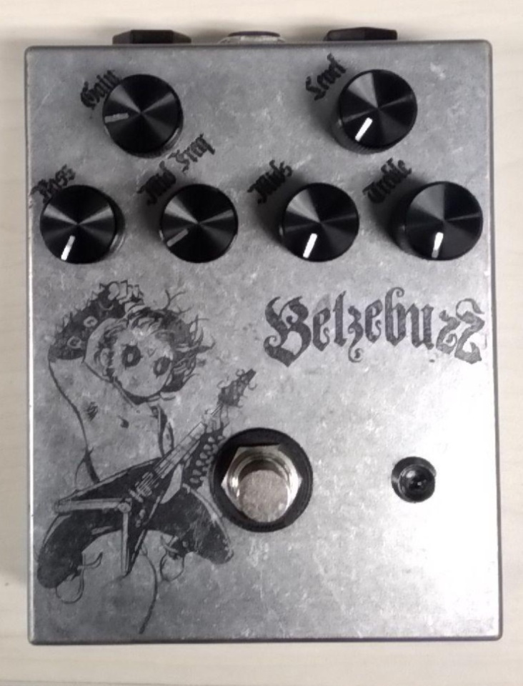

After adding the pots and so on, it is time to add a black PLA washer instead of the standard white one
