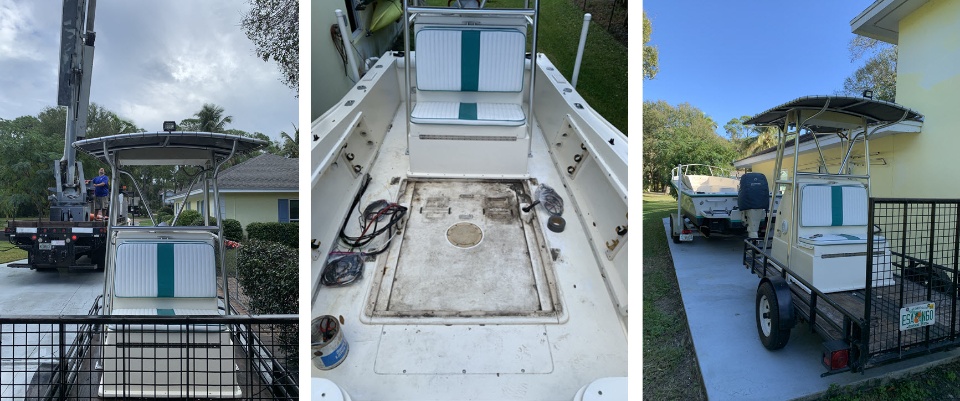

One flaw in the design of my old Mako is the weak "hole shot" ability of the boat as her CG is too far aft combined with a dive platform extension. To non-boaters, hole shot is the ability to quickly lift the stern of the boat up as the boat accelerates on to a plane. The 143 gallon fuel tank ran about 8' fore and aft so I figured the solution was switch to 2 tanks so I could leave the the rear tank empty most of the time moving the CG far forward. So project started up with a little bit of "disassembly required". It sure was handy to have a buddy with a crane to lift off the console and deck plate...

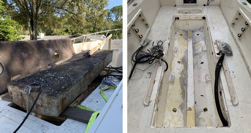

Then pop out the old tank and prep the hull for something better!

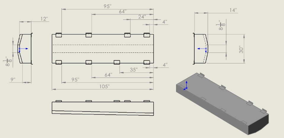

Now the hard part - the old tank tapered vertically from front to back as does the large hole it came out of so not just a simple coffin shape to slice into pieces like a loaf of bread. Time to fire up the CAD system and do some thinking. First model the original tank. I figured this would give me that "master model" I would need to fit the new double tanks into the same volumetric space...

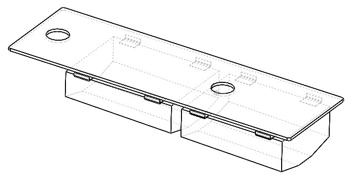

Then, I just sliced and diced the main volume into 2 new tank derivatives which preserved the weird shape. I had to also model the deck cover plate as the new dual tank system meant I will have to cut and fiberglass in new inspection covers. Just some more "scope creep" most of you are familiar with...
I then whipped up the needed drawings and headed off to my friendly neighborhood fuel tank builder with checkbook in hand. I'll blog again once I get my fancy new tanks home!
