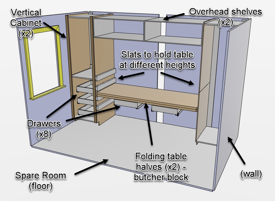

First Design
If you remember from my sketch in my last post, I was going to have a tall cabinet on both sides of the back wall with a long table in-between. There would be deep shelves along the top for all types of storage.
I started out by measuring the overall room and modeling it in xDesign. I would then take advantage of the single modelling environment by creating each panel in context of the room assembly and then use the make component command for each. Or, sometimes I would instead insert a new component and then create the features in the activated sub-component. Next, I would create an assembly pattern for these various panels but then I learned that the panels are not constrained in the assembly the same way as the seed object. I did not like having the patterned instances draggable, so I instead duplicated the components and then mated in place with a rigid joint. I would have expected the pattern instances to share the same DOF as the seed component, so if the seed was fixed, the pattern instances would also be fixed.
When creating the mates for each of these components, I try to mate them to the same other component so each subsequent mate is part of the same joint. I find it easier to manage assemblies when I keep the total number of joints to a minimum. I thought this project would be a good case for Smart Mates but when I tried it, the smart mate would not always mate to the same other component in order to create the mates in the same joint. Instead it would create multiple joints.
In the first design shown above, I made each end cabinet the full height of the room. But then I decided to make the shelves go across the full length of the wall instead, as I thought it was a better use of the space. In the first design I considered affixing 2 of the drawers to the underside of the table. I did not like the look of this and it would make the table heavier to lift to the various heights.

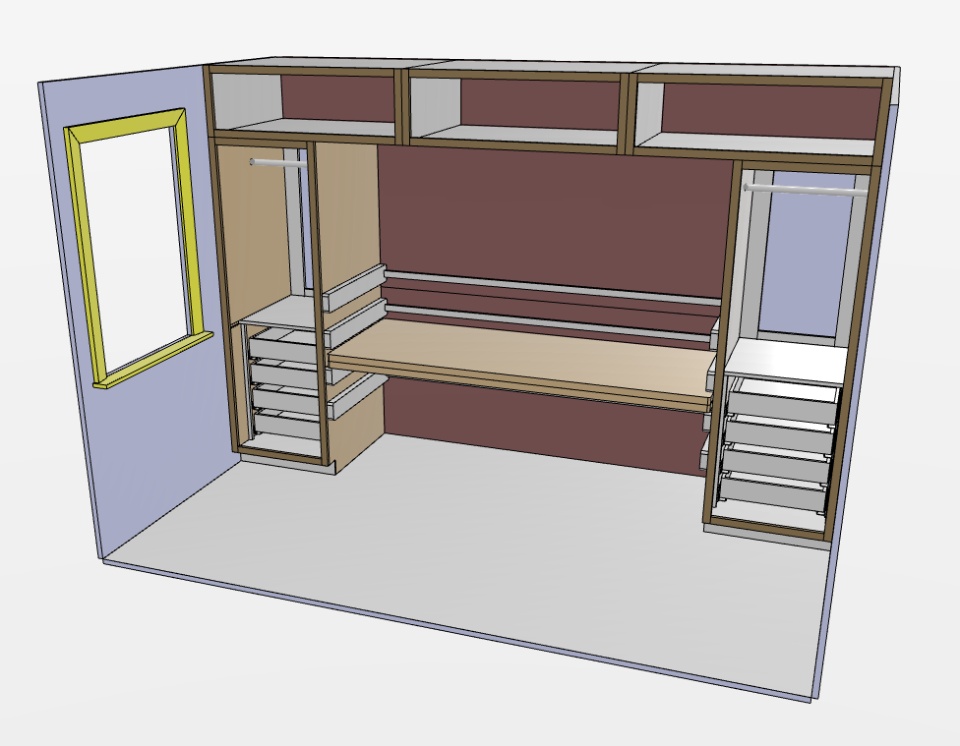

Final Design
In my second design I made 3 larger shelves span the length of the back wall. The 2 end cabinets are shorter but proper hanger height. I stuffed 4 drawers into the bottom of each cabinet. Currently, I have 4 different heights for the table.
Going from the first design to the second was a fairly easy change in xDesign. I used the same components and changed a few of their sizes and spacing. I added trim to the openings of each cabinet and in the future I hope to make doors for them. Lastly, I added some horizontal rails to the back wall inline with the 4 table stops. These rails can be use to prop up my son's baseball cards, pictures or other small trinkets.

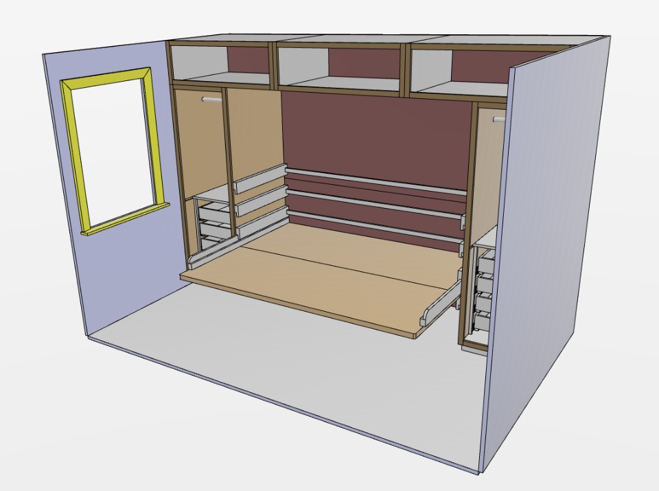

Foldout bed
Shown here is the table lowered and folded out in the lowest position. I added 2 slide in bars that will lock the table into this position and not let it tip forward. I will need to test this later to see how strong it is and if it can truly support the weight a person laying on it or if I need to design some sort of leg/support for underneath.

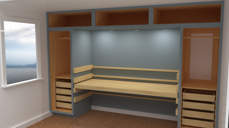

Styling
I was able to export the cad data as a read-only 3DXML and then import it into SolidWorks Visualize. I am using the connected version but for some reason it will not read native xDesign data.
I rendered this to get a look at the possible materials, colors and lighting. I will build the cabinets out of 3/4" plywood and face the natural woodgrain to the inside of the cabinets. The outside would be painted a steel grey of some kind, final color tbd. The table tops will be butcher block and will use solid wood for the table stops and card rails. It was fun to render this project in visualize and I can usually find all the materials I need. I also used one of the default back plates which creates a much nicer view out of my window!
