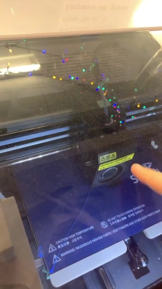

Zen Sugiyama helped me throughout the entire process in the Fab Lab, explaining step-by-step how to properly use the software and printing hardware. Once uploading the .STL file into the printing software, we flattened the file so that it would print securely on its side.
5. A Few Go’s at Printing
Because the structure we were printing was so small, the printed result came out as a ball of plastic on the first two tries. Determined to print the item, we made adjustments to the printing settings. On the third try, we found that widening the ‘raft’, which is the material connecting to the plate of the printer to the printed object, allowed us to properly print the ring.
6. Complete
I was able to remove the raft from the ring and the printed item was luckily able to fit on my finger. As an outcome, I successfully 3D print a ring with the help of SIMULIA’s awesome Engineers & access to the Fab Lab!
