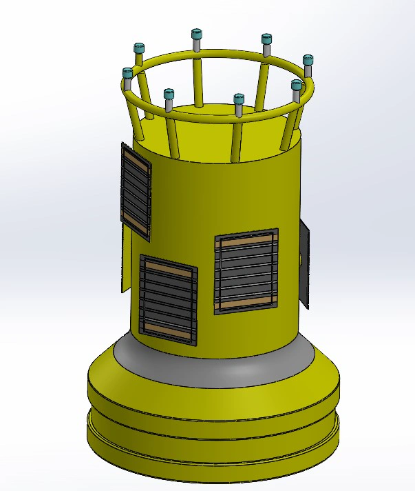

My entry for the Fibonacci Design Challenge: A Weather Buoy powered by perovskite solar cells.
Note: This was my first time using xStudio, and for some reason, the model didn’t display the circular ring after importing. I tried multiple times but couldn’t resolve the issue. I apologize for the incomplete entry with xStudio and appreciate the opportunity to participate with the limited time I had.

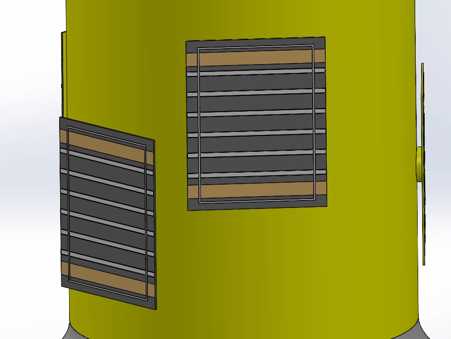

My SOLIDWORKS model includes perovskite solar cells, which are considered a game changer in renewable energy. Unlike traditional silicon-based solar cells, perovskite cells are:
  • Lightweight and flexible, making them adaptable to various surfaces.
  • Highly efficient, even under low-light or diffuse light conditions.
  • Cost-effective, due to simpler manufacturing processes compared to silicon cells.

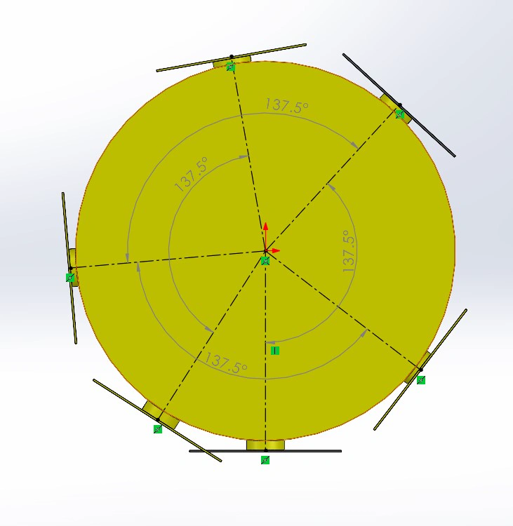

  • SolidWorks Features: Sketch tools, circular pattern, and manual placement of solar cells following the Fibonacci golden ratio angle (137.5°).
  • Fibonacci Sequence: Applied in vertical offsets and rotational placement of solar cells for optimized sunlight capture and aesthetic design.

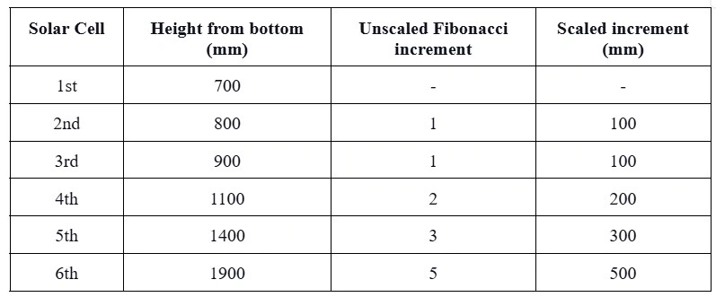

Vertical Offsets for Solar Cells
The vertical placement of the solar cells was based on the Fibonacci sequence, scaled by a factor of 100mm for practical implementation. The unscaled Fibonacci numbers used were: 1, 1, 2, 3, 5, 8. Each number represents the increment between successive solar cells.
The table below shows the calculated heights of the six solar cells from the bottom of the cylinder:

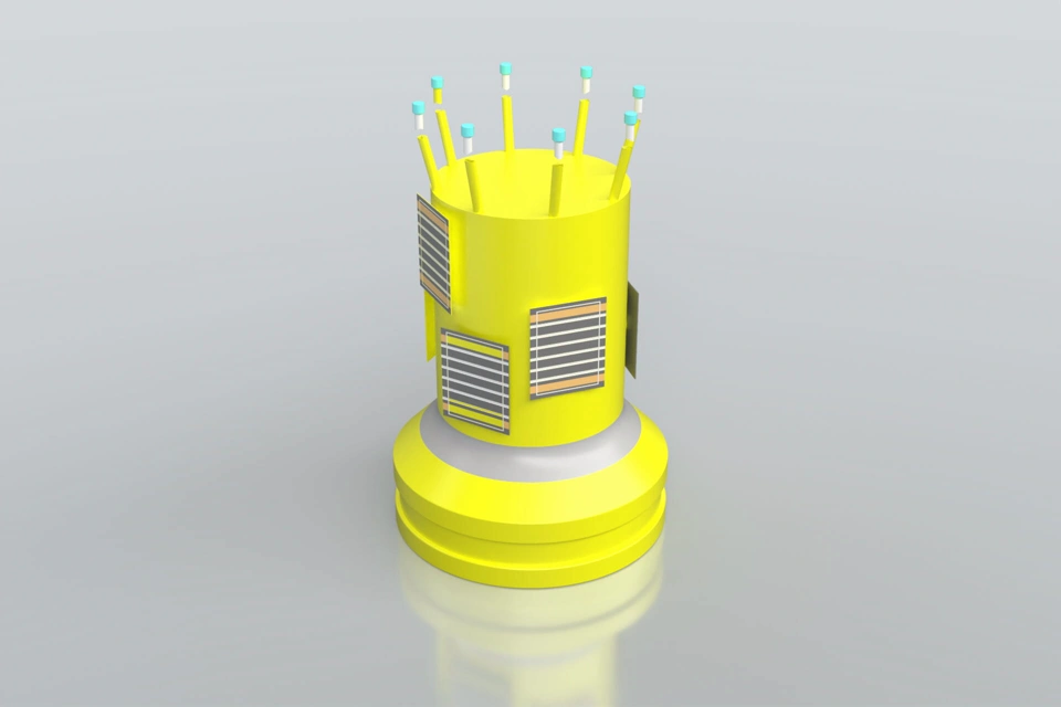

And here's the final render in xStudio (apologies again for the unacceptable entry). I wish I could dedicate more time to such an amazing challenge.
