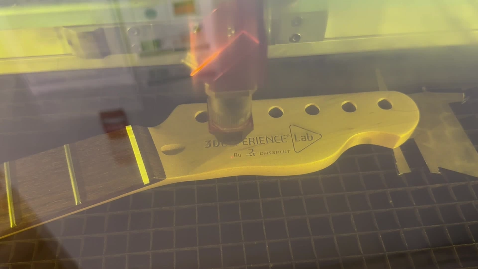

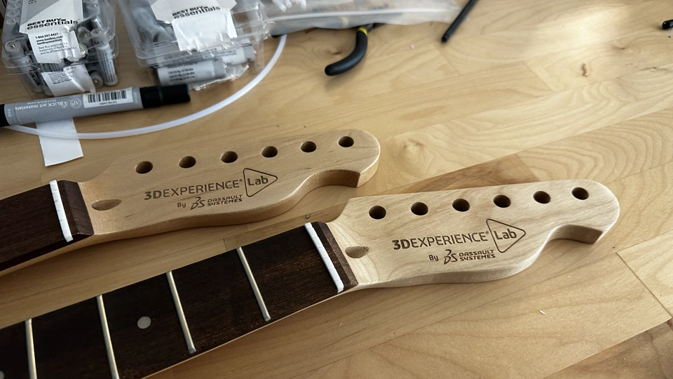

It's not always straight forward to engrave on existing finished woodstock. You can't guarantee the saturation, coloration, the positioning, nor the flatness. So I did some test engravings on hidden parts of the guitar so that I could lock-in the perfect power, speed, and frequency of the laser. After a few tests and a strategically placed shim, I was able to get it done!
