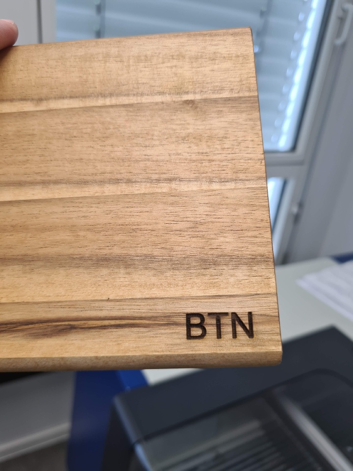

Acacia is a wood often appearing in mid-range furniture like Ikea so I did some engraving tests. Please note this is not an oiled surface.
| speed | power | result |
| 50 | 20 | very deep and burnt probably would cut through thin board |
| 60 | 10 | NEVER put 10% .. this did not work once on anything |
| 50 | 15 | still pretty deep |
| 70 | 12 | Tiny bit too fast.. makes micro smudging |
| 60 | 11 | thats the second picture .. nice and soft |
| 60 | 12 | first picture.. deep but sharp .. not over burnt |
the 50/15 result :
0
