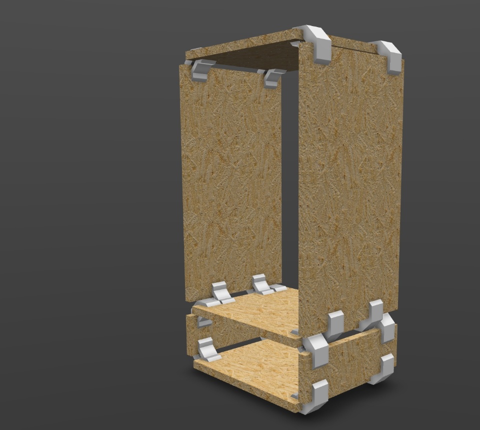

When the connectors arrived I mocked them up in 3D Creator with xDesign to help define the design intent of the desk.

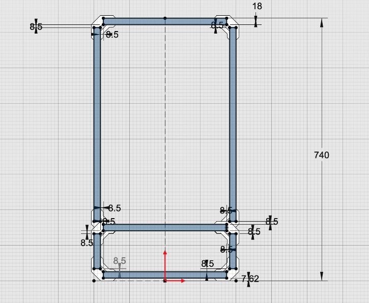

A parametric sketch in xDesign enabled me to define the height, width and depth to fit my existing desk. With that I was able to use the connectors to automatically get the correct sizes for the wood.

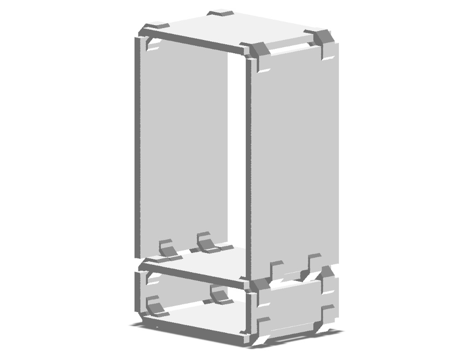

The finished result looked pretty good in xDesign using the new materials!
Here is the 3D model to take a better look at this project!

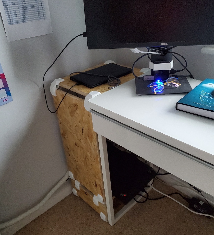

The result of the project is being used right now :) Check out the in situ finished piece:
