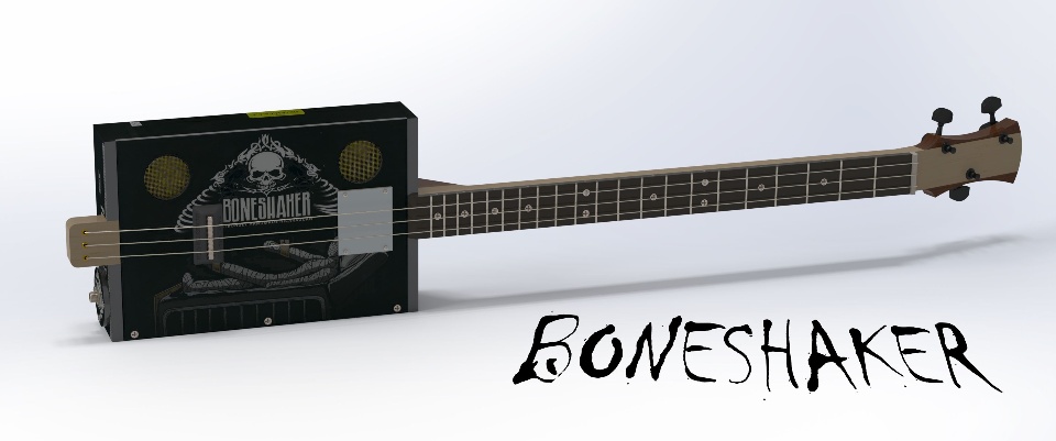

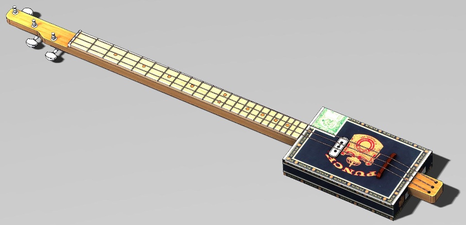

I built the first one about 4 years ago and immediately had to model the basic box and neck so it was easy to visualize and plan out.  Not being a skilled wood worker I try to take my time and understand how to do something before attempting. Woodworking ​​​​​​​

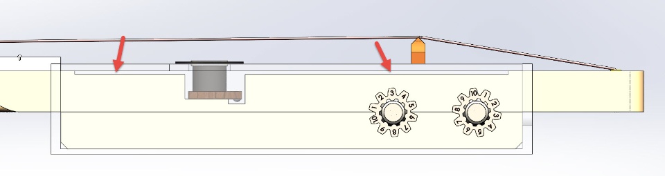

I took the time to scan the faces of the box and apply them as appearances for the rendering.  Notice that I did not model the strings wrapping around the tuners. Why?  Because I didn't have to!  All I really needed was the placement of the neck in the box for the scale I was going to use 25.5"   There needs to be a gap under the box lid for it to resonate and a pocket for the pickup to electrify it, string angle, nut and bridge placement, etc.  Before you know it what seemed easy started to have really looking at the steps of it.

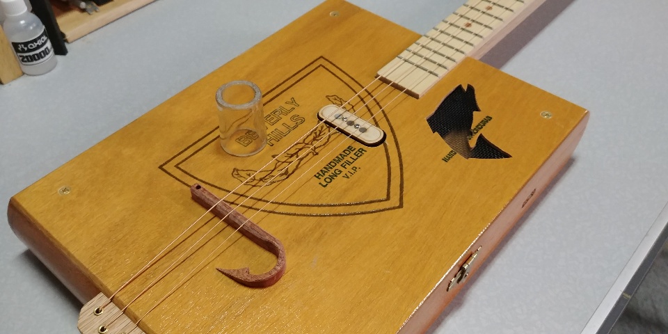

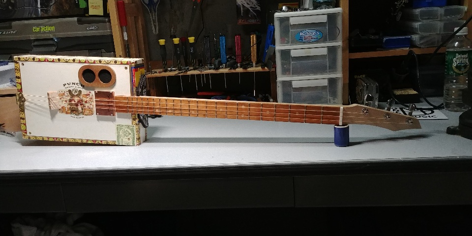

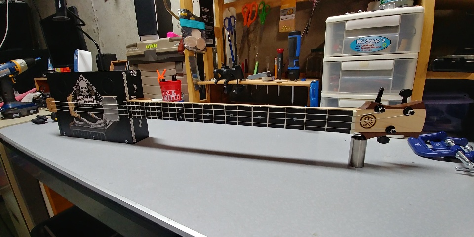

Until the next update here are a few pics of a few I built.  Once you start...you can't stop!
The last pictured guitar even was present at 3DX World in Nashville as part of my presentation on Design Intent....but more on that next time!

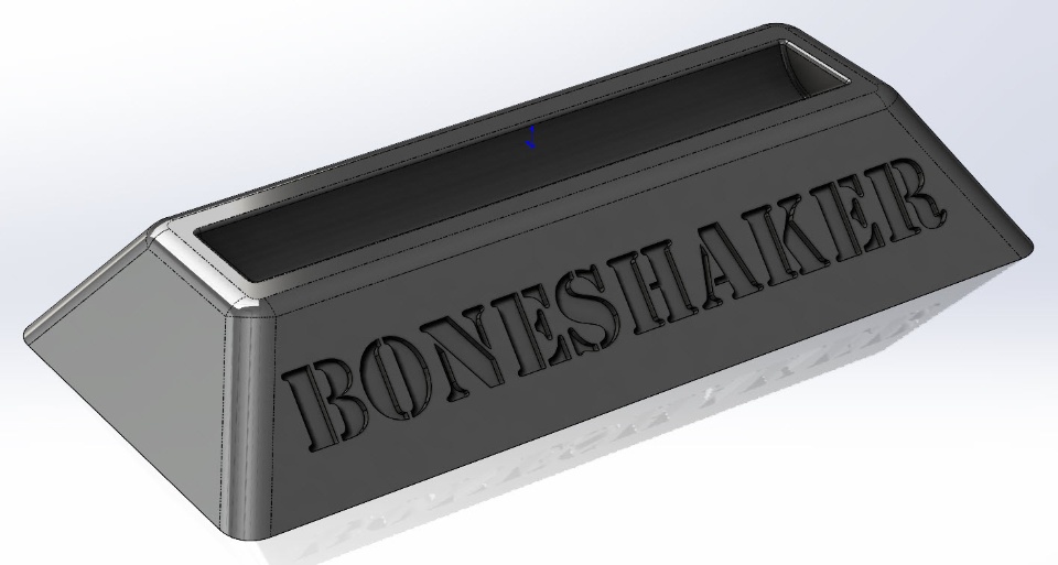

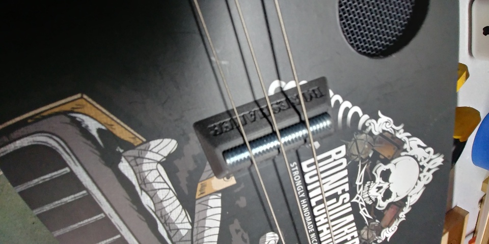

UPDATE #1 - THE BRIDGE.  One of the cool things about a No rules, Do it yourself instrument is that you can pick and choose exactly what you want to try.  Because part of this hobby is to get away from "CAD" and build with tools and by hand I first tried to abandon the CAD aspect...but, like any good SOLIDWORKS junkie I couldn't help but know about the advantages of doing things virtually first.   The bridge is one part I like to change on each build and get creative.   This time I thought it would be cool to 3D print a bridge to hold the cut down thread rod.  It worked surprisingly well!  Carving small pieces of wood by hand is not always easy....but fun.   This was printed on a MarkForge.
A little Visualize quick render....find what has not been modeled yet....
