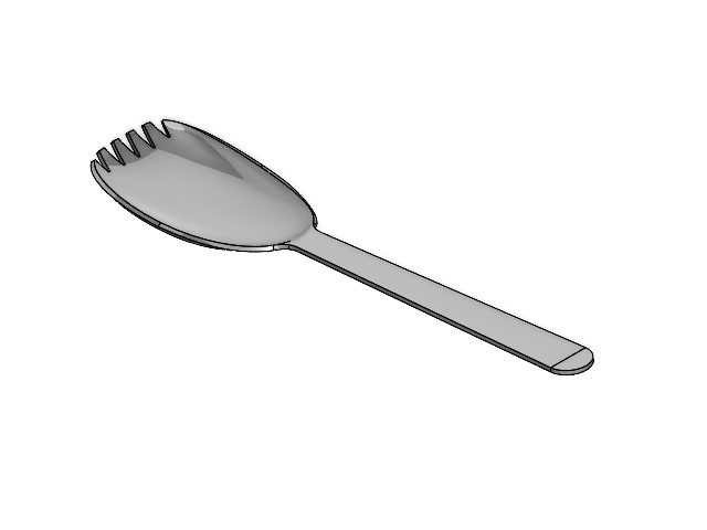

We started by modeling a spoon and a spork in SOLIDWORKS for Makers.

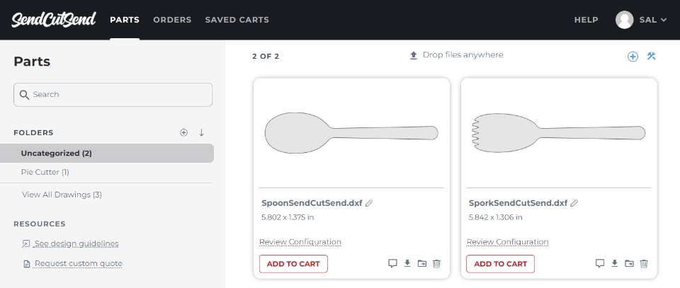

Then we sent DXF files of the flattened utensils to Send-Cut-Send (a service that will waterjet, laser cut, or CNC you designs).

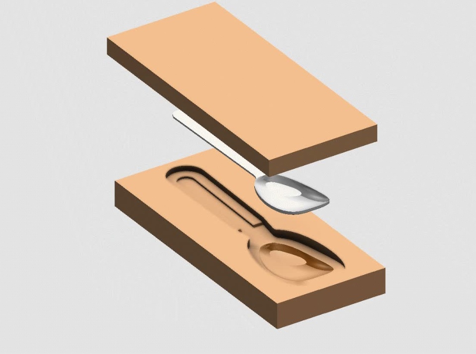

We used the geometry of the utensils to model a die block (the lower part of the 'mold'), and a punch (the upper part of the 'mold')

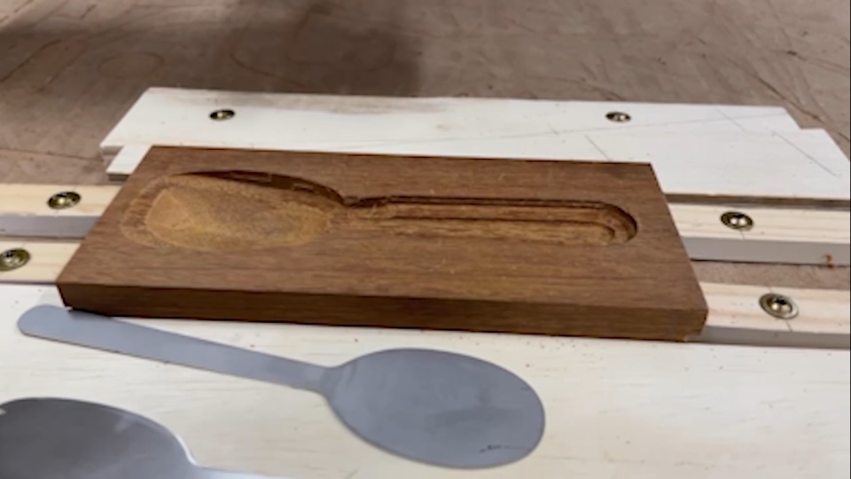

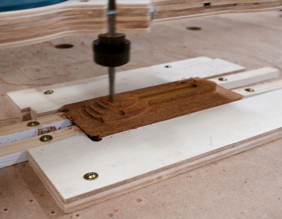

We CNC routed the die components out of two pieces of IPE (pronounced e-pay). This is an incredibly dense species of wood that we thought would hold up to the compressive forces the die would experience when we clamped it shut with a few pipe clamps.

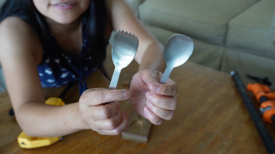

The die worked great, and we made spoons and sporks that we used on our annual family hike!
