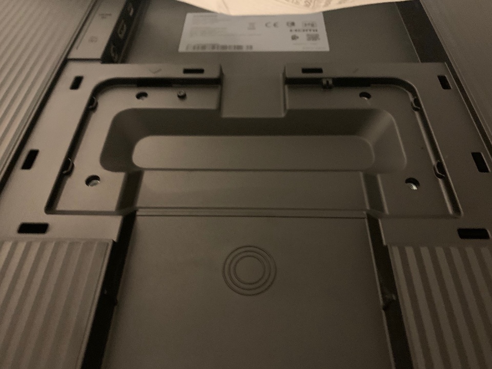

PC monitors have usually a 5 to 10 centimeters depths that would prevent to being able to mount them within such folding shelf desktop. So I had to found a PC monitor flat enough to stand within without any issue, including a 32" size and a 4K resolution. The Space Monitor by Samsung is perfect for that :
But it includes a desktop mount which is not compliant with VESA standard. This means that it cannot be mounted over a wall with standard VESA mounts (75x75mm, 100x100mm, 200x200mm)
The Screen Mount

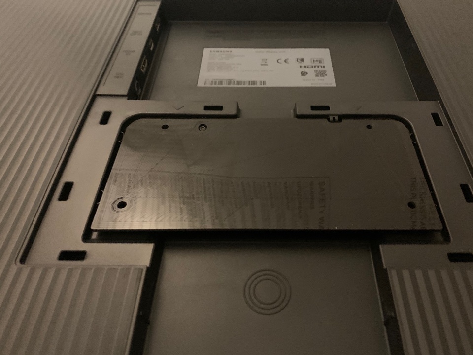

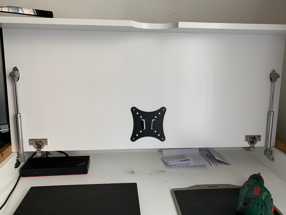

In order to solve this issue, I had to create a specific mount based on the original one in order to being able to attach a standard VESA mount behind the monitor.

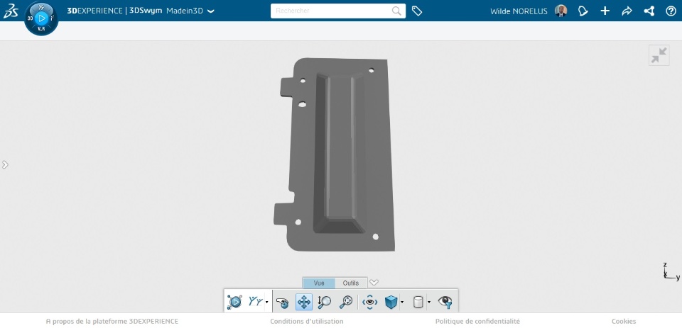

This part was designed in CATIA in order to flatten the back of the monitor and attach a standard VESA mount to it.

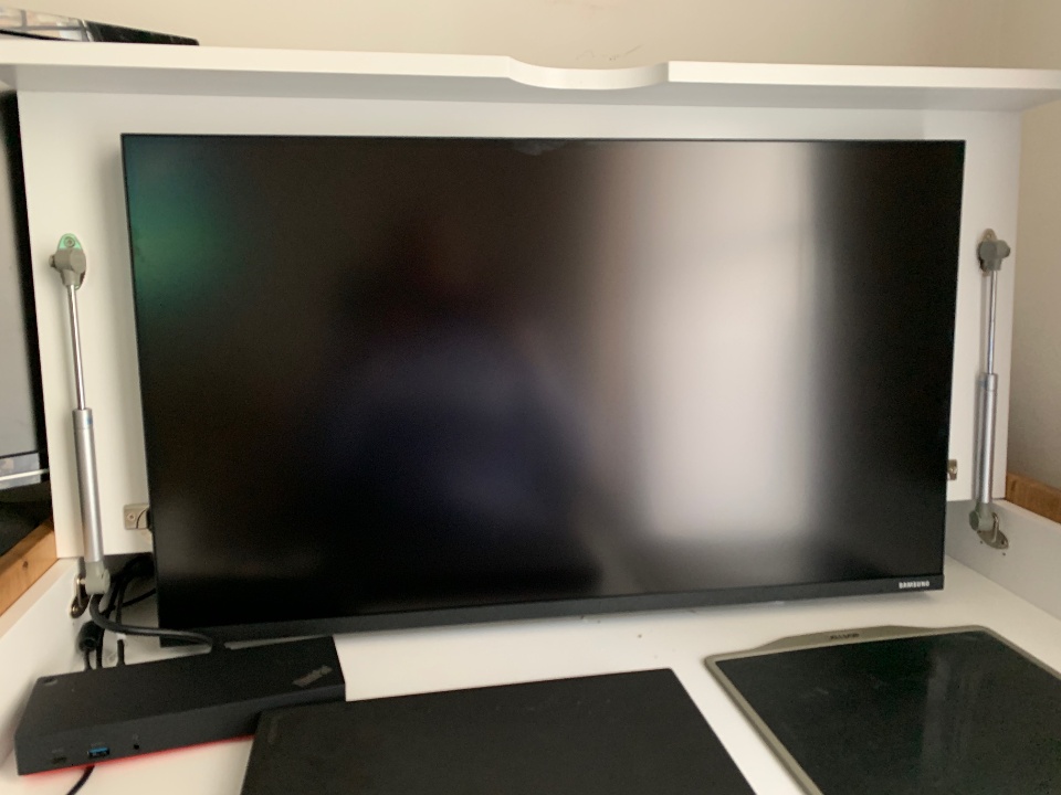

The End Result
After printing the part thanks to the MadeIn3D team, here are a few pictures showing the end result : it is perfect !
