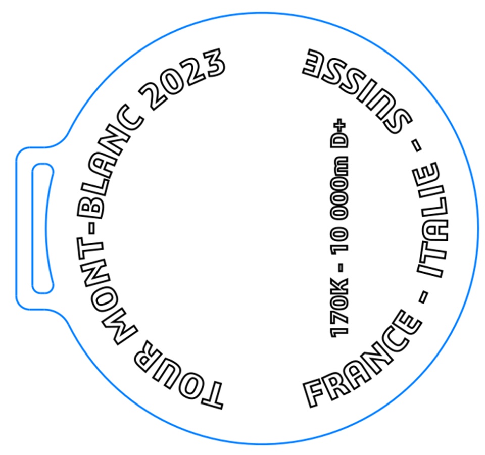

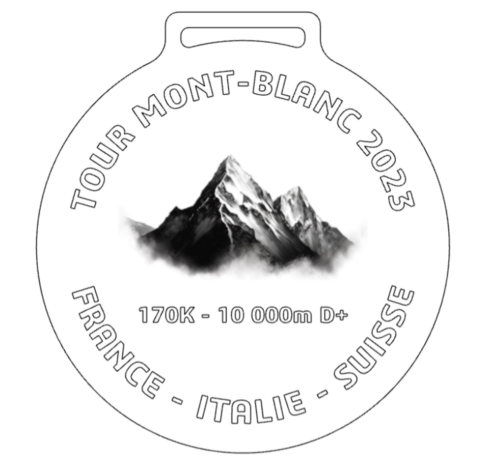

Managing the Fablab of the 3DEXPERIENCE Lab for my end-study internship, I decided to design and manufacture medals to keep a memory of our challenge. Thanks to the Part Design application, I realized a simple sketch. Drawing must be done to export design as svg file.
I reassure you, as for the mountain in the background, I just found a royalty-free image 😃

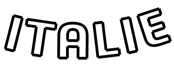

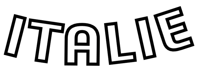

Then, using Inkscape, I connected the dots (for each corner 😵) to create closed profiles. Without this, the laser cutter software will not be able to engrave the script 😓
Opened Profiles
Closed Profiles

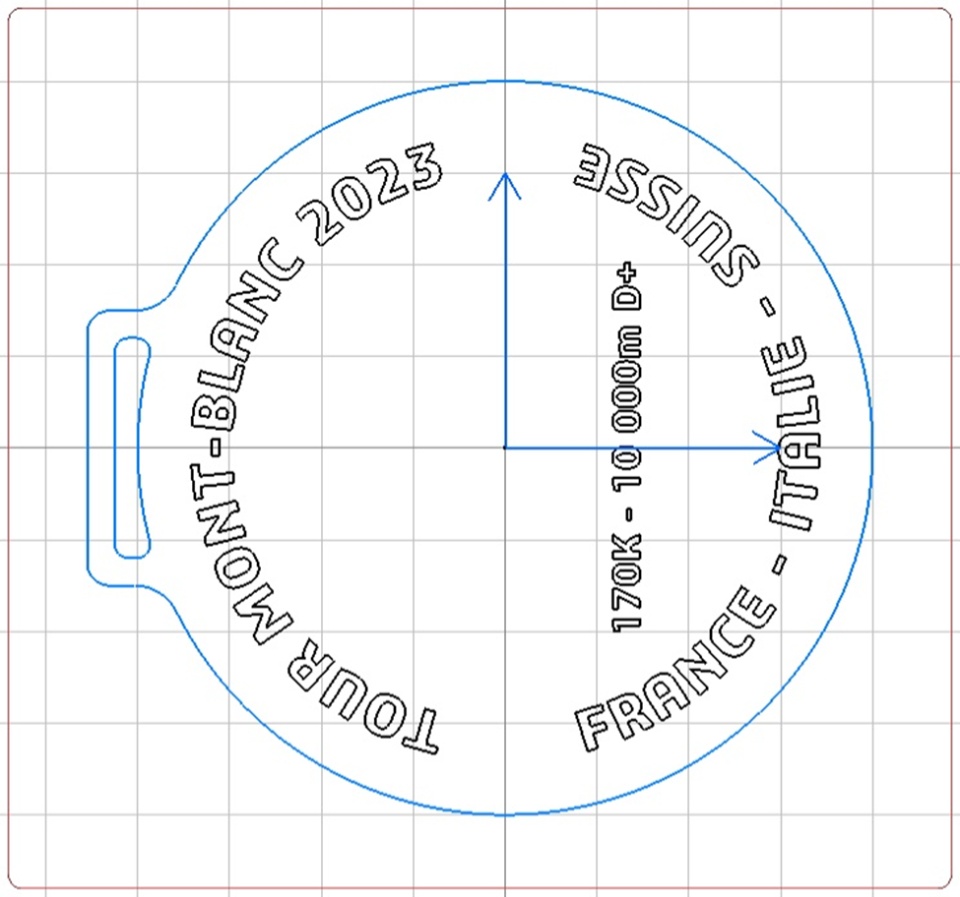

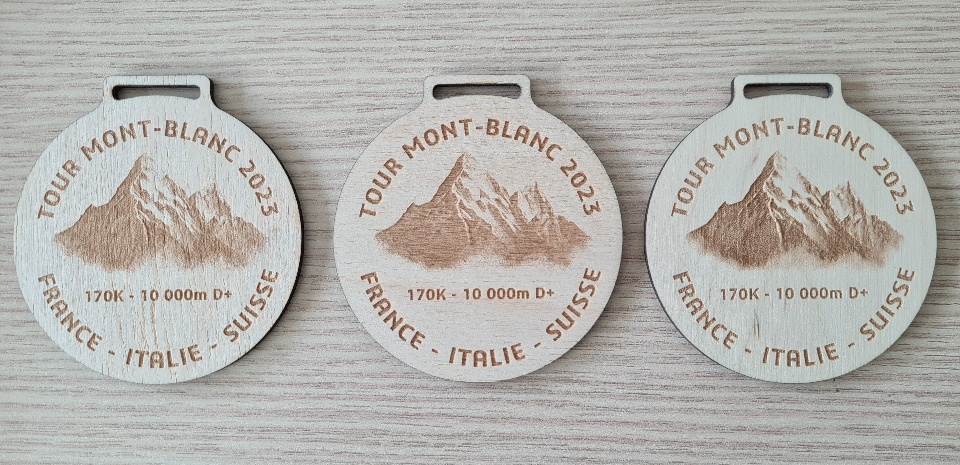

The final step was to make them using the Glowforge laser cutter. Below is the result... 🧐
