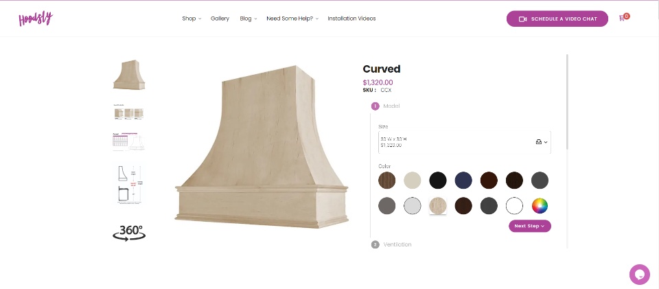

These hood covers are expensive and I knew could make one that fits our tall ceilings better and fits perfectly in our space.
