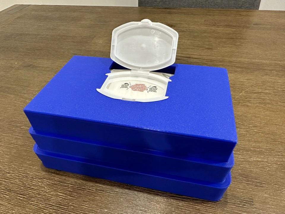

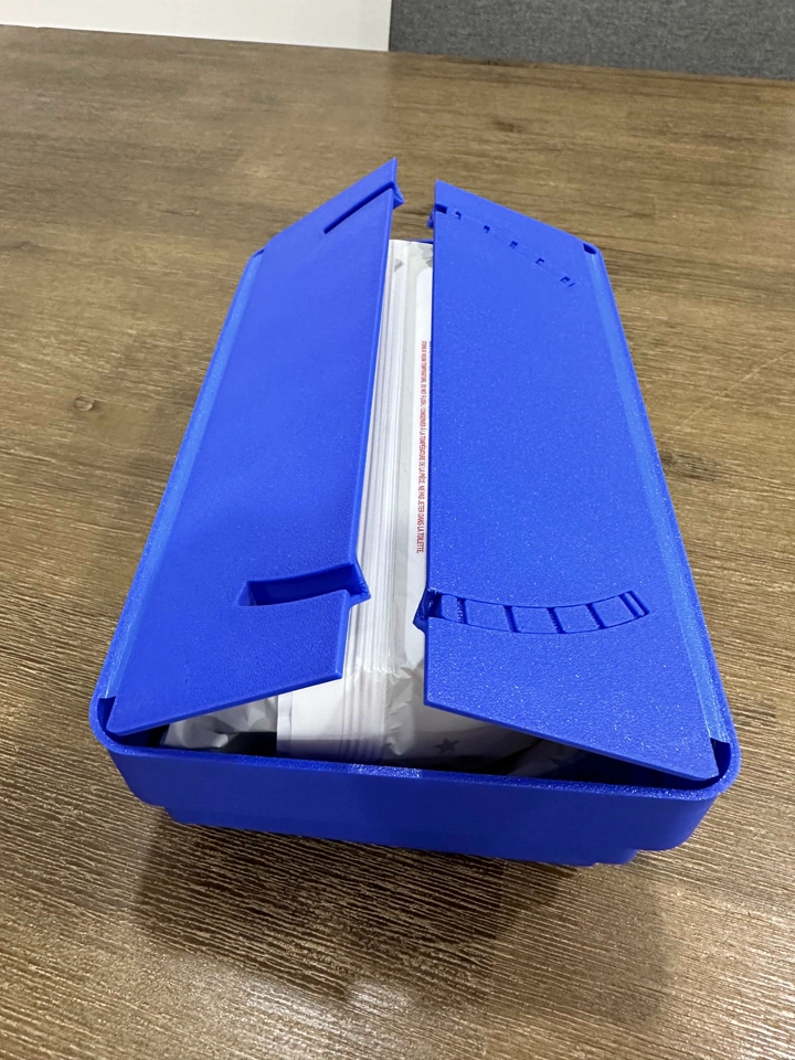

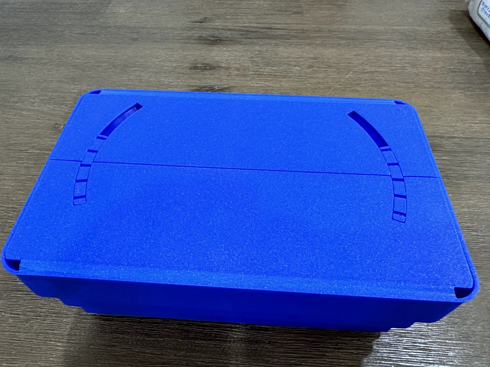

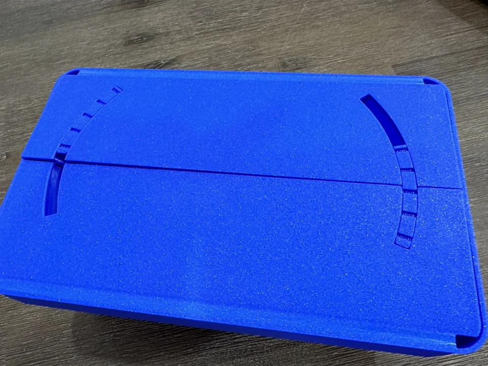

Collapsible Baby Wipes Holder (Kirkland)
Update: The holder was further improved. The top got a nice cosmetic lid.

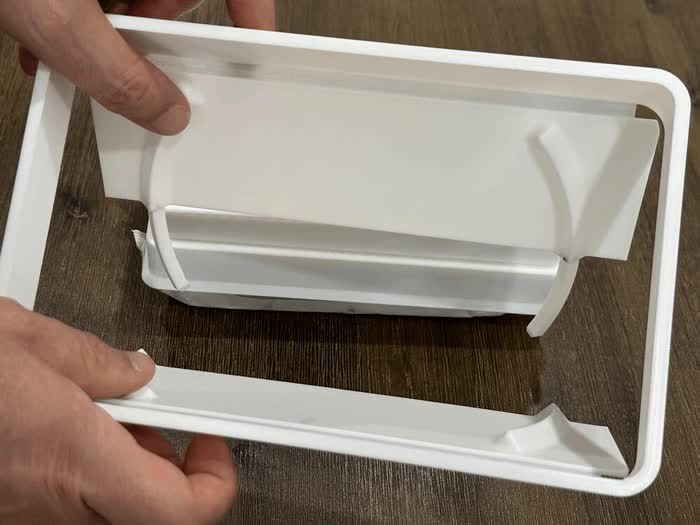

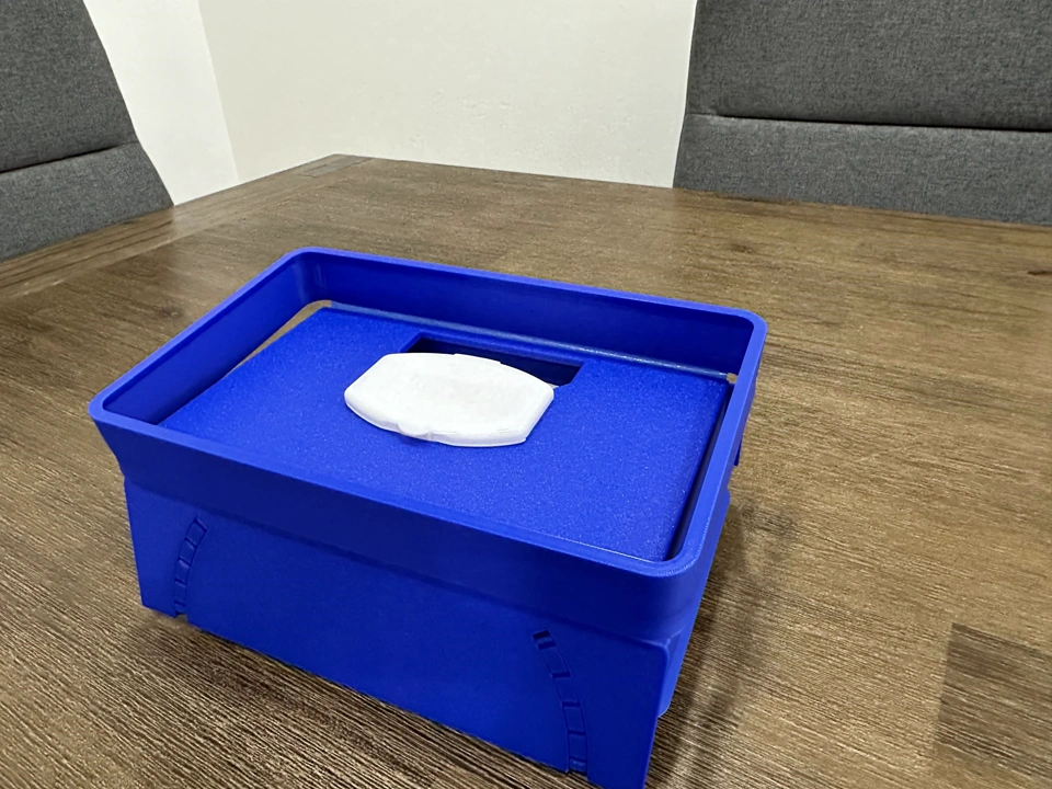

Do Baby Wipes require a telescopic holder? Yes, if the wipes come packaged in soft bags.
The holder need to collapse as the wipes are being used.

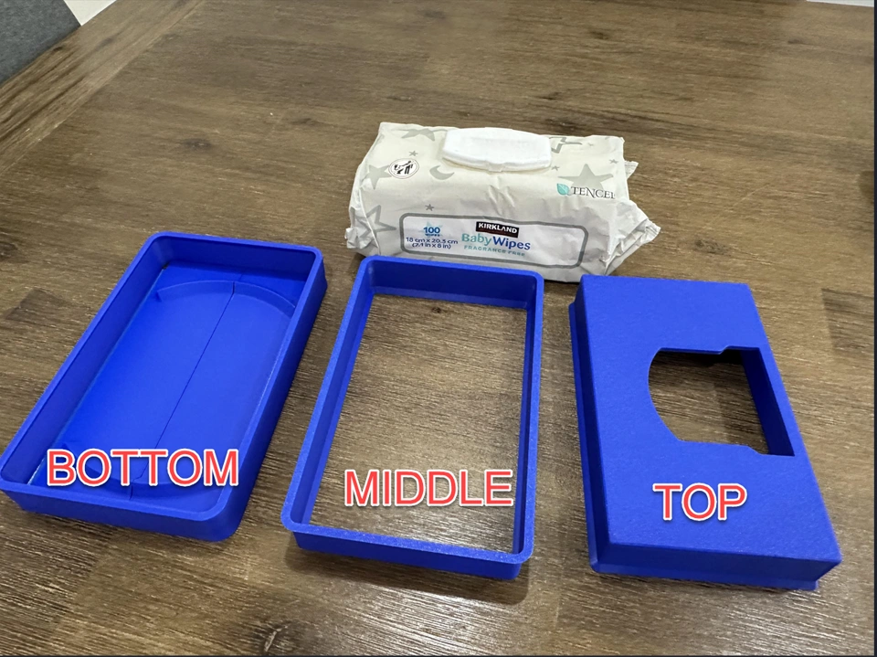

Instructions:

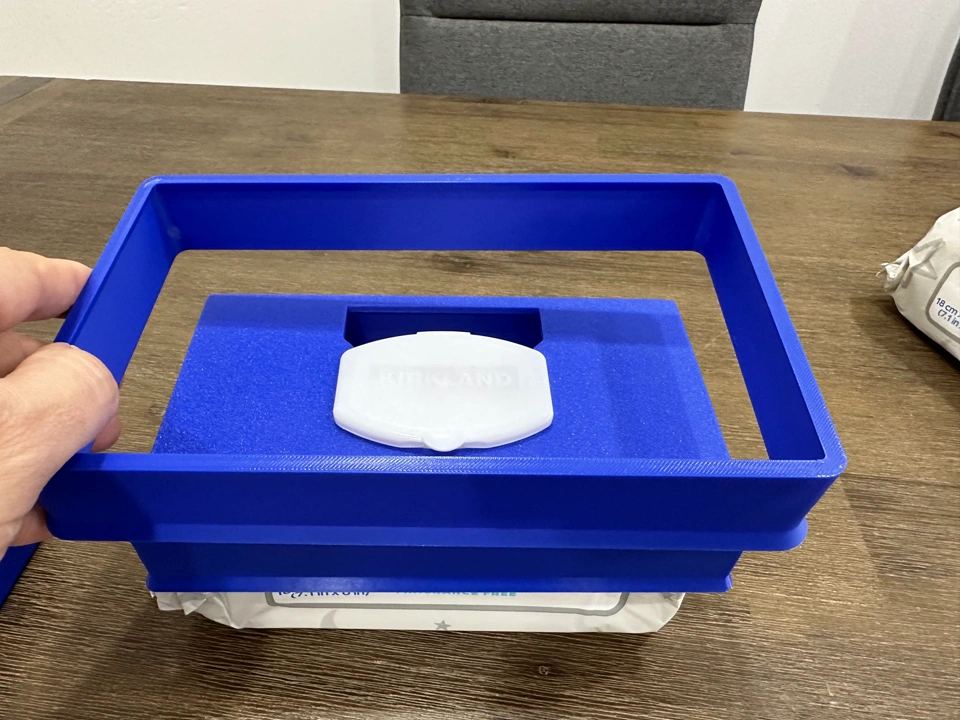

  1. Very important for Plate #1: if you want to move the model, make sure you move all objects on that plate simultaneously.
  2. Arrange the three main pieces as shown below:

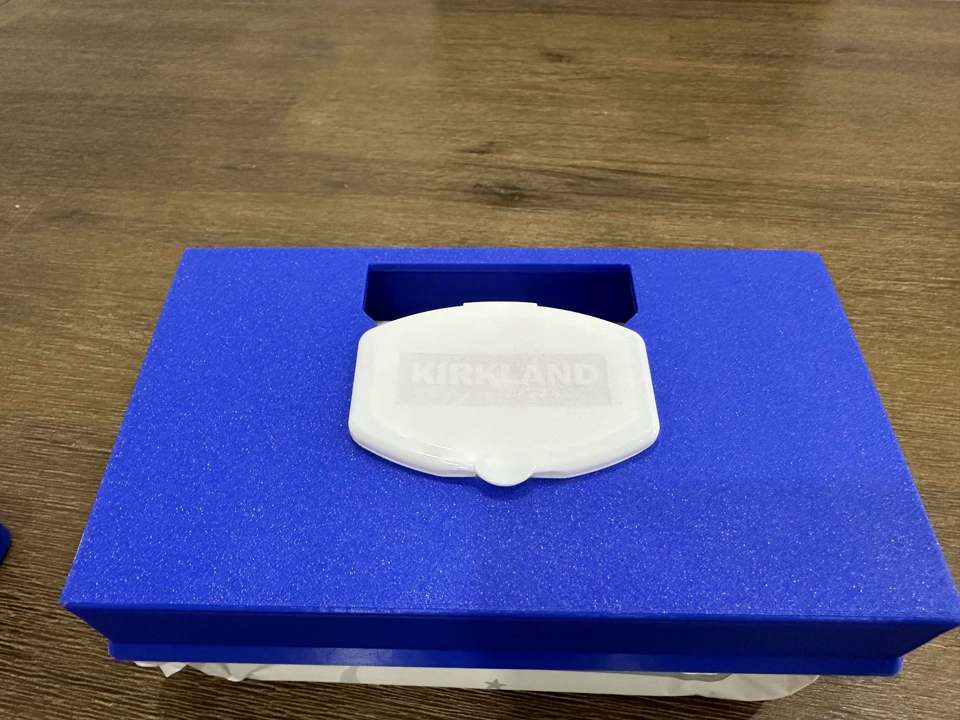

    3. Open the lid of the baby wipes package. Start inserting the package in the top opening as shown below.
    Make sure the two small front tabs are above the top.

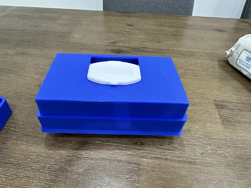

    4. As you slide the box in, pull up the lid to ensure the back two tabs are brought above the top surface.
    5. Slide it all the way to the front and close the lid.

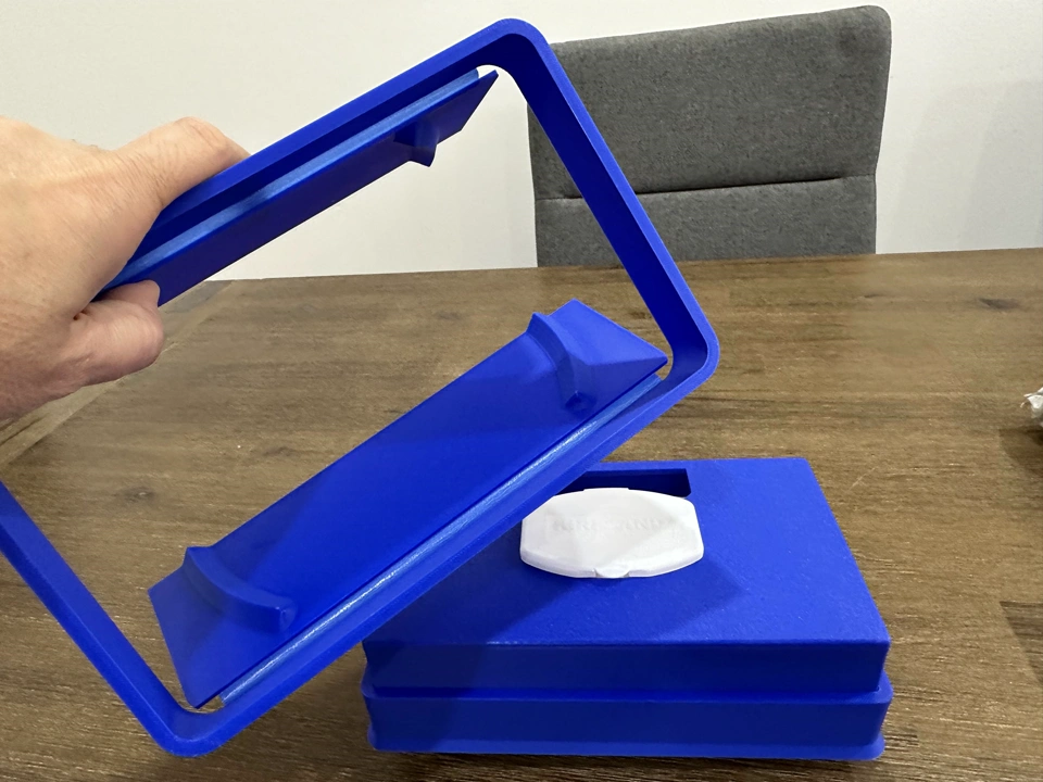

6. Insert the middle section. Simply slide it down over the top section.

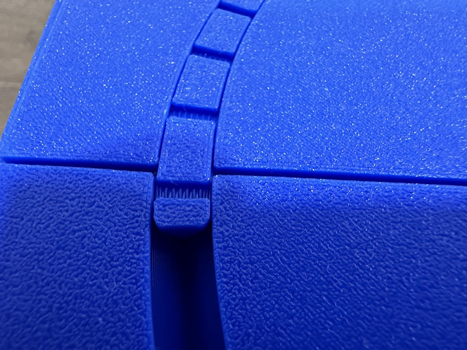

7. Open the bottom hinges and slide the lower section over the middle section.
8. Rotate the whole thing upside down.
9. Use the keepers to lock the bottom:

As they are used, the box will collapse gently, making sure that the next wipe is waiting for your fingers.
