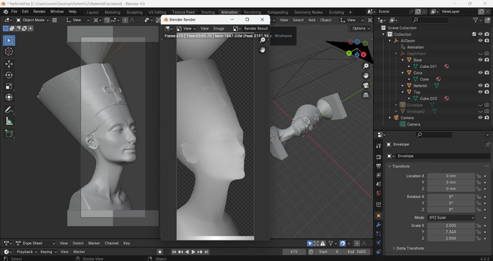

Blender can be used to generate such heightmaps:
above: using blender to generate heightmaps

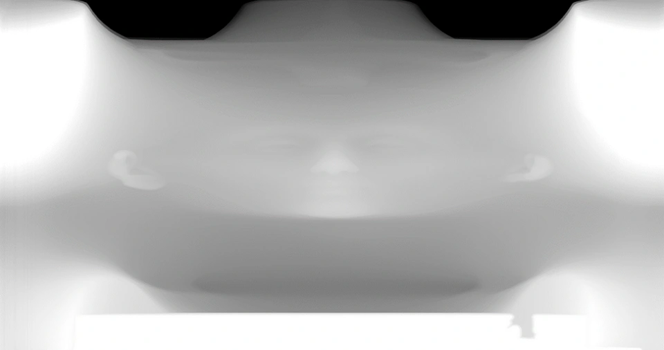

b/ Replace a translation axis by a rotation and work in a cylindrical space:
- Needs some adaptation on the hardware
- More complex computation of intersection between tool bit and surface to carve
+ No need to reposition piece to carve
= Some concave areas will still be unreachable
above: a cylindrical heightmap of the Nefertiti bust
Both these approaches can yield good results; they each have their specific difficulties.

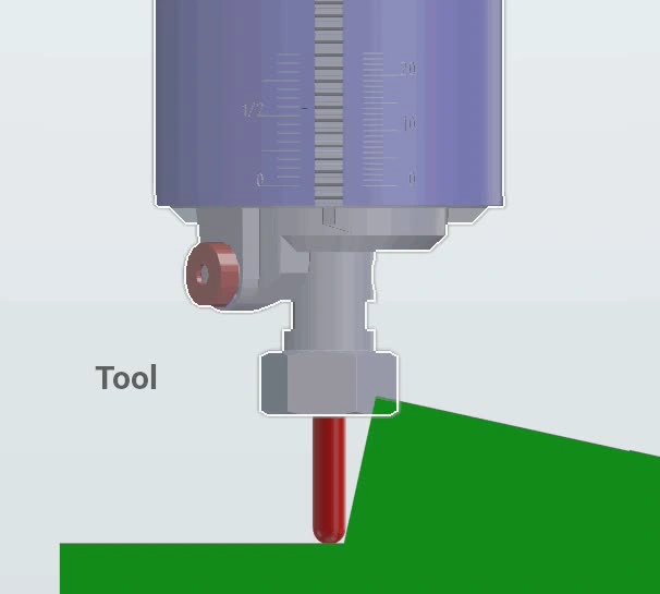

The shape of the tool bit must be taken into account to compute its intersection with the target surface.
The shape of the tool holding the bit should also be taken into account to avoid unwanted crashes of the tool into the carved surface while carving:
above: tool bit and tool intersection

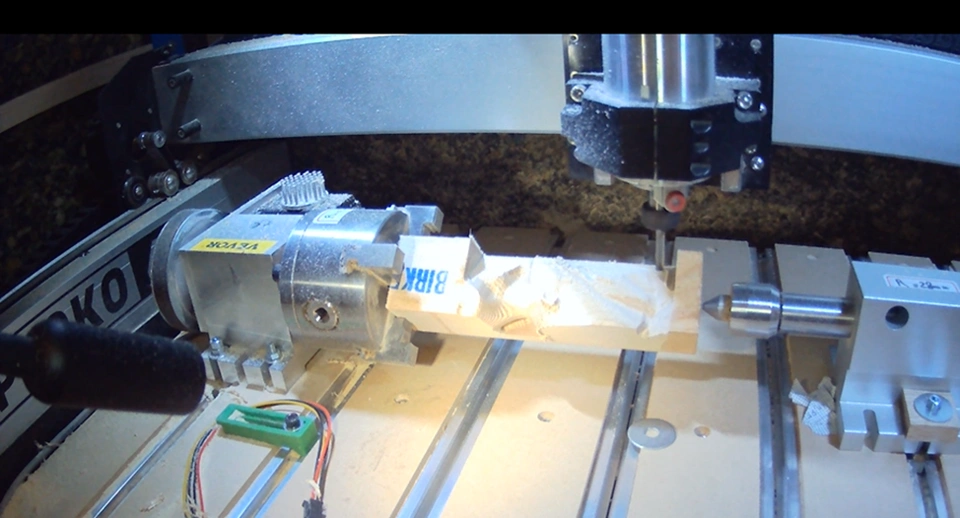

The setup I use is a shapeoko-4 with a rotation axis which can either be independently controlled (Cartesian mode) or replace the shapeoko’s Y axis (cylindrical mode).
On this particular test I generated 8 heightmap views of the model, at 45° angles.
  • I performed a 1st pass with a 6mm ballnose bit which takes roughly 30 minutes on 4 faces (front, back, left, right).
  • A 2nd pass with a 3mm ballnose bit to add some details in the areas that need it most, this takes another 30 minutes per face and was made only on 2 faces (45° left profile and 45° right profile).
  • A 3rd pass with a 1.5mm ballnose bit to add more details on the same faces.
  • => A total carving time of 4 hours.
  • The repositioning of the piece when changing the face on which I am carving is simplified by the use of an independently controlled rotation axis (the component labelled “vevor” in the picture above).

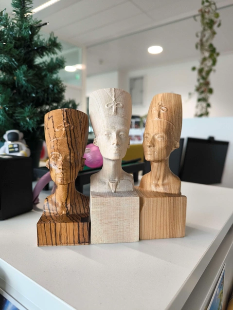

Here is the result with light sanding on the wooden surface on cherry, birch and Zebrano wood, on display at our open-space in Vélizy:
