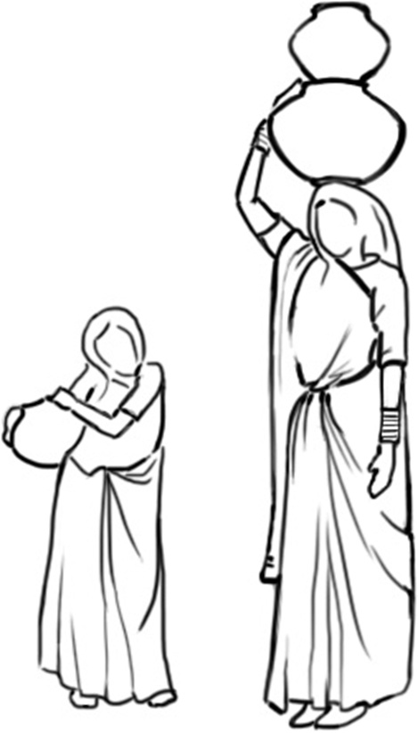

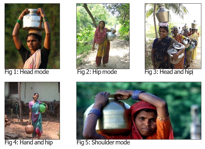

Rural : modes of carrying water filled Matkas
Learnings from Modes:

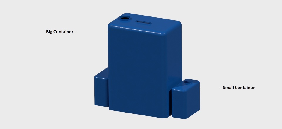

1. Should allow to carry 45 liters of water in 1-2 trips
2. Should reduce the effort required to fetch equal amount of water.
3. Should be carried ergonomically by one woman
4. Should allow easy loading and unloading of water
5. Should store water in a hygienic manner
6. Should minimize wastage of water on commute
7. Should be usable over different terrains of different villages.
8. Should allow easy pouring/transfer of water.
9. Easy to clean and maintain.

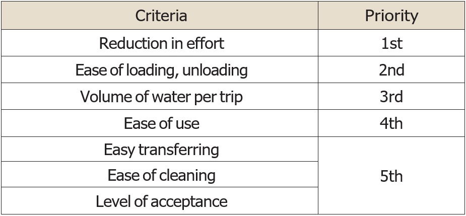

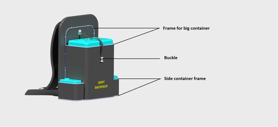

Concept Evaluation

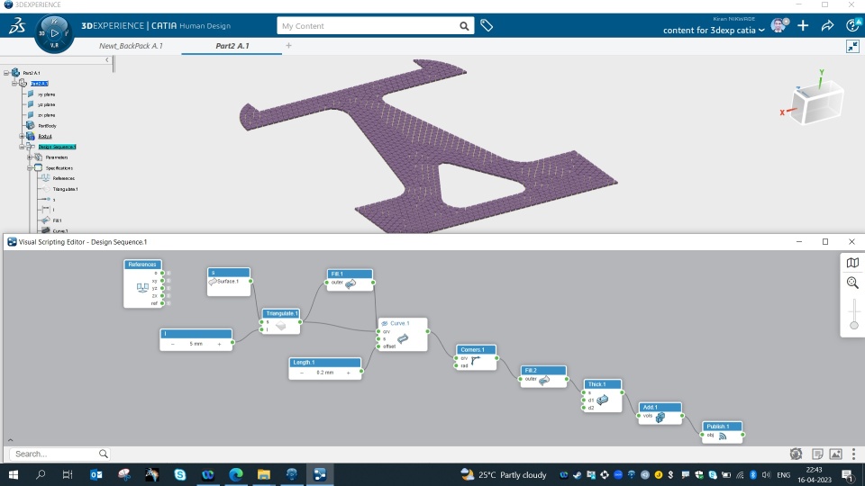

Design Method (Specification & Visual Script)

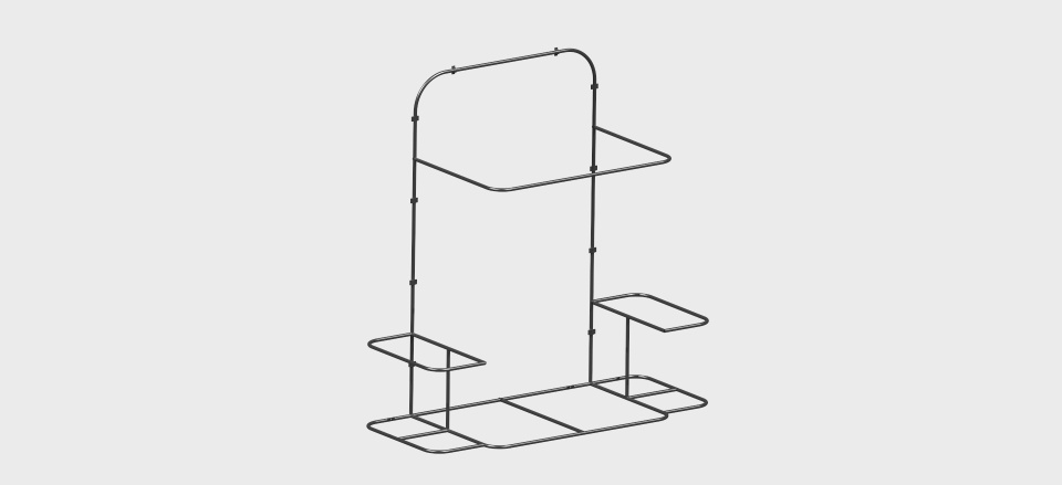

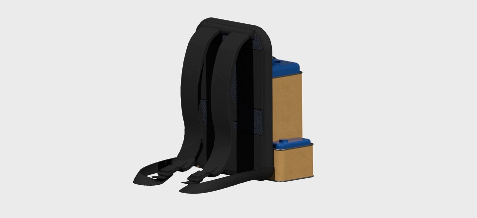

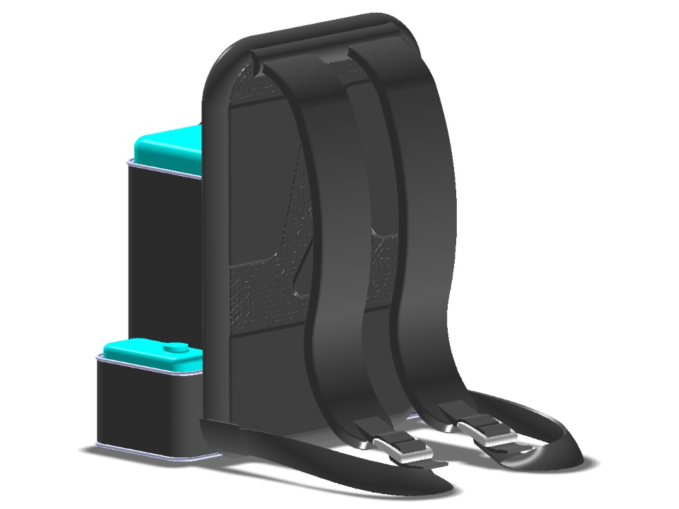

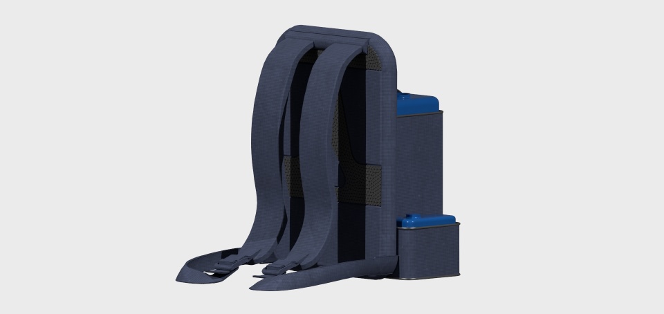

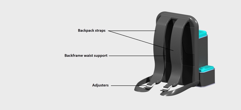

Full frame with support straps

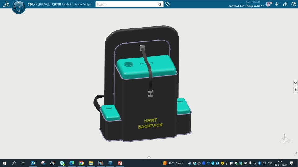

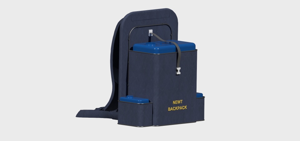

Container
Full Rendering
