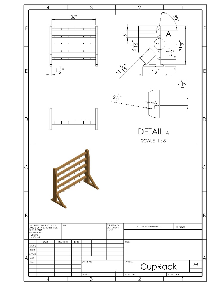

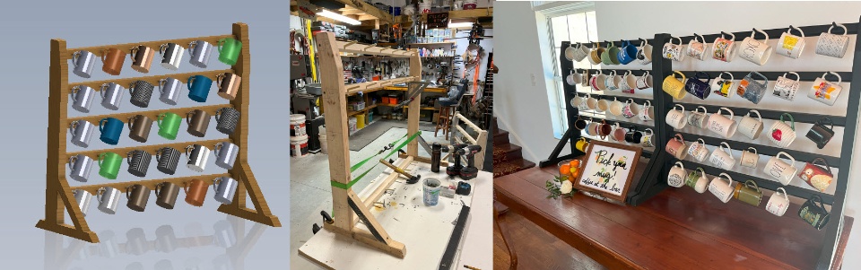

As a primary benefit of CAD, I shared some ideas on a simple design that basically was only needed for one day so kept the concept super simple! Decided to make the entire thing from scrap 2x4's (I ran them through a planer since it was for a wedding of course!) and 3/8 inch dowels. This effort showed a real value for tapping into 3D Content Central which provided me a coffee mug to size this thing as she wanted 60 mugs and what I built had to fit on a 6x3 foot table at the venue. Ended up building two 30 mug racks. Fun little 3-day project!
