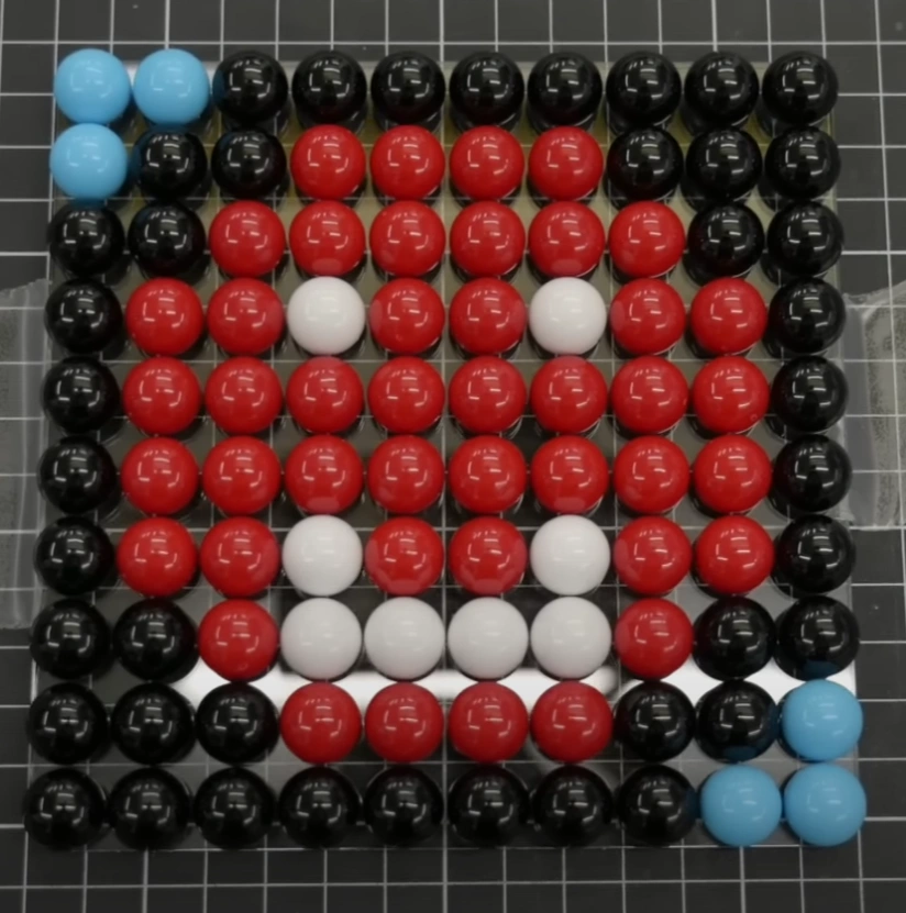

The Idea
It all started with a 10x10 grid of marbles arranged into a smiley face. I loved the aesthetic, but the resolution was… not great. So I thought, why not scale up to a 32x32 grid? That’s 1,024 marbles. Of course, manually placing each one was out of the question — which meant one thing: time to build a machine.

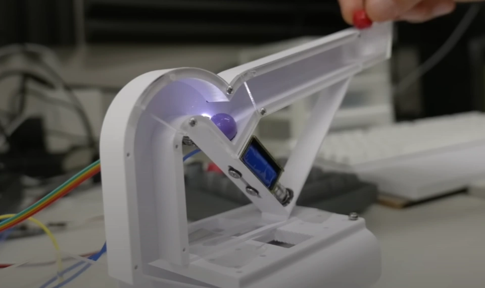

The core of the sorting system is a color sensor that reads RGB values and identifies marble colors using Euclidean color distance. I started with a setup that paused each marble in front of the sensor — more accurate than trying to detect color on the fly.
Initially, I tried DC motors and multiple sorting paddles, but that would've meant 14 motors and controllers for two sorting systems. No thanks. I pivoted to a single servo-based sorting mechanism — just one wire to control, fast enough (two marbles per second), and far easier to manage.

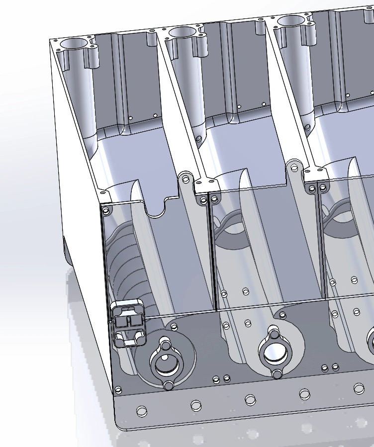

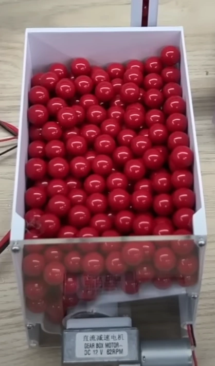

Phase 2: Marble Hoppers
Next, I needed a way to store and dispense marbles by color. My first paddle wheel design jammed constantly. Enter the Archimedes screw: not only did it dispense marbles reliably, but it also acted as a built-in agitator to prevent jams. Win-win.
Each hopper feeds marbles up a tube using a switch-based feedback system to count the correct number. Sure, it means pushing a whole column of marbles up a tube, but that visual payoff? Totally worth it.

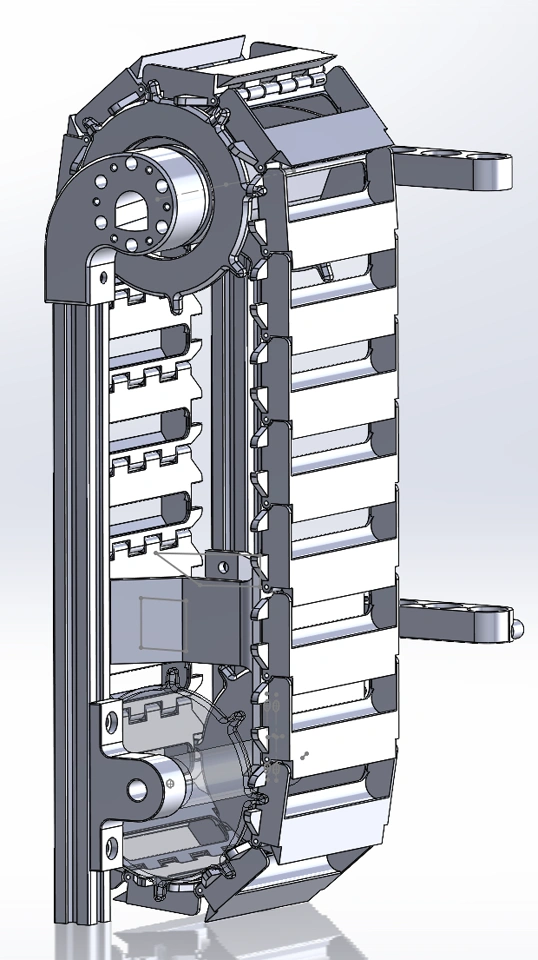

Phase 3: Lifting and Routing

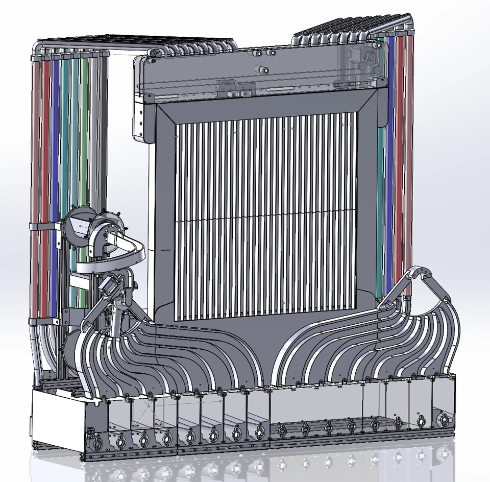

To return marbles from the bottom of the machine to the top, I toyed with vertical Archimedes screws — but gravity didn’t cooperate. I ended up designing a conveyor lift with a clever twist: instead of dropping marbles off the back, they fall through the center of the sprocket and into a chute. It’s compact, elegant, and it works.

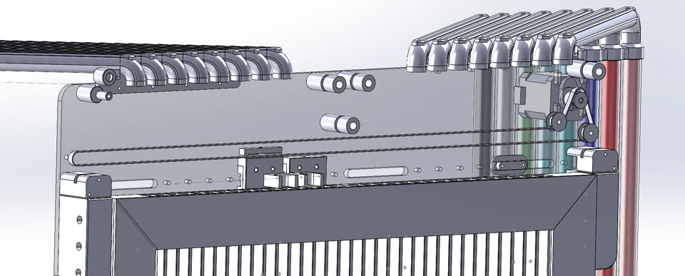

The Distribution System
Maybe my favorite part: a dual-slider ramp inspired by IDEX 3D printers. Using constant-force springs, the sliders guide marbles into the exact right columns. Watching it work is super satisfying — until I realized my slider rails were off by 1mm, causing jams. Cue another full rebuild.

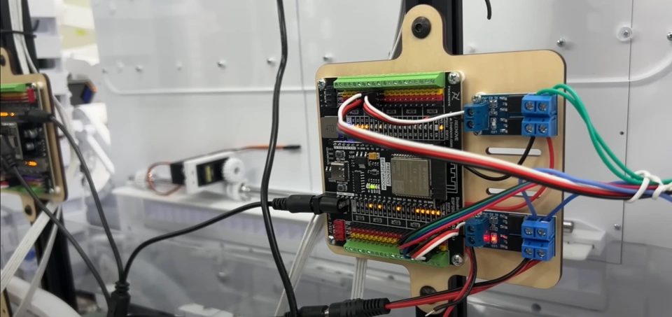

The Control System
At the heart of it all are five ESP32 microcontrollers — managing the hoppers, sorting systems, and sliders — all coordinated by a master controller that turns images into mechanical instructions. Everything speaks over ESP-NOW for fast, wireless communication.
