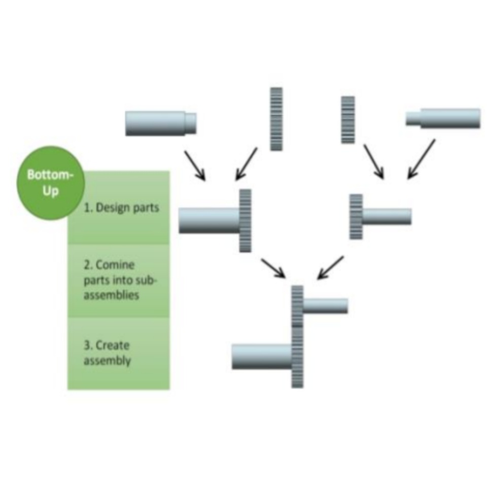

Bottom-Up approach
The bottom-up approach in 3D modeling is a widely used and traditional method, constituting 80% of 3D CAD models. It involves designing individual elements separately and then assembling them, mimicking real manufacturing processes. This approach is suitable for modeling standard parts or redesigning assemblies, focusing on each component and how they come together.

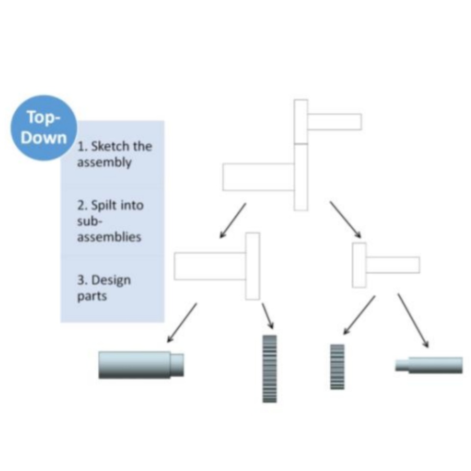

Top-Down approach
On the other hand, the top-down approach involves planning and designing models starting from the main assembly and breaking it down into minor parts. It works at a "macro" level, from a general view to specific details. This method requires careful planning before modeling begins, with the central structure controlling the entire assembly. The use of a skeleton, often represented as a sketch, helps manage internal elements.

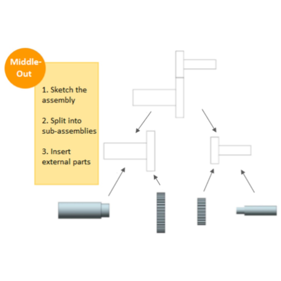

Middle-Out approach
In between these two methods, the middle-out approach combines features of both bottom-up and top-down. It involves planning and conceptualizing before modeling, but some parts may be imported from a library or previous models. This approach is particularly useful when an existing structure needs alterations or improvements, and it allows modifications within the assembly environment.
Each approach has its advantages and disadvantages, and the choice depends on the specific requirements of the project and the stage of development.
