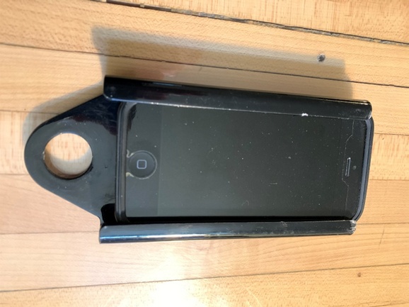

About a decade ago I wanted something to attach my phone to my bicycle for tracking my rides/accessing maps/listening to music/etc.
Since I worked in a metal fabrication shop, I cut a piece of aluminum, gave it a few bends, and powder coated it.
The holder was attached using the headset cap, locking it securely in place.
This was designed to fit the phone/case combination that I was using at the time, so I needed to make something new when I upgraded my phone.

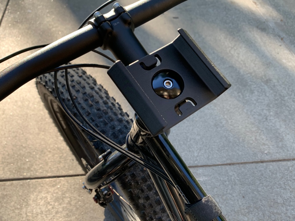

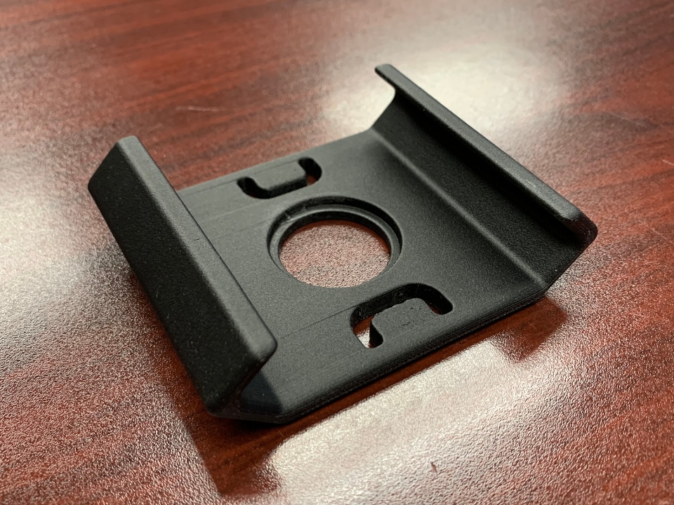

Our local Markforged reseller (ExBuild) was planning an event and requested "sample parts" to demonstrate their printers.
I decided it was time to redesign my phone mount.
The next version would be centered on the headset cap and designed for 3D printing.
They thought it was a good idea and printed one for me.
It was also used in their demonstrations.
I really liked the way that it blended in with my bike.
This design worked great if the stem was rather “flat,” but if there was any angle/rise to the stem, it would interfere with the holder.

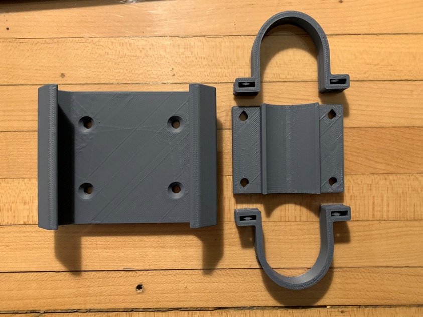

I decided to keep the same mount design but move it to the top tube of the bike.
Simple enough, just make some clamps that wrap around the tube – this was when I realized that the top tube was oval – which makes the mount less likely to “spin” on the tube - Bonus!
These are the parts for the new mount – NO supports were required when printing, and the small square ‘slots’ on the u-shaped pieces are sized for hex nuts – the whole assembly can be put together with a single hex key.

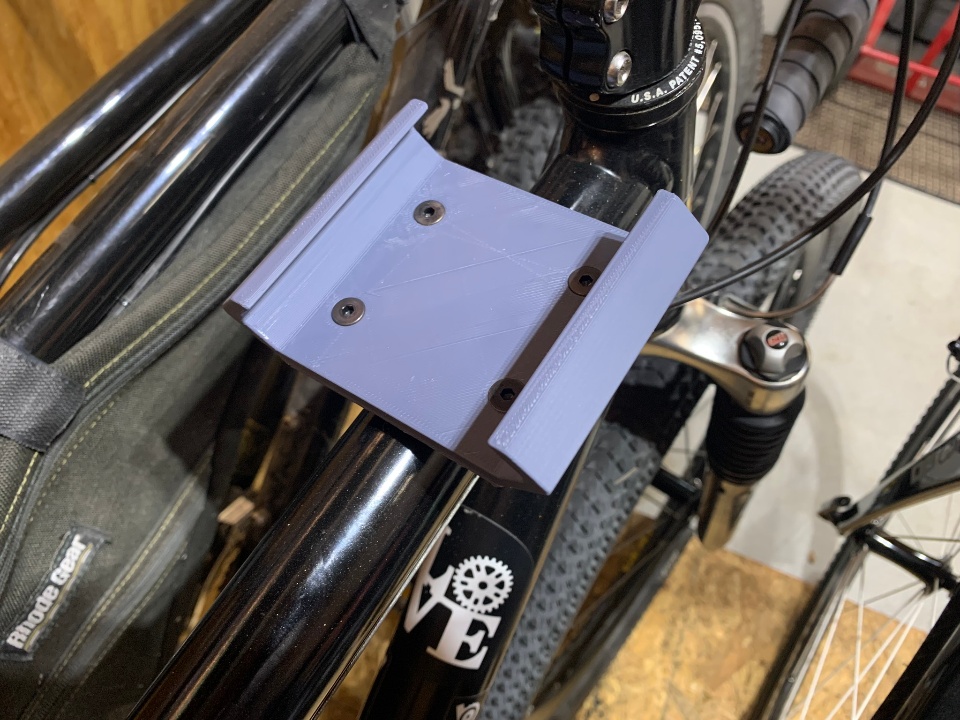

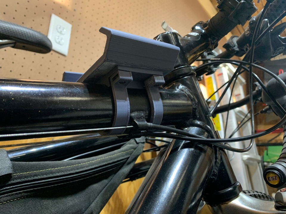

Here it is installed on the bike –
This was designed in SOLIDWORKS Connected and printed with ABS on a Sindoh 3DWOX1 printer.
(I prefer PLA, but I had some ABS leftover that I wanted to use.)

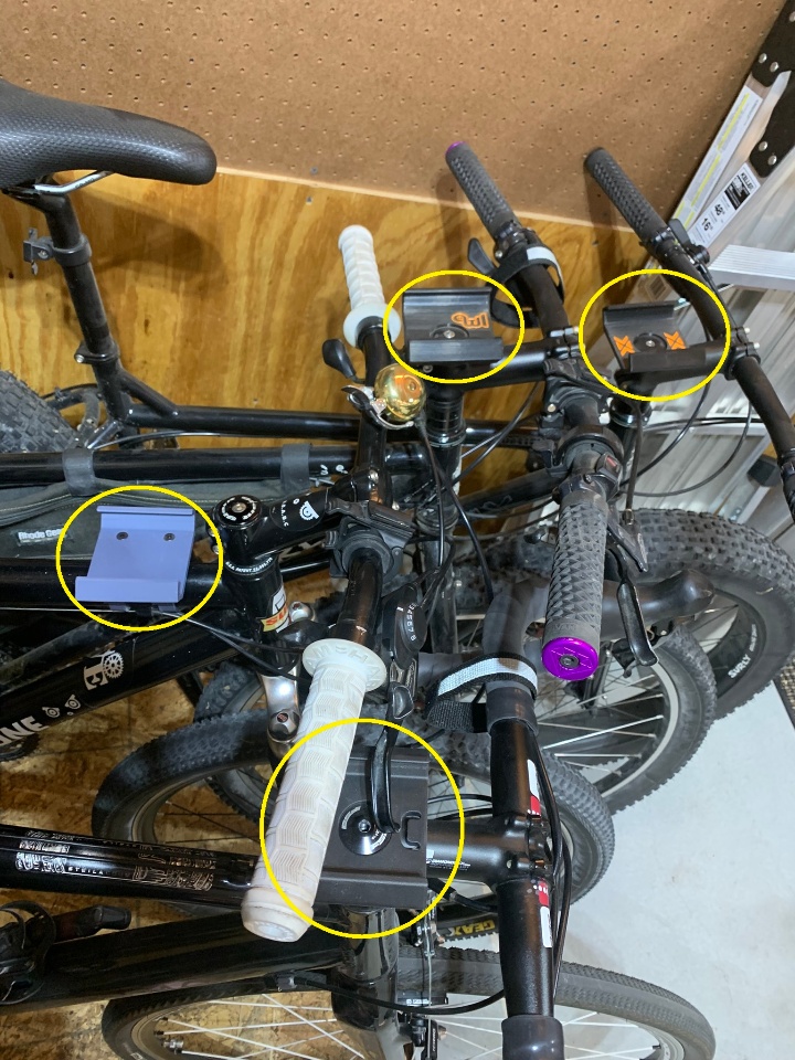

And yes, I have them on all my “geared” bikes –
