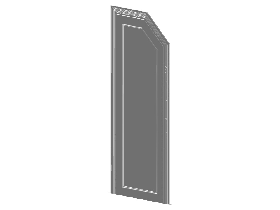

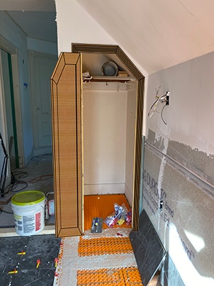

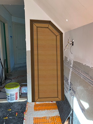

I'm working on my first cabinet door project and so despite my nature, I'm taking the time to do a proper mockup. It's a rather funky corner pitch so I wasn't sure how the trim would look so I benefitted a lot from this exercise. I don't think the trim looks too out of the ordinary but let me know if I should do it another way!
Still need to add the tabs in between the stiles and rails and of course measure my opening twice. I probably should have made my stiles and rails profiles and then extruded them but I pretty much made this up as I went along. And isn't that what mockups are for?! Side note, is it a stile or a rail when it's on a diagonal?
