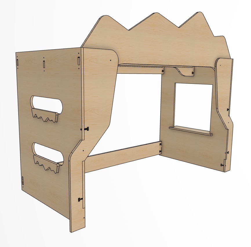

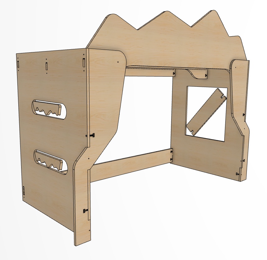

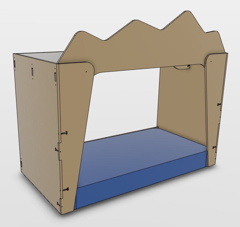

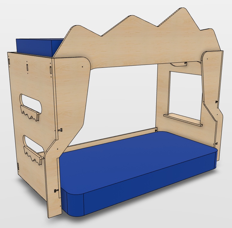

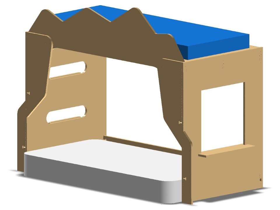

My initial design was compact, with tapered legs in the front. It looked like this:Once I received Max's measurements, though, I learned that the lower mattress would cover a floor vent, so the mattress would have to be pulled out away from the wall 9". I considered making the whole bunk longer so the mattress would clear the tapered legs, but instead opted to push the lower portion of the legs to the outside. This made for an unconventional shape, but one the I felt still matched the overall 'mountain' aesthetic that I was going for.

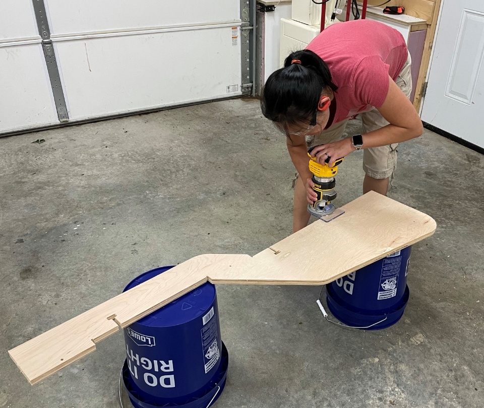

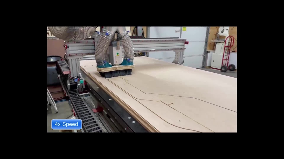

Since I was short on time, I opted for a plywood construction that I could bang out on the CNC. It took three sheets in total.

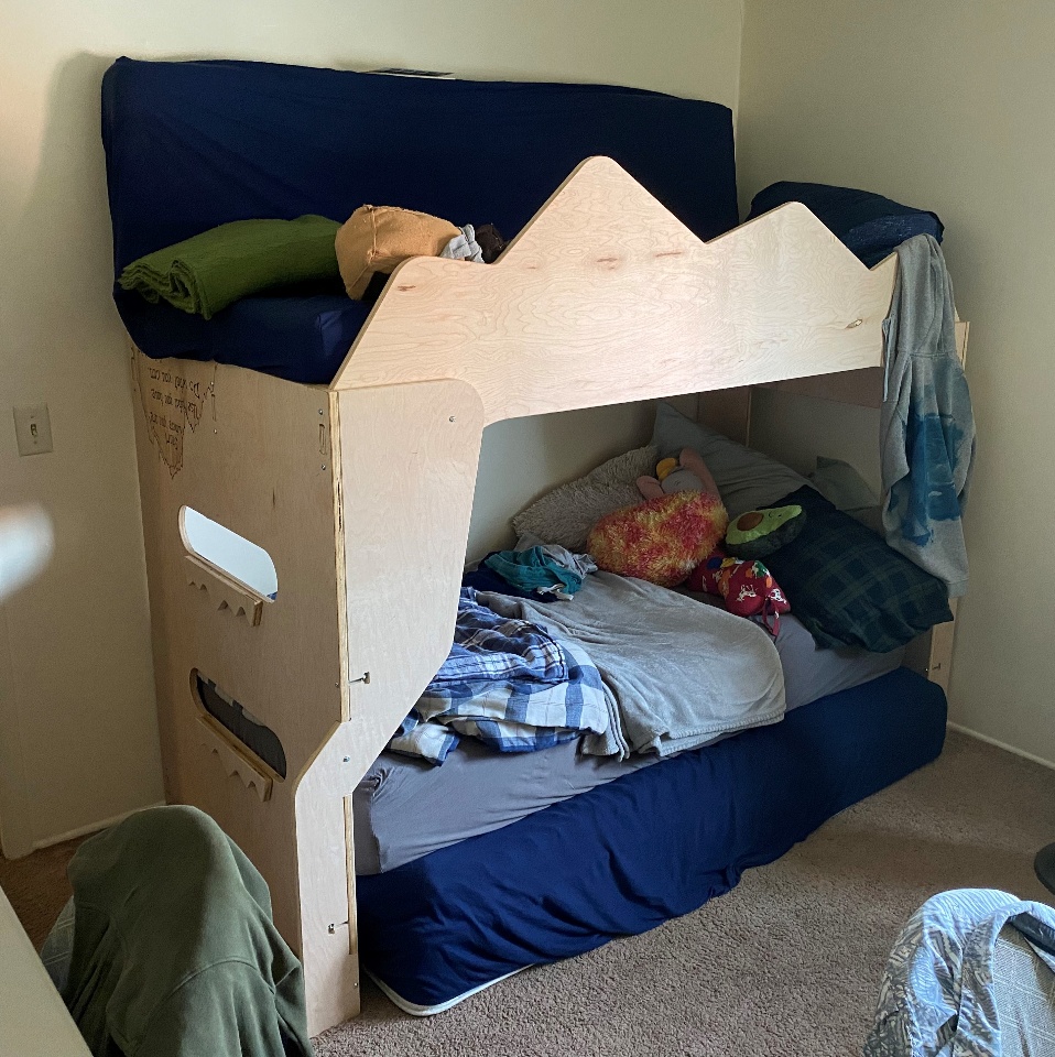

Overall, I'm quite happy with the result, and more importantly, Max and his roommate are thrilled! Mission accomplished :)

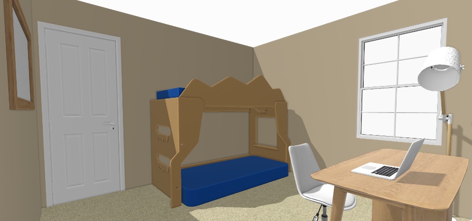

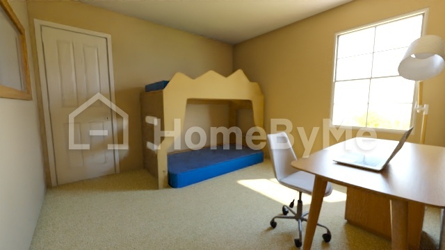

...By the way, if you haven't checked out HomeByMe, I highly recommend creating a free account. It allowed me to layout Max's bedroom and see my custom bunkbed in situ. It also created this amazing rendering with next to zero effort on my part.
